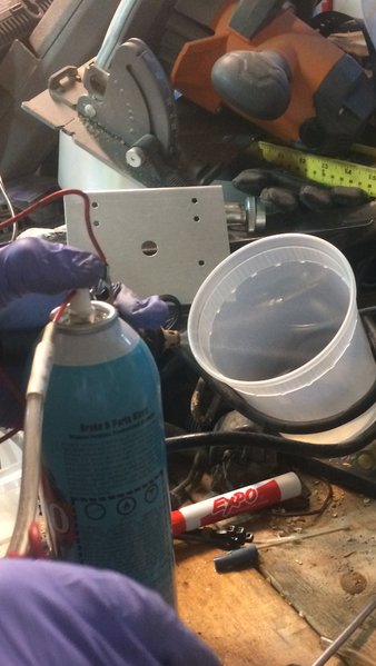

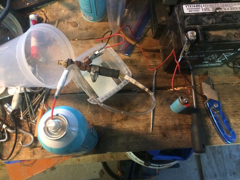

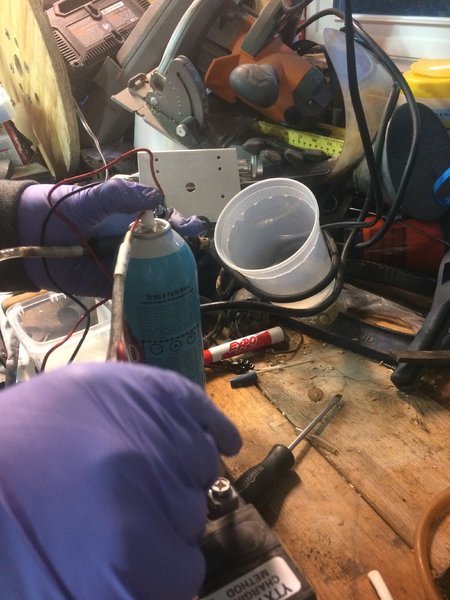

    After cleaning them no real dirt or water appeared in the bucket catching the spray. Things I noticed, there was one o ring that has a chunk out of it, the one that came out of #3 problem cylinder was clacking, I cleaned it and it quit working, gave it a few taps on the bench and it's clacking again.
    Looking back on this I should of done this outside due to safety concerns.
    I think I am going to test them again before putting them in
    Questions
    Should I put them back where they came from or change them around ?
    Manifold gasket ... ultra copper to reseal or any other tricks

    Replace the injectors, and you should probably of done the leak down test first... I'm guesssing it's a cracked head or cylinder or block something's not right and it's not the fuel system I don't think

    I wouldn't replace quite yet. Especially since you went through the work of cleaning them. Replace the funky o-ring and get them back in. Then let's see the test results. Nice job on the injector clean up. I'm excited to try that cleaning method next time I'm dealing with a possible injector issue.

    Put that injector were you can get it out without pulling the manifold upper. You can still run leakdown with intake off. Just disable the fuel pump.

    Match up o ring the put injectors back into motor and preform leak down test. With fuel filter disconnected and pumping fuel from tank into can

    then take box off to take sending unit out to get the rest of the fuel water mix out reassemble and party like its 1999
    I am convinced it was water in the fuel rail ...... but i bought the leak down tester so i got to give it a try ...
