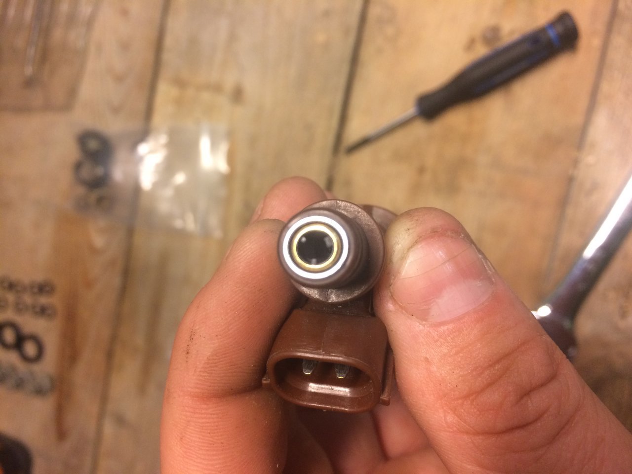

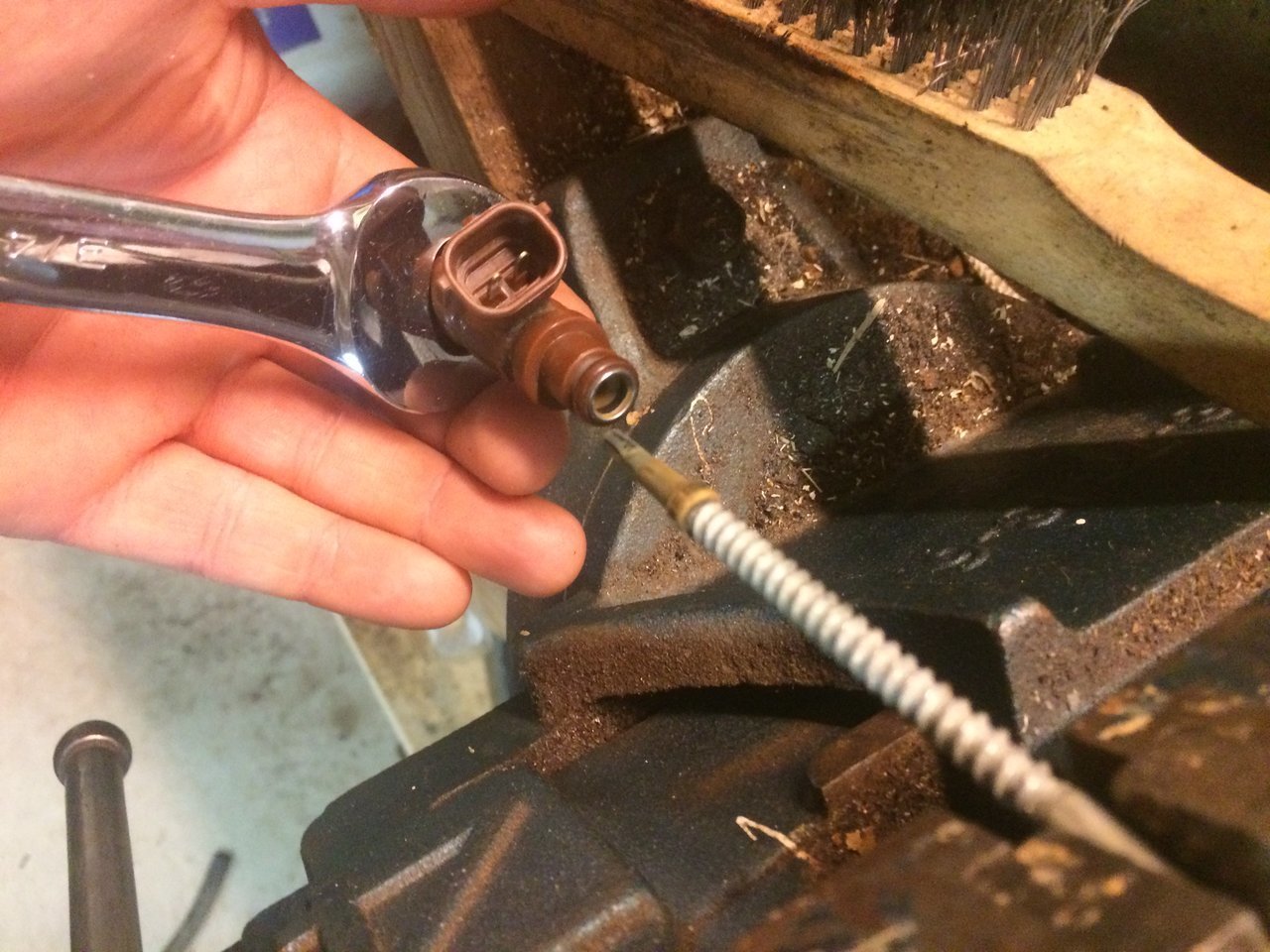

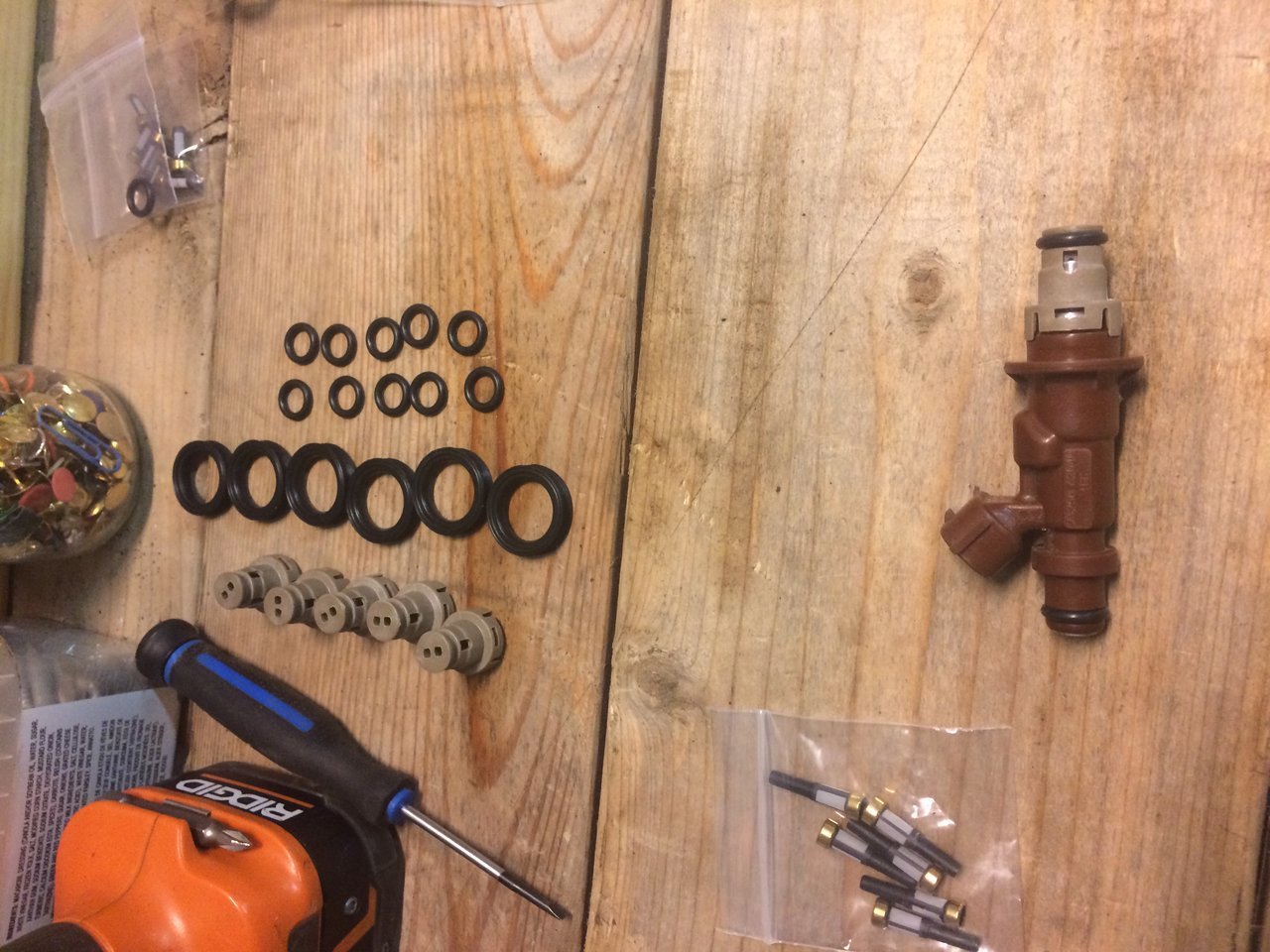

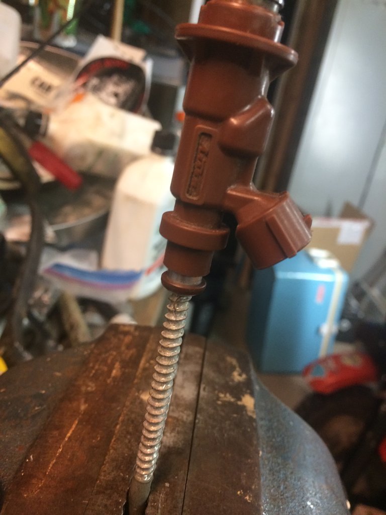

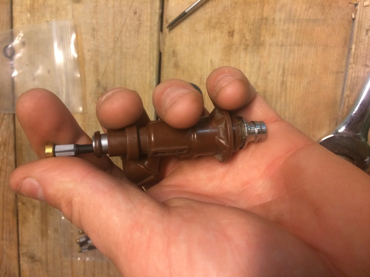

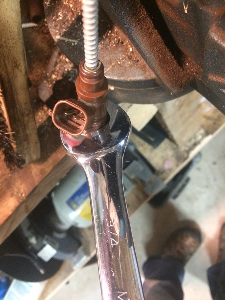

    Soooo I made my cleaning attachment awhile ago to be able to spray brake cleaner through the injector while supplying power to it. I was going to put them back in the decided to put new o rings on them as I did not want this to leak. This is only my parts / cabin / maybe plow truck but I still want it to be dependable.

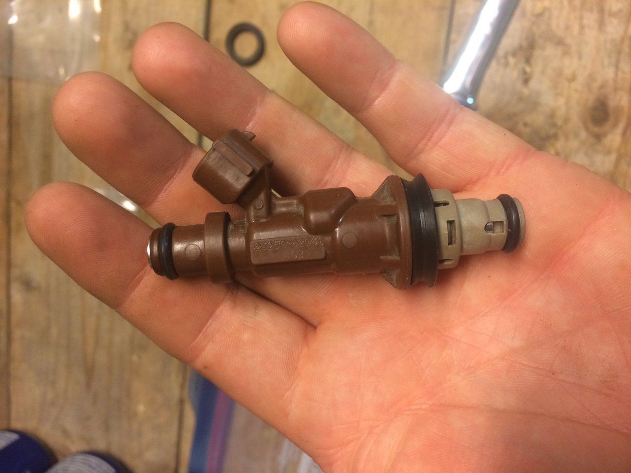

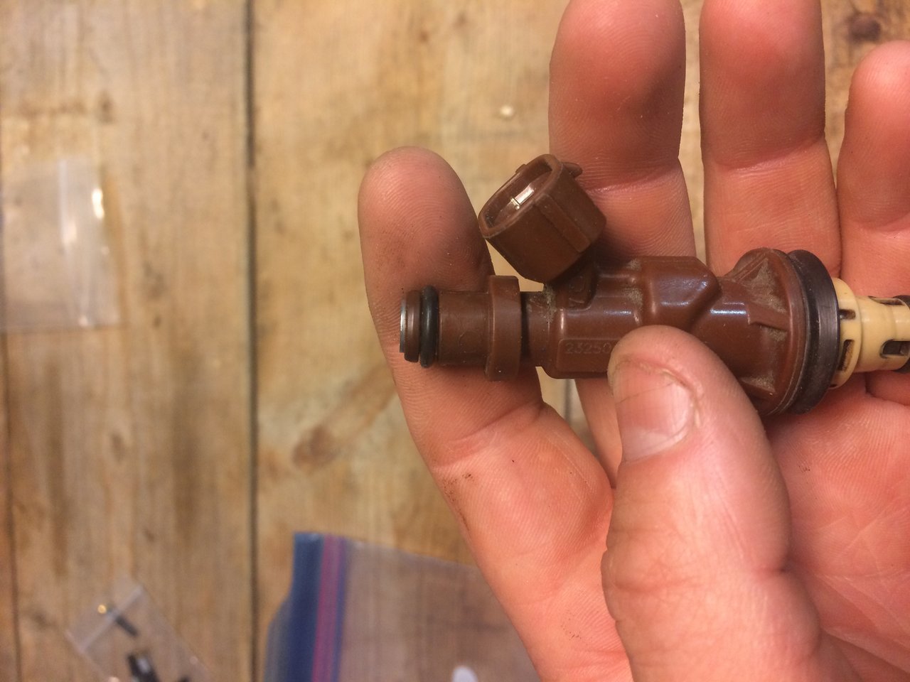

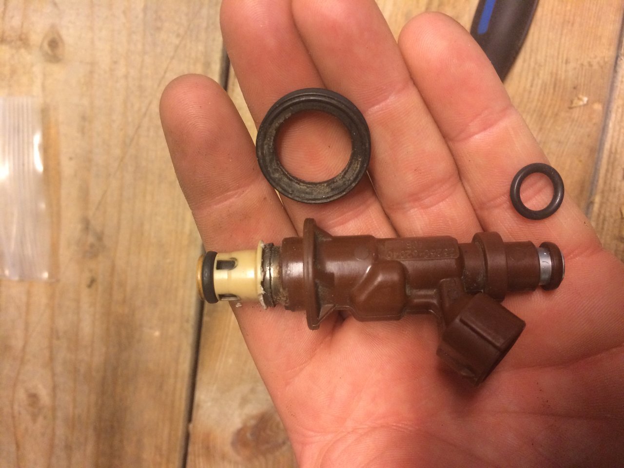

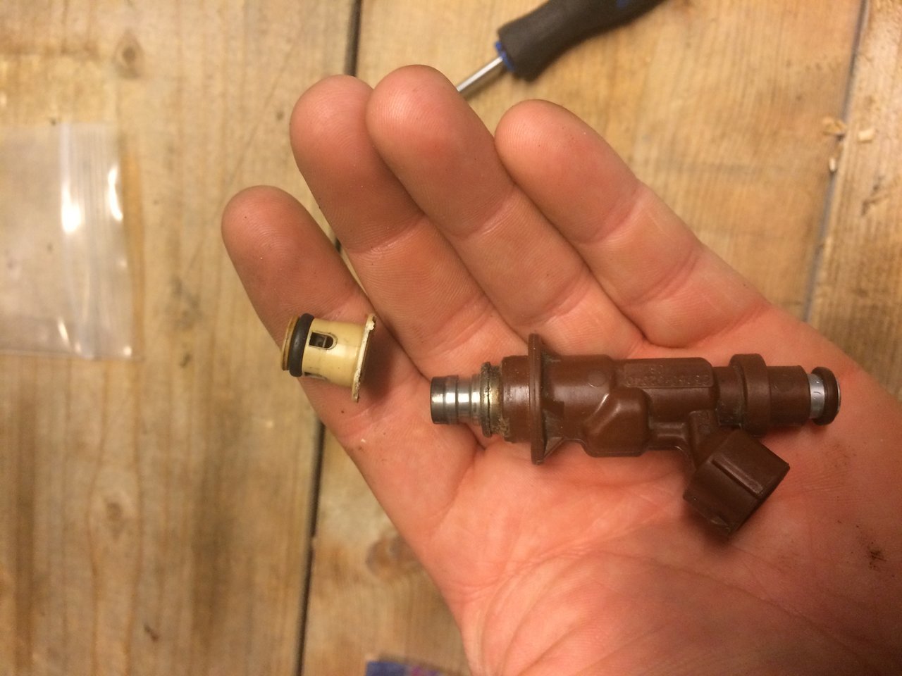

    So I had each injector in a bag with them labeled as to what cylinder they belong to. I did one at a time removed the top o ring and nozzle everyone broke. The with a big screw in the vice I screwed the filter part on to it flipped it around and put a wrench around the base and gave a tap with the hammer. Install of new filter was easy, top and bottom o rings and new nozzle back in bag and drink a beer and repeat

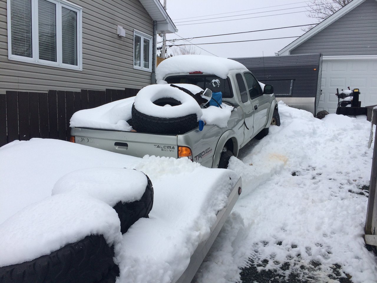

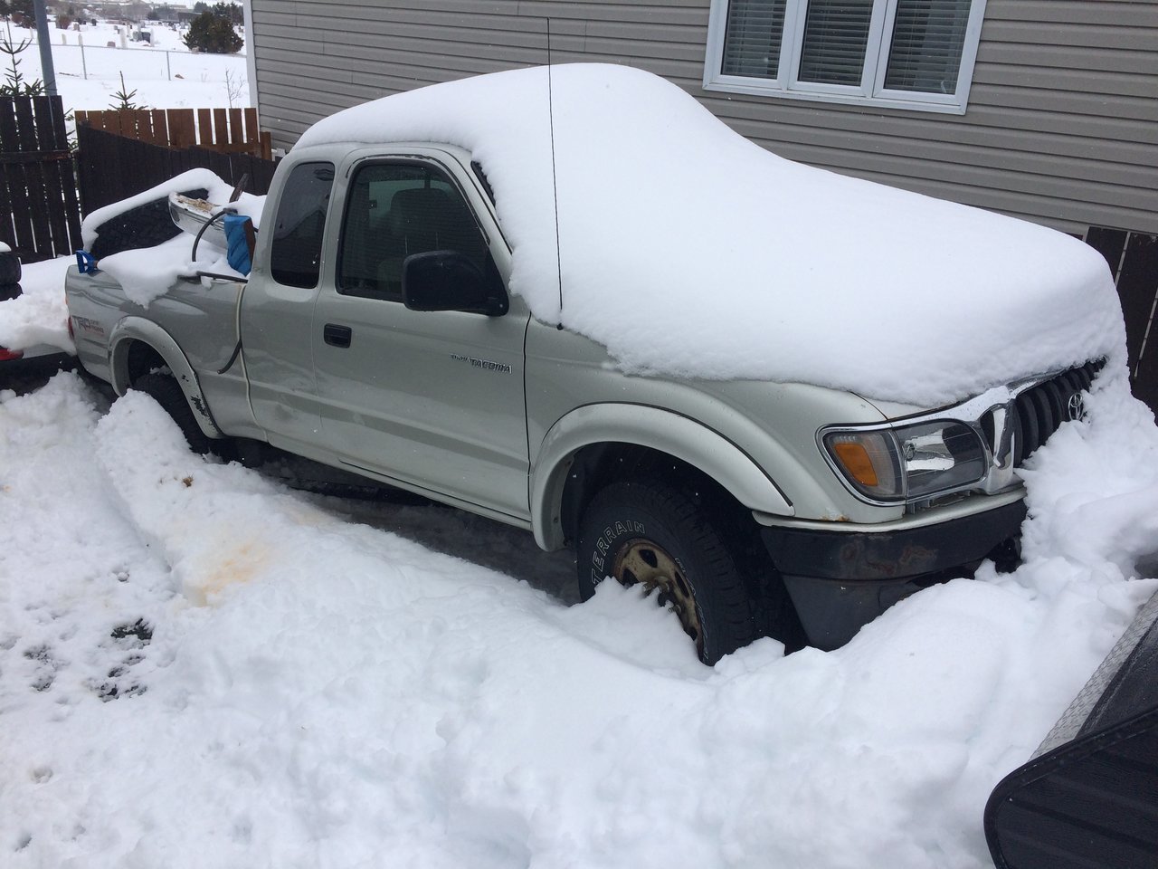

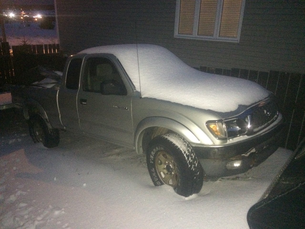

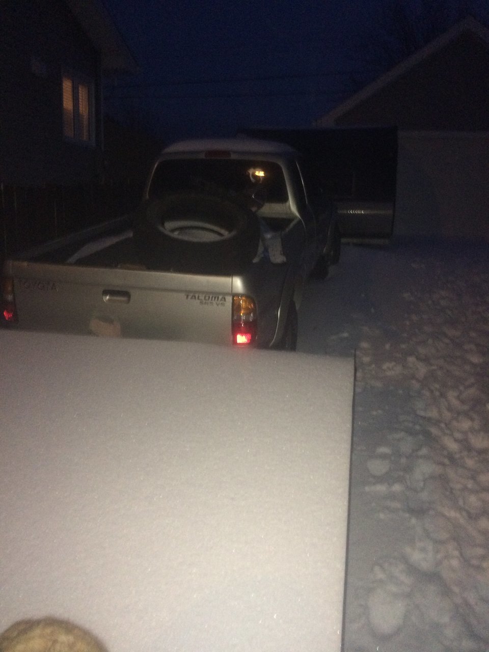

    04 is snowed in and turned into a storage shed .....
    Don’t worry this will be fixed when the snow goes.
    My plan is to put the injectors back in, take the bed off and drain the tank as I think there is water in it that made its way up to the fuel rail.
    Wonder how hard it would be to put a plow on this for cabin activities ?

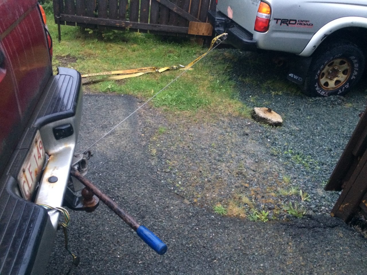

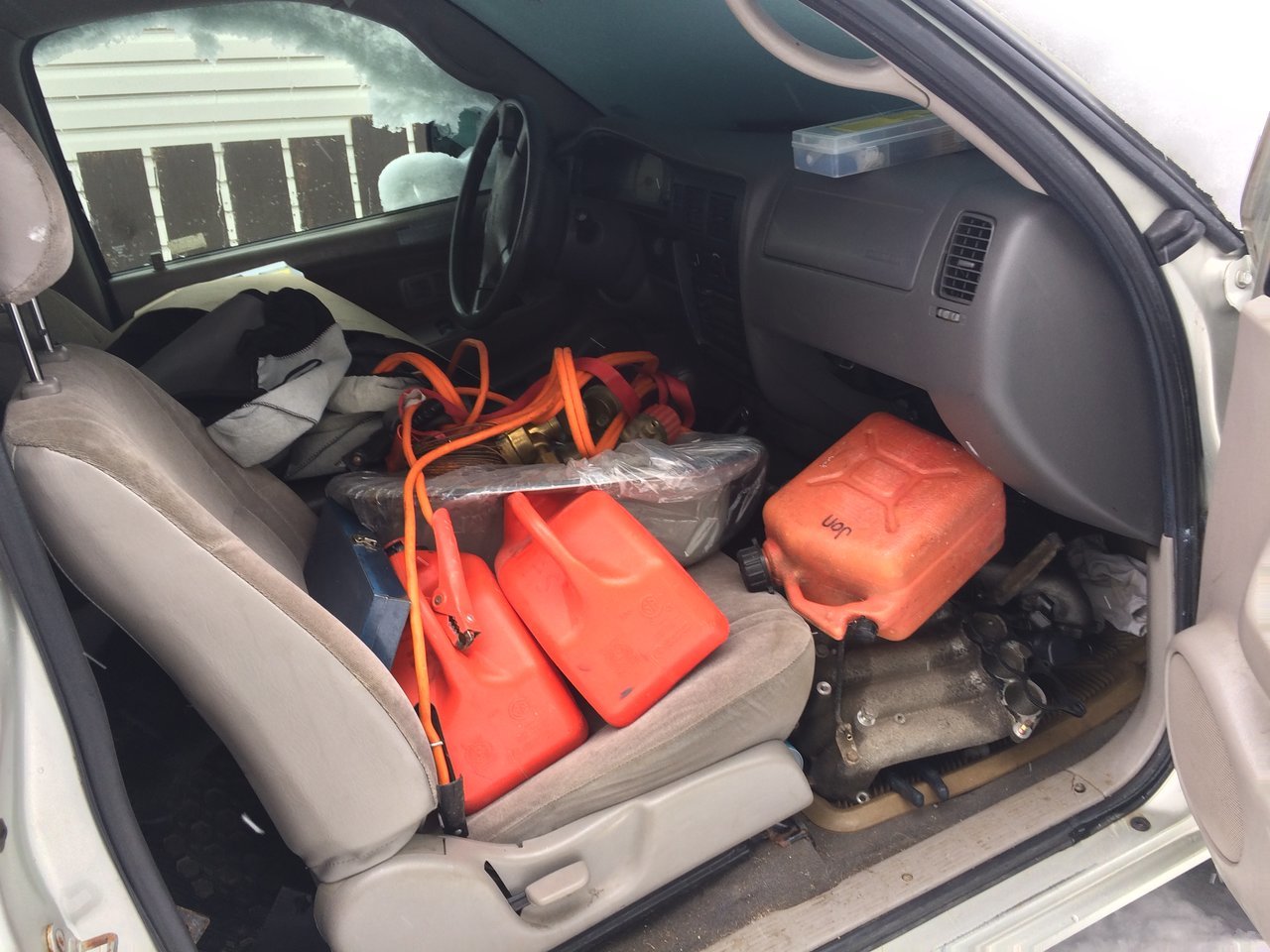

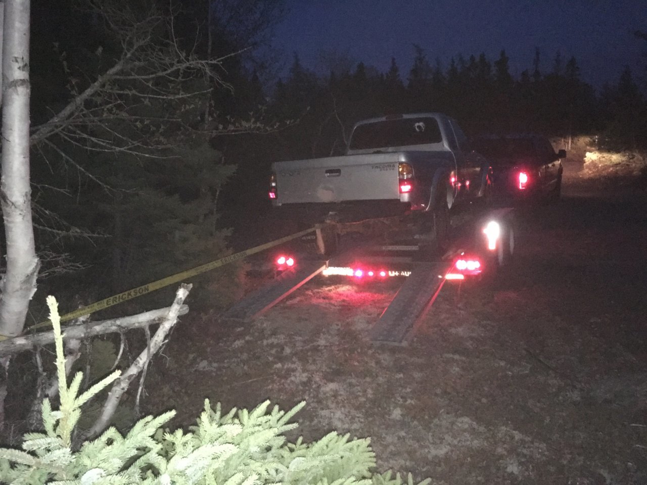

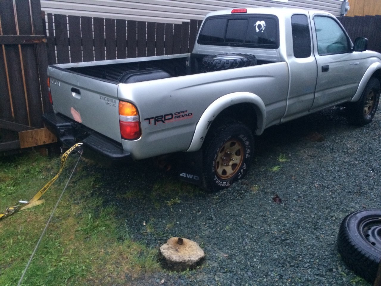

    Had a chance to get hi ho silver to my cabin 3hr away for $75 for a friend hauling a empty car trailer to go pick up some vw thing.
    The injectors are still out so it’s not running and it is full of parts.
    Pulled it backwards with my red truck and one rear brake was locked up so it slid into the fence.
    Got the comealong and pulled it sideways.
    Car Trailer showed up and pulled it out onto the street with one wheel locked up. It was in N but wheel refused to spin, few good snacks with a sledge hammer no luck. I took the drive shaft out still would not spin. We jacked up the rear end with a floor jack and winched it on to the trailer. Off it went
    My friend tied it to a tree and drove the trailer out from under it.

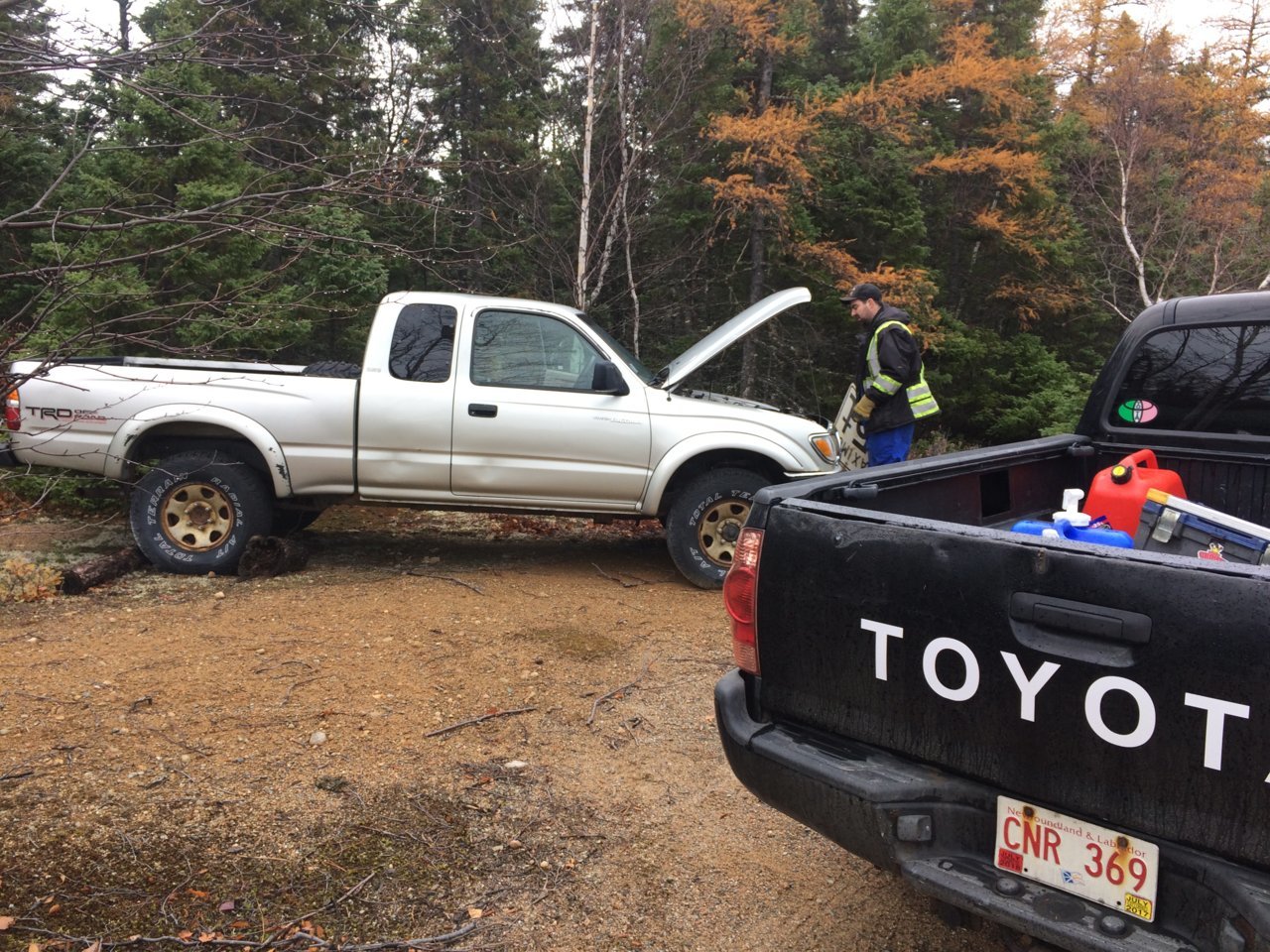

    So this truck is now 3 hr's away at the cabin on a woods road. Me and a friend have our bags packed, parts packed, tools packed .......
    wonder what Tacoma wrenching adventures are ahead of us tomorrow ?
    6 rebuilt injectors ready to go in
    gasket maker for intake manifold
    gasket scraper
    I think the plan is to get the rear brakes free so we can move it
    put injectors in and T body back on
    remove the bed take fuel sending unit out and drain the tank (suspect water in fuel that caused all of this)
    i will take lots of pictures of our success, attempt, failure
