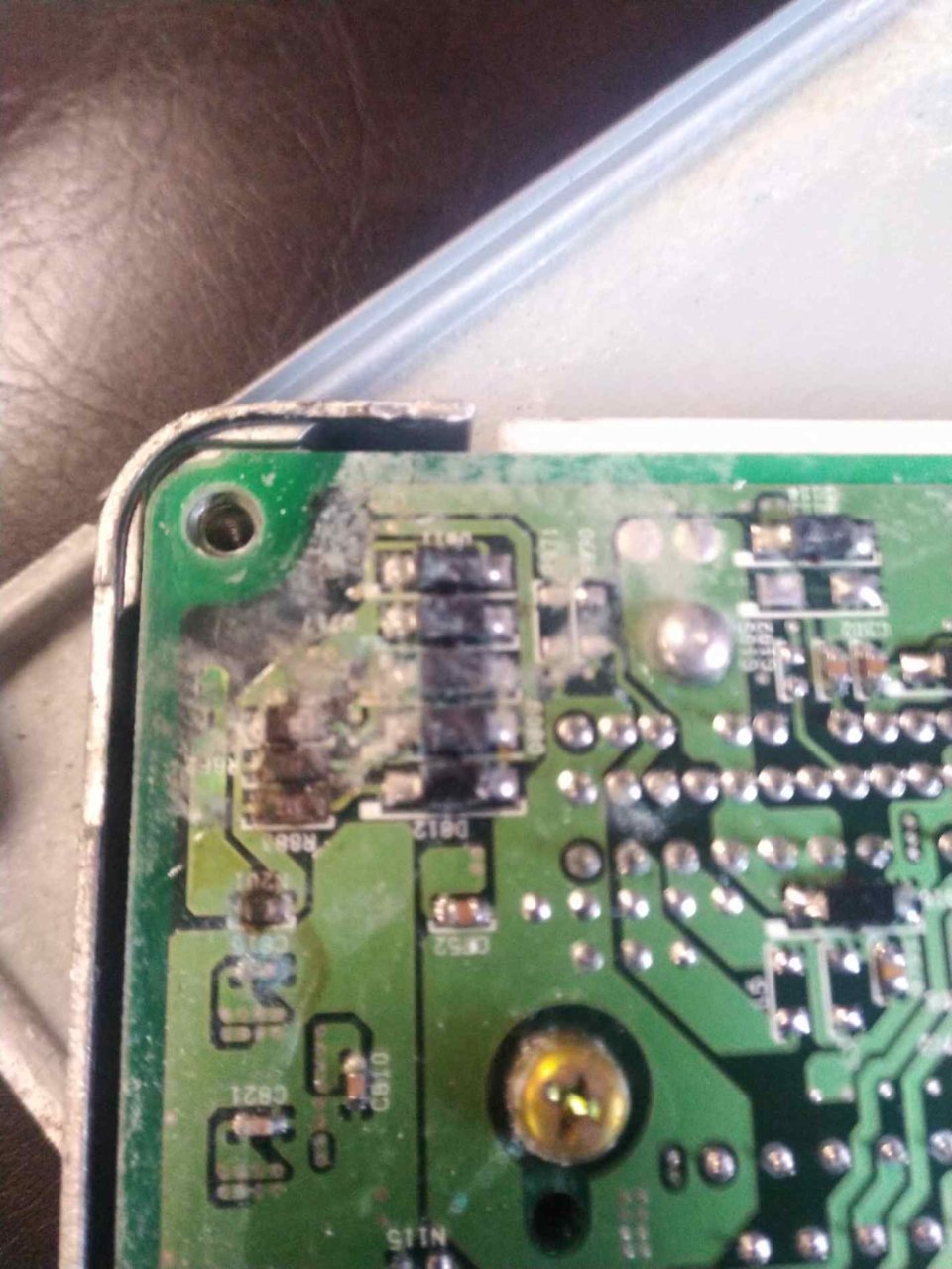

    The cause of all the issues has been found !!!! Water got into the ecm hoping this will help someone else :)
