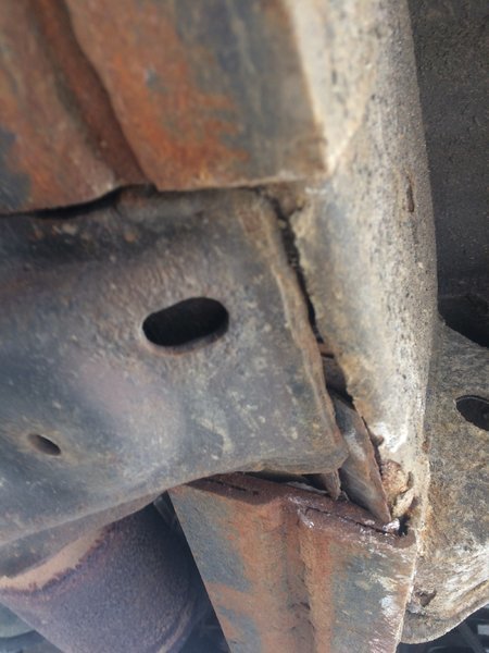

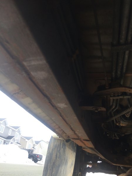

    Newfoundland? Did you inspect the frame yet? It is possibly white from the salt in the air
    Jon G[OP] likes this.

    The frame is toast ! Was repaired with angle iron and from what I can tell the previous owner did not take it into the inspection and undercoat. I am going to call tomorrow to make sure. IMG_2805.jpgIMG_2801.jpg
    islanti likes this.

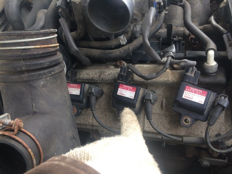

    Just thinking the truck idles fine and clean, just has no power and vibrates like mad at certain rpm
    If you ease into it the truck will do 100km down the highway
    Let off the gas and around 80-90 motor vibrates like mad
    If it was fuel then the rest of the cylinders would run like crap and that's not happening
    And it's odd that the two miss fire cylinders are on the same coil but I move the coil and the problem does not follow the coil
    Pointing to the dead cylinders

    Magnaflow 2.5 Catback Exhaust K&N filter
    Also ! When I moved the coil packs from cylinder to cylinder I did not unplug the clip that feeds the coil. To get the correct reading i should have ?
    Is this right ?
    Bagow likes this.

    You should have disconnected the wires and plugged it into the spot you were placing it. If you left the wiring original, but just moved the coils, the engine will fire the coils as if they were in their original position, causing it to run even worse.
