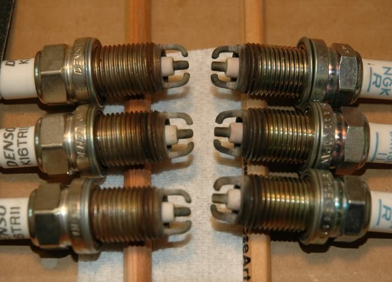

    All 6 plugs show uniform rich condition. Can your scanner show diagnostic data, fuel trims, timing, coolant temp and so on?
    Plugs below have 30k miles.
    They are ngk double ground. They are not that old but are BLACK with carbon deposits.

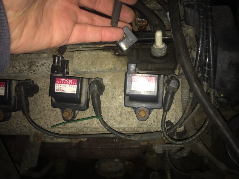

    Thoughts on compression numbers ?
    And DONT CHANGE THE COIL LEADS !!!!! Your 3.4L will not like it ! IMG_2968.jpg

    Yep, the significance being that your super rich burn looks equal across all 6. This would seem to indicate a system wide issue. You have the general miss fire code and the 3/6 cyl specific codes. Cyls 3 and 6 might be just a tad more susceptible to setting the code for other reasons like slight differences in spark or injector flow, not enough to be much of a problem on their own.
    A scanner with diagnostic capability is nearly indispensable for this type of situation.
    Compression looks good, good enough to not be the problem.

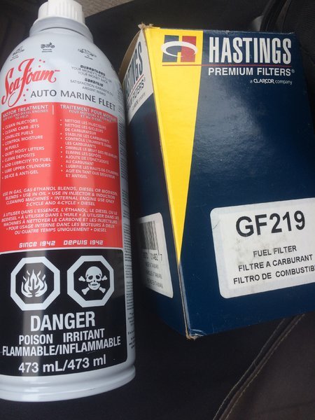

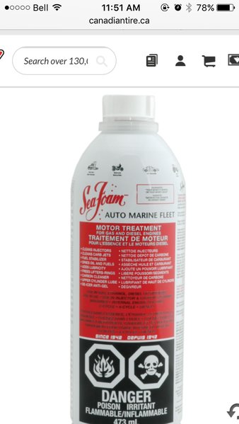

    Sea foam !
    The one I need to clean injectors looks like you add to gas ! No spray bottle.
    Problem is this truck is not on the road and putting it in the tank would take forever to run through the system and clean anything as it just goes up and down the street and idles while I play with it. Can I pour this into the intake ?
    I know I know this is a long shot
    But if I do this I might see a improvement and then it will give me better direction. Maybe

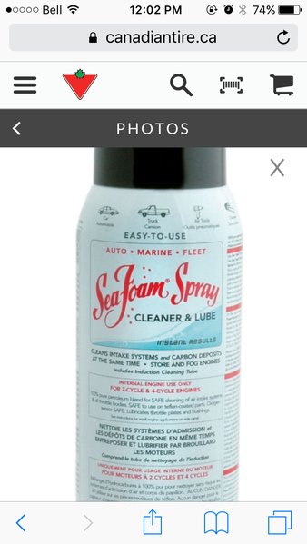

    Magnaflow 2.5 Catback Exhaust K&N filter
    This one has a spray tube but lists it to clean intake and carbon deposits NOT INJECTORS,
    Guess I will have to go over and read the can

    Yes Rethinking this and it would not work for injectors !
    So new plan
    I am going to take the fuel filter OFF and have a look to see what kind of crap is inside it, this truck came from a small island of the coast of Newfoundland, as far east as you can go without getting wet !
    Why am i telling you this ? Because i am sure the gas quality over there in Ma and Pa's small gas bar might not be the best !
    While fuel filter is OFF i will fill filter with injector cleaner and reinstall. and dump the rest in the tank
    If what came out of the filter is nasty then i might have to drop the tank to look inside ....
