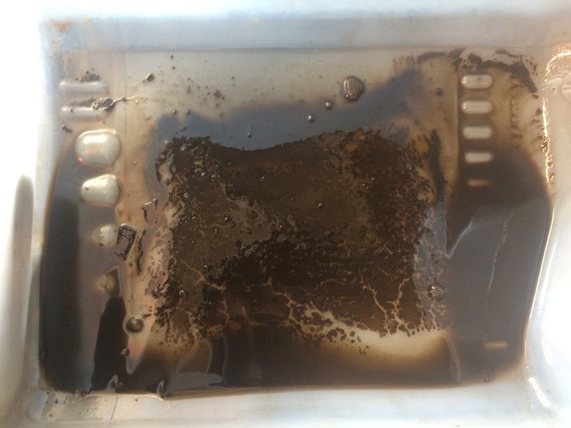

    This is what came out of the 04 Tacoma fuel filter ....... :( IMG_3042.jpg

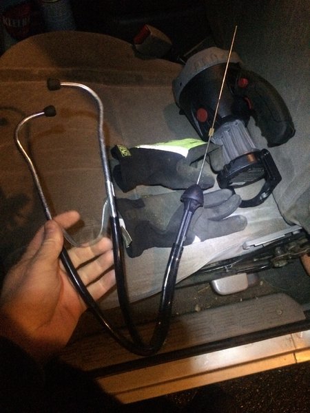

    Ok trust me I am a doctor !
    Used my mechanics stethoscope to check 4 out of 6 injectors. The one that is missing is clacking, not one injector clacked the same even checked my DD 02 ....... all clacked different IMG_3059.jpg

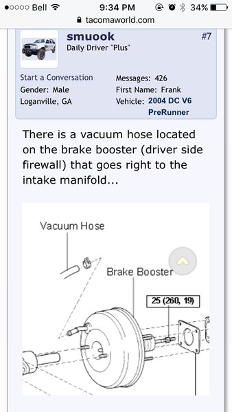

    EDIT !!!! STOP I DID THIS WRONG AS I DID NOT READ THE WHOLE POST IN THE LINK. THE BRAKE BOOSTER IS NOT THE CORRECT PLACE TO DO IT, THIS ONLY GETS TO ONE CYLINDER !!!!!!

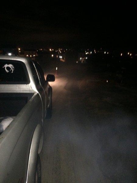

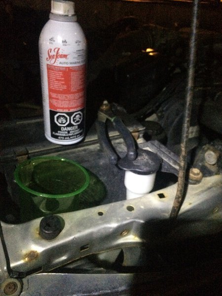

    Also sucked seafoam into the motor, I did this on both trucks, took the vacuum line off the brake booster and sucked it in, turned off for about 30 min and went for a spin and filled the neighborhood with smoke. Did it do anything, unsure but there was a LOT of smoke. Pictures do not do it justice!

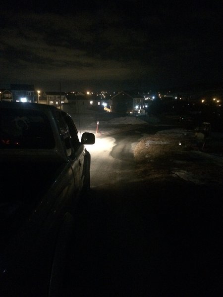

  10. Mar 9, 2017 at 3:44 PM
    #170
    cruiserguy
    cruiserguy Well-Known Member

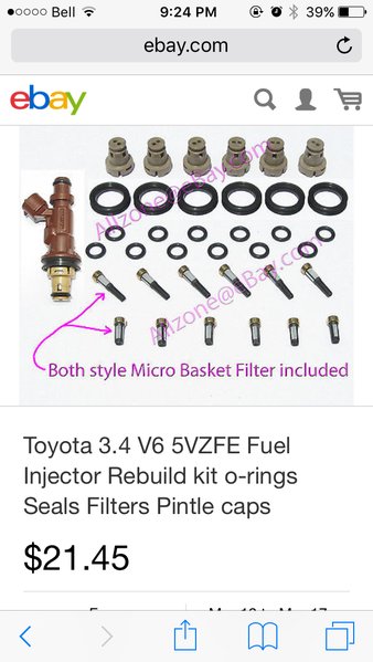

    Sounds like bad injectors. They can be rebuilt. After it runs, have you checked a spark plug to see if it's wet? Could be a sign of an injector needing rebuild as it wouldn't be spraying that fine mist it should. 'Drippy' air/fuel mix could have a hard time igniting. I am just guessing here. I haven't had any experience with failed/failing injectors personally.

  11. Mar 9, 2017 at 3:46 PM
    #171
    cruiserguy
    Jul 31, 2016
    #193416
    19,000
    Elijah
    SEKS
    2000 ext cab, 2.7L, auto, 4x4
    Lol, waited until dark to do the 'seafoam smokeout'. Hahaha, smart man.
    Jon G[QUOTED][OP] likes this.

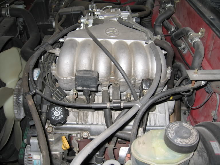

  12. Mar 9, 2017 at 4:27 PM
    #172
    StAndrew
    StAndrew Wait for it...
    Feb 8, 2010
    #30950
    8,364
    Hampton Roads, Va
    SR5 4x4TRD
    Intake, exhaust, lift. Typical stuff.
    Nooooo....
    You got to read man. Use the PCV vacuum fitting that is right behind your TB, IIRC, hopefully I'm wrong, if you do the brake booster you are dumping all that seafoam into one cylinder. Its probably a very clean cylinder right now...
    Either way, dumping it through the PCV fitting will get a much better and more even dispersal through your intake manifold to clean that out, and it will disperse better to each cylinder, cleaning all the valves, etc...
    From that fuel filter, two things. You should probably clean your injectors (remove and have professionally cleaned) and you should probably get a new fuel tank or at least clean it out because it looks like its rotting from the inside :(

  14. Mar 9, 2017 at 4:56 PM
    #174
    StAndrew
    Feb 8, 2010
    #30950
    8,364
    Hampton Roads, Va
    SR5 4x4TRD
    This fitting here?:
    No, each of those runners are all individual pipes at that point. If that's the fitting you used the join the club; I did it too before someone smarted up and pointed out that all of TW is driving around with one nicely polished cylinder and 5 dirty, neglected cylinders...

    I was thinking about ordering a rebuild kit from eBay, going to upick and pulling some injectors and having a go at rebuilding them, then swap them out.

  17. Mar 9, 2017 at 5:10 PM
    #177
    Jon G
    Jon G [OP] Hoarding Tacomas one at a time,
    Jan 25, 2017
    #208594
    1,851
    Jon
    St John's Newfoundland Canada
    02, 04 & 07 Tacoma
    Magnaflow 2.5 Catback Exhaust K&N filter
    Took it off the booster
    Thoughts ?
  18. Mar 9, 2017 at 5:14 PM
    #178
    Jon G
    Jan 25, 2017
    #208594
    1,851
    Jon
    02, 04 & 07 Tacoma
    Looks like I should of went through all 17 pages of the sea foam post...... on to the third can of sea foam ... I guess ...
