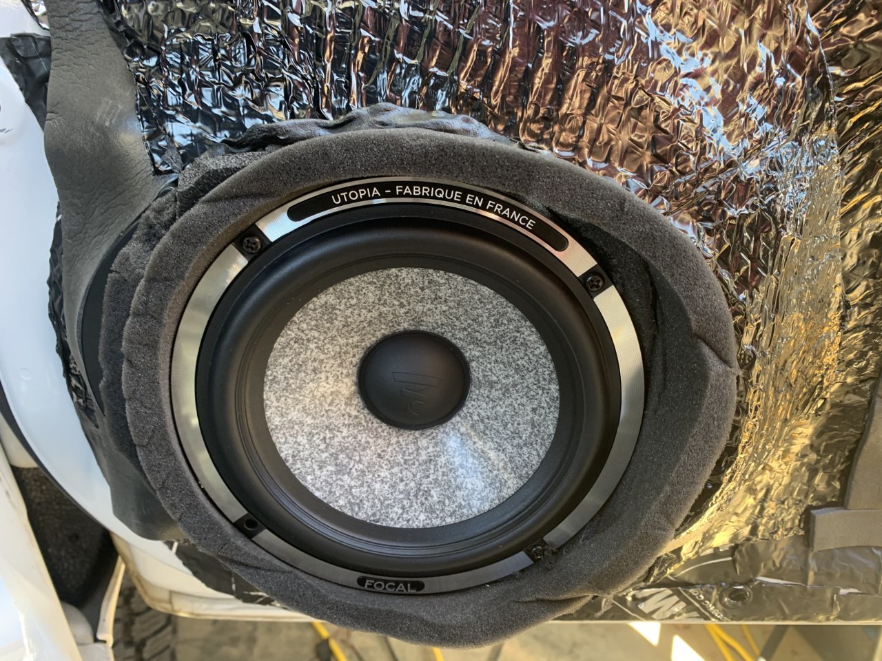

    JBL stadium 3 ways in my truck
    [​IMG] [​IMG]

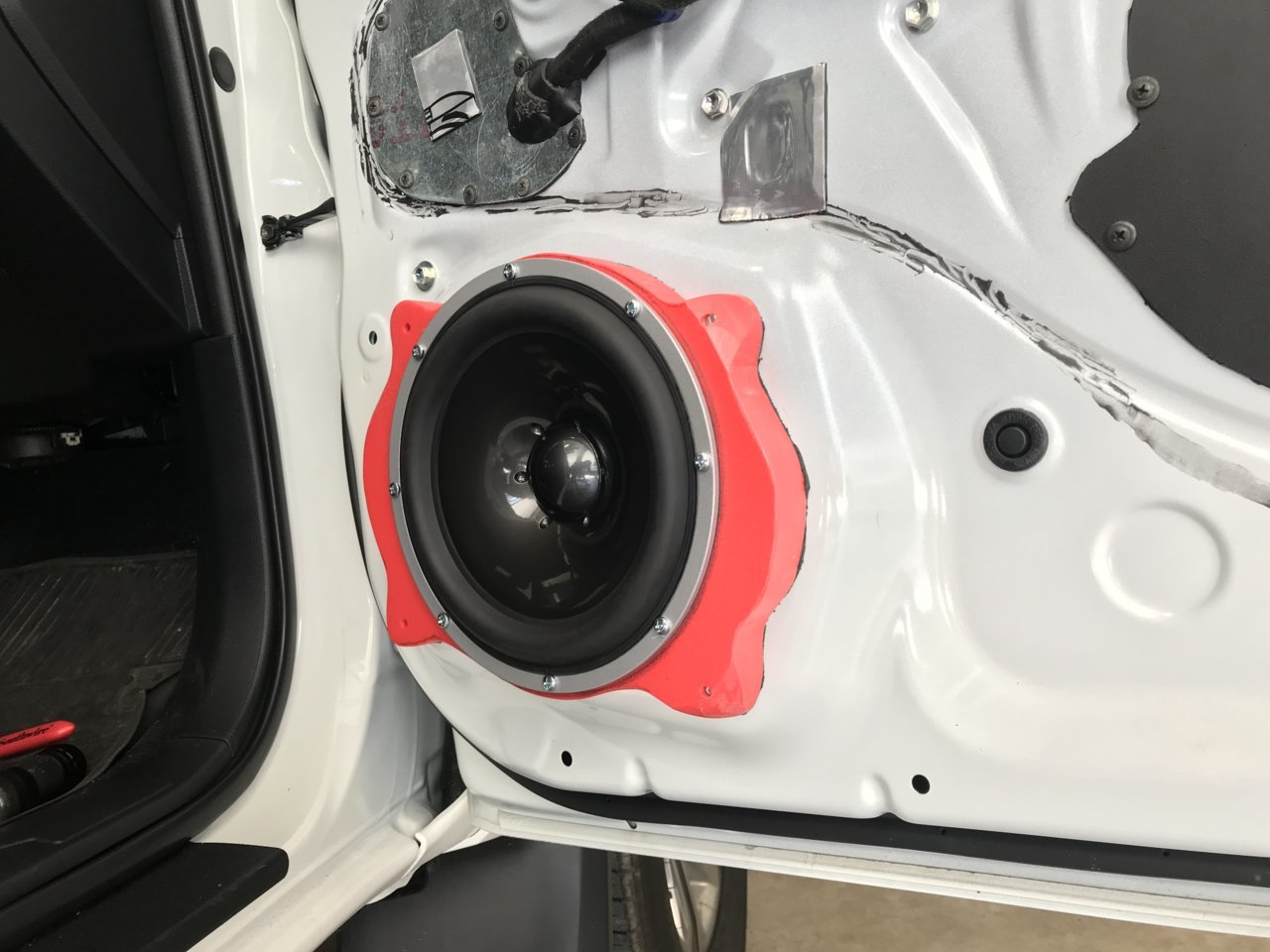

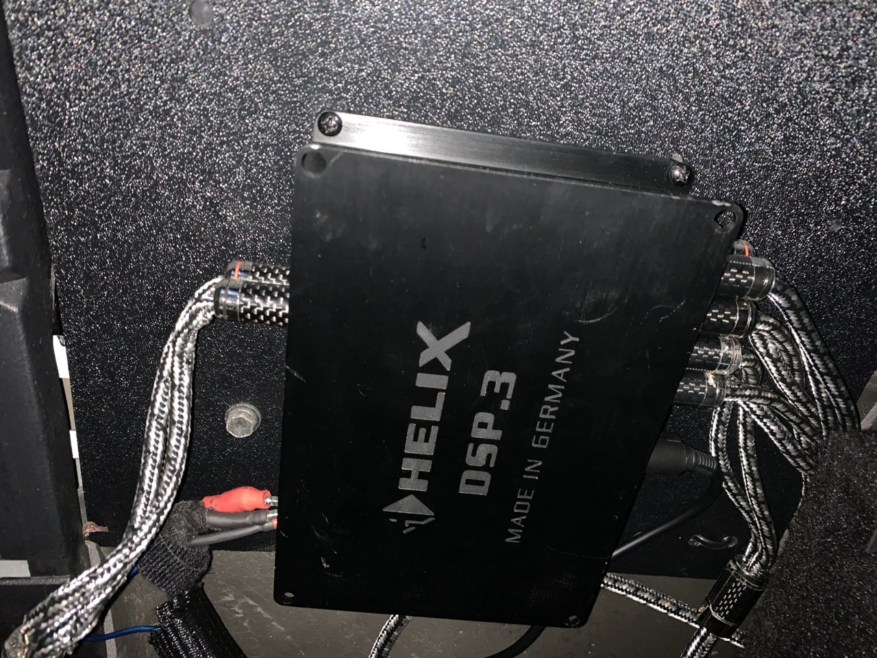

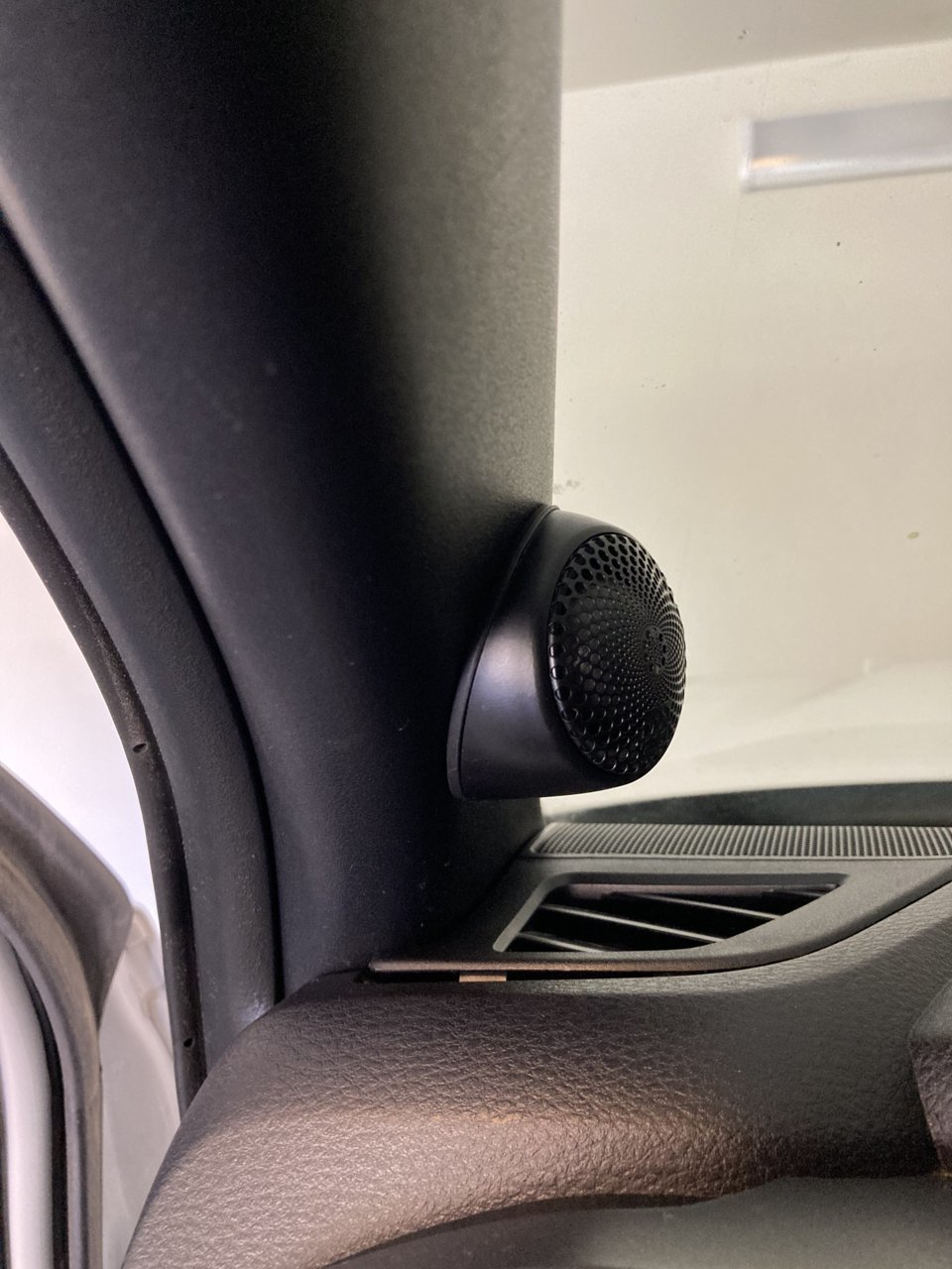

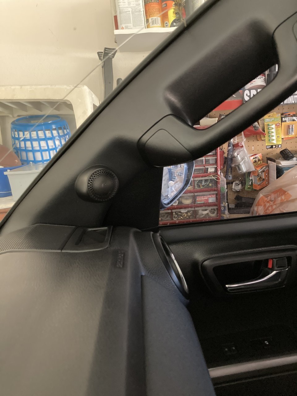

    Morel mt350 tweeter with surface mount pod. 3.5” cdm600 in the dash, and morel hybrid 6.5 in the door. Running an alpine x a70f for the doors and tweets. Alpine pdx v-9 for the mids, rears, and jl w3’s. Everything is tuned through a helix dsp.2

    Are those the pods that came with Your tweets? I'd love to move my tweets from the dash.

    Yes. These came with tweeters. They are really nice and match the interior. They need some power though. I wouldn’t run less than 100 watts to them. It’s the best tweeter I have heard.

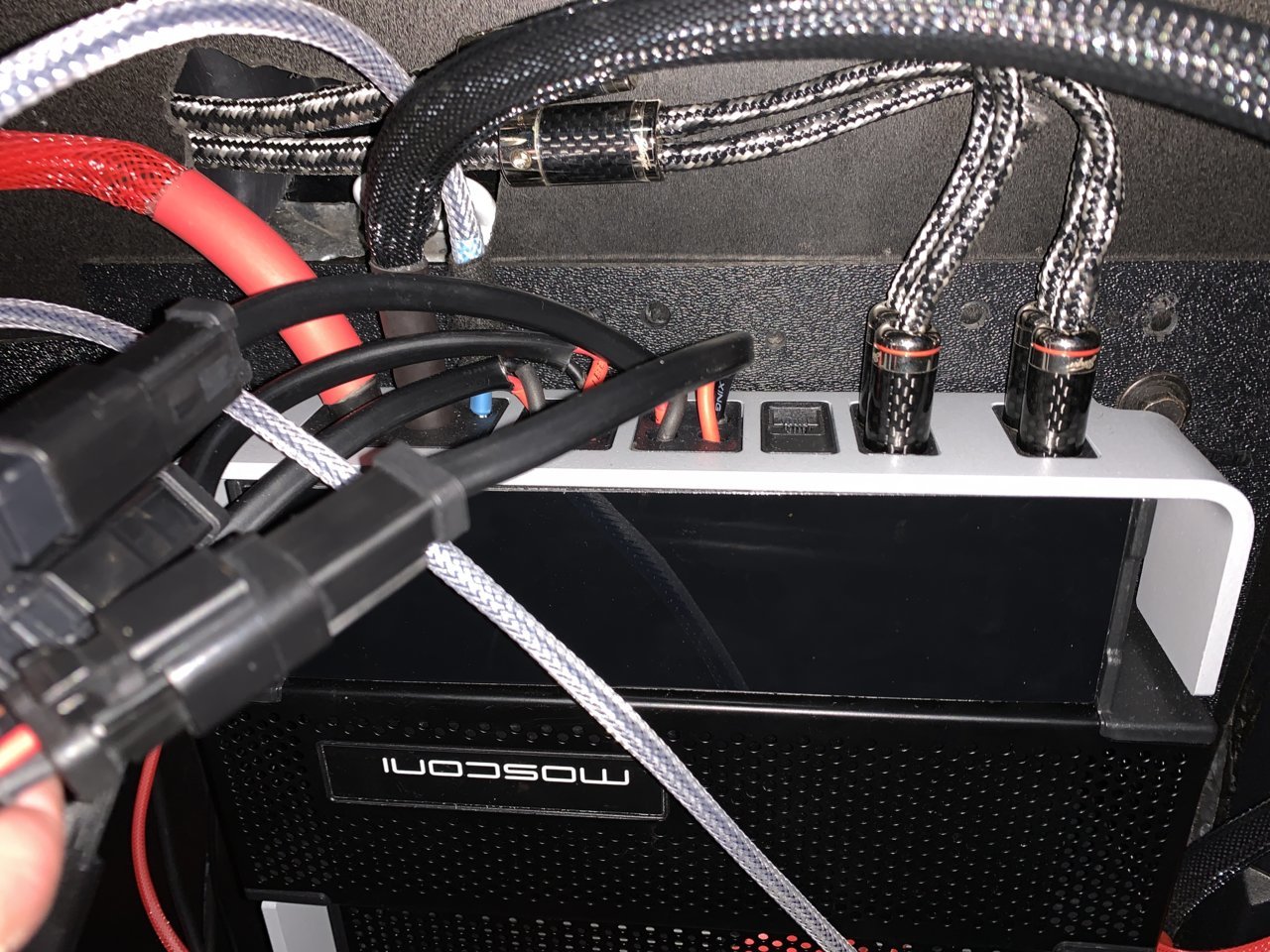

    Bilstein 8112/8100 ICON RXT Stage 2 JBA UCAs Archive Garage HH w Shackles Archive Garage U Bolt Flip kit Nitto Ridge Grapplers 255/80/R17 TRD Front Skid and RCI Transmission Skid Kenwood DMX 1057XR Head Unit Focal Utopia WM 3 way plus WM10 Sub Mosconi 5/30 and Genesis Dual Mono Amp

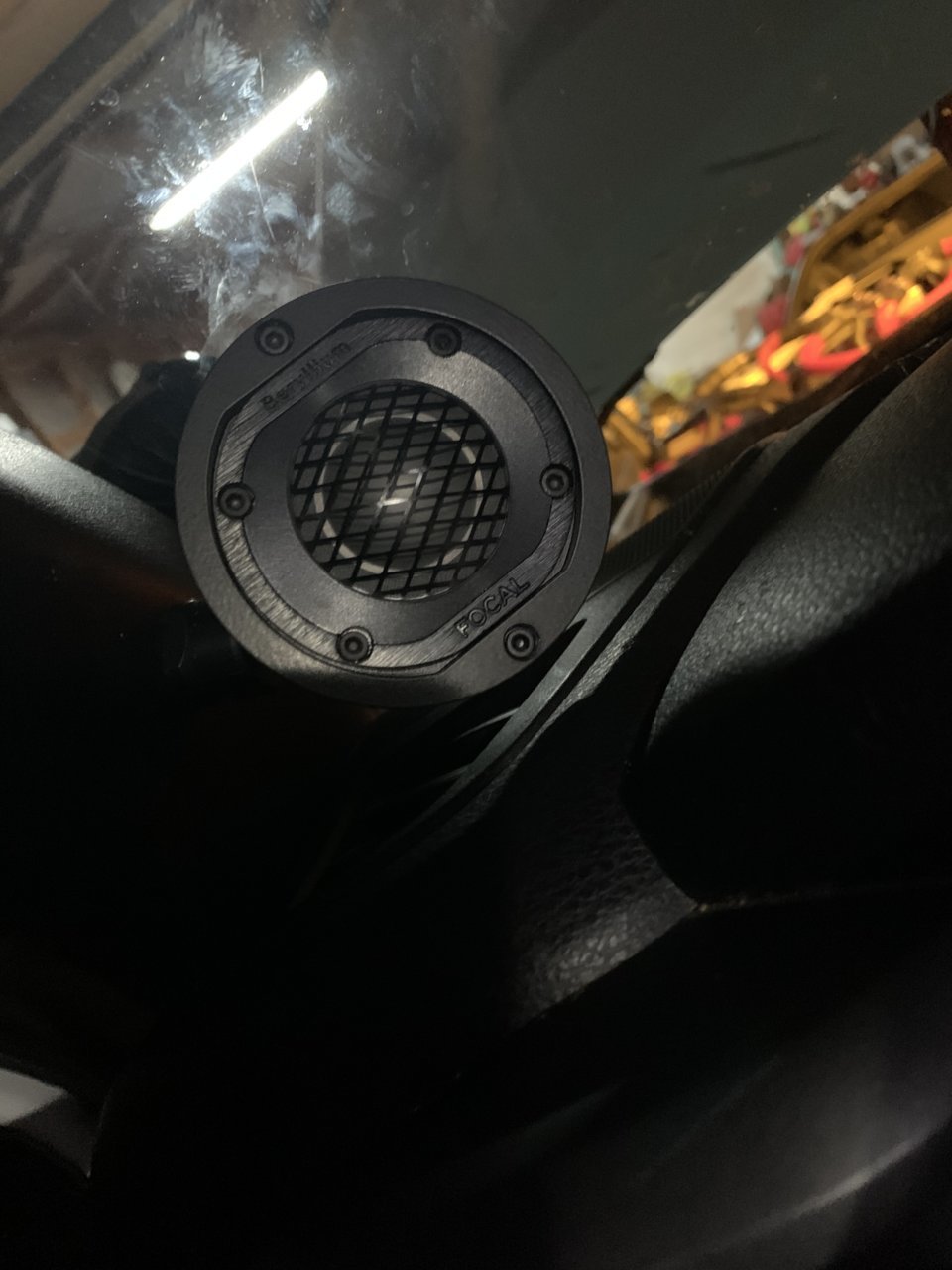

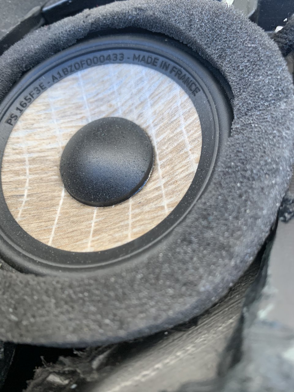

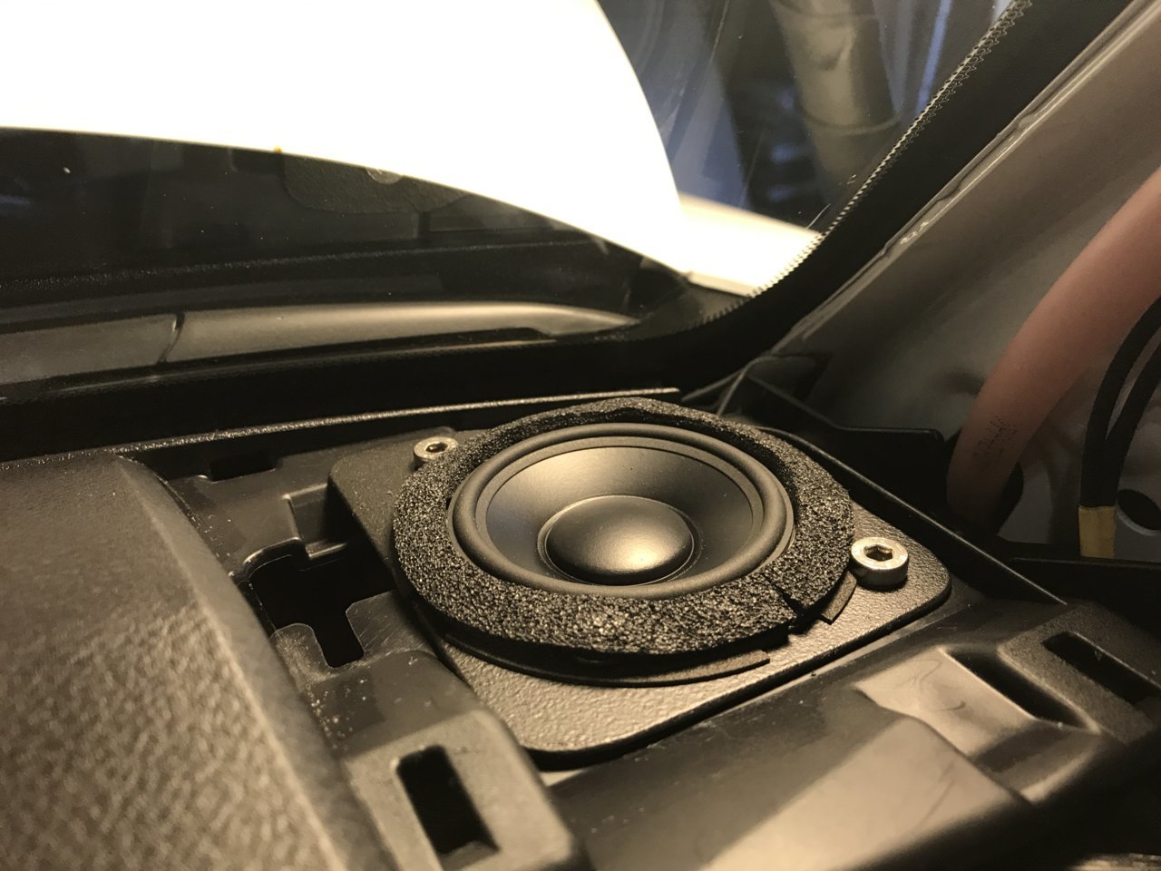

    My fabrication skills aren’t on the level of these guys but this is what I’ve got currently with valicar ball bearing tweeter pods mids in dash corners and these aren’t the mids I’ve currently got in.. I’ve got them mounted the same way though but no pics... I’m searching for a pair of utopia No7 3 inch mids to replace the Mille legends I’m currently using but I’m loving the valicar pods image.jpg image.jpg 5762982A-BAF2-40CC-AA6E-489B4BFC17E8.jpgD628E62C-1CCF-41D5-8EEE-CC6607B8749A.jpg FF316773-76D9-4B63-BAF7-99C45D1FD28B.jpg

    Nice, how was the cdm600 fitment in the dash corner? any modifications to make it fit? bolted down or just held down with the grill cover as I see the grill a bit lifted in one of the pics

    The cdm600 drop right in. I just swapped them for the cdm880, also fits nicely.

    I'll probably do the tweeter a-pillar mount as yours, looks great!

    all the new morel tweeters come with a similar surface mount pod. I liked my 2-way setup but the 3-way is on another level. Definitely do it if you have the funds and equipment.
