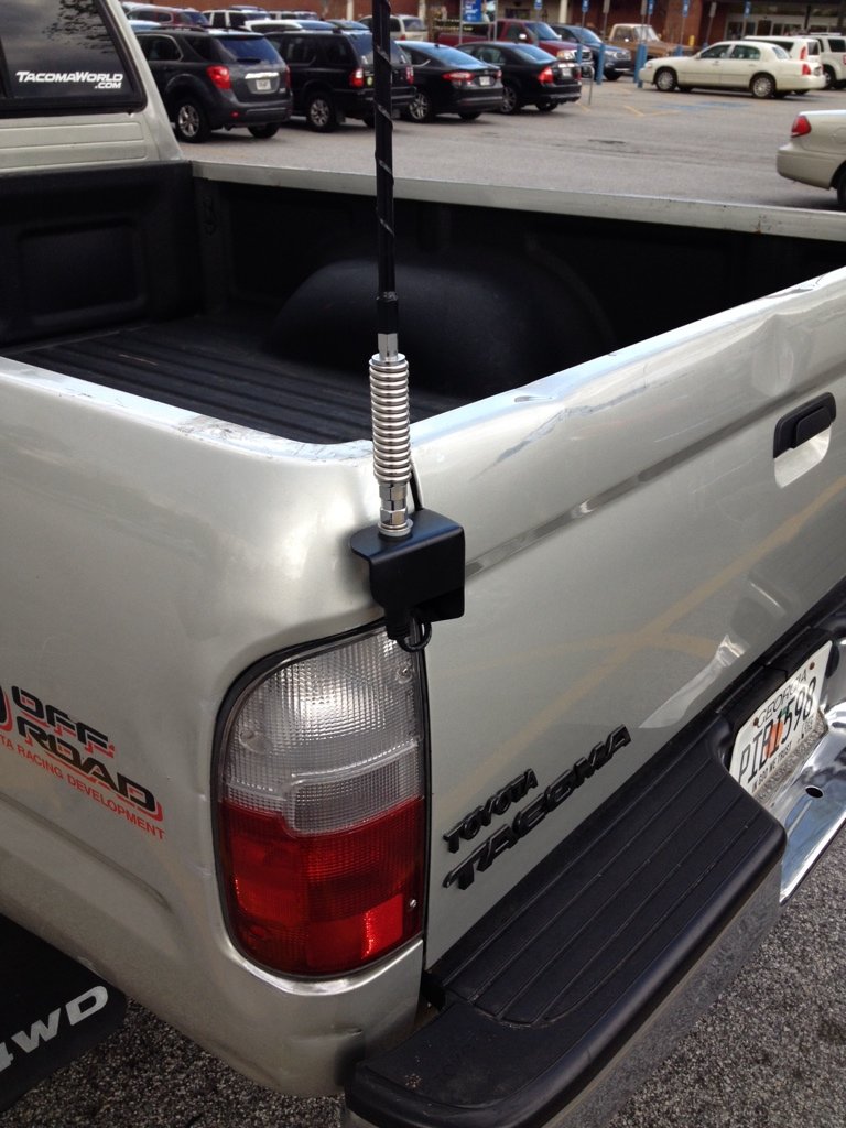

    End of the tailgate using the bamf mount, I'll post a pic

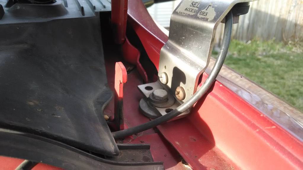

    This is how I used to have mine. It in the driver-side front corner of the bed.
    A little hokey, but worked well.

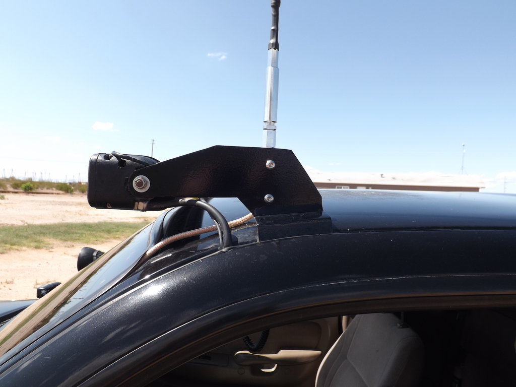

    BAMF x3. Looks and fits good, & plenty strong! Worth the wait when ordering.

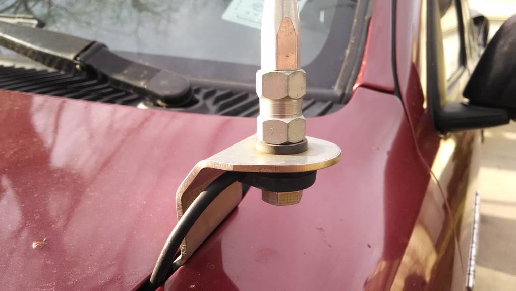

    Under hood.

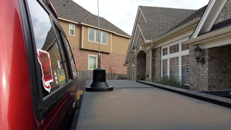

    I use to have my cb antenna on my ARB bumper
    I now use a Wilson 1000 magnet mount antenna.
    It is on my tool box.
    The SWR is way under 2.

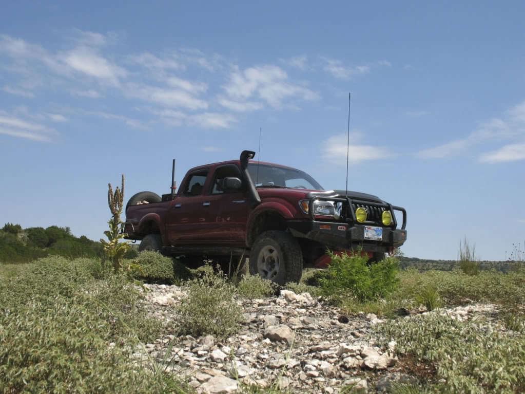

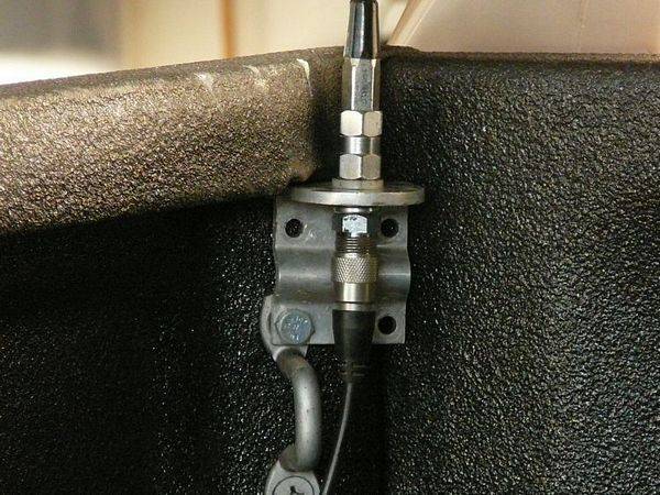

    Four foot Stik on the bumper I built. Great SWR. Doesn't flop around. Doesn't get in the way.
    How I built that corner of the bumper to allow for coax connection. I used a 90 degree coax elbow in there also.

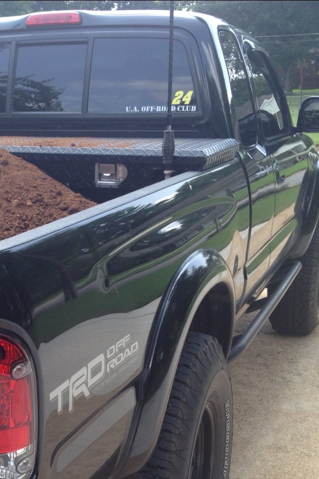

    Not a good pic but you get the idea. Extra long mirror mount bolted to the toolbox.

    I have the BAMF tailgate mount. I mounted a 4' Firestik antennae to it. IIRC, Jerry will bore a different sized hole as you require. I want to say the BAMF mount came drilled 1/2" antennae hole and I needed 5/8"..or maybe it was vice versa? Sorry I can't recall more specifically.
    I really like that BAMF mount, powder coated - a real quality piece of kit. Good luck on your project.

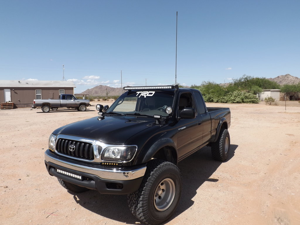

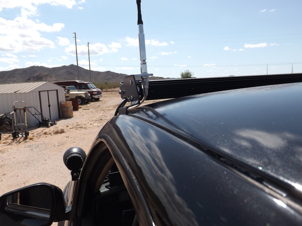

    Wilson super flex w/quick disconnect easily accessible with a quick reach out the window. Awesome antenna too btw. She really dances and flexes up there:D Wind kinda bows her back pretty good at higher speed, but no biggie.
