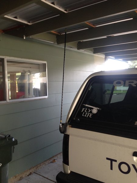

    I routed coax along the drivers side frame rail and through the grommet just under the driver's seat. Easiest to pull the seat and route cable through grommet and under carpet to the dash. I remember the 18' coax was just enough to do the job, and I came right right off the aerial on my tailgate and under the truck and forward. The picture attached shows the mount. I'm also using a quick disconnect.
    Oh, one other point, depending on where you mount the CB receiver - mine was in one of the radio DIN slots - you may need to work a little more room for the coax cable connection. I used a 90 degree angled connector but still need to take a heat gun to the HVAC duct that runs behind the dash and pushed it in for a little extra room.

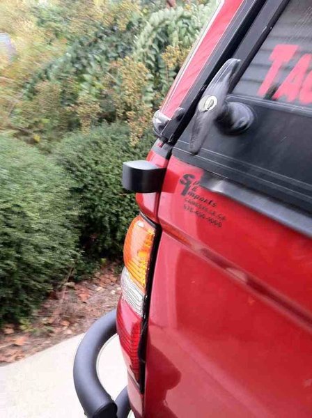

    I mounted my CB where the ashtray goes, so I ran it under the carpet then down through the grommet shown that's under the driver door. I drilled a small hole in the bottom of the bed and ran the wire to the mount I made. You don't have a canopy, but you could do pretty much the same thing.
