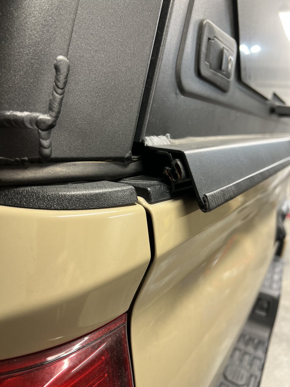

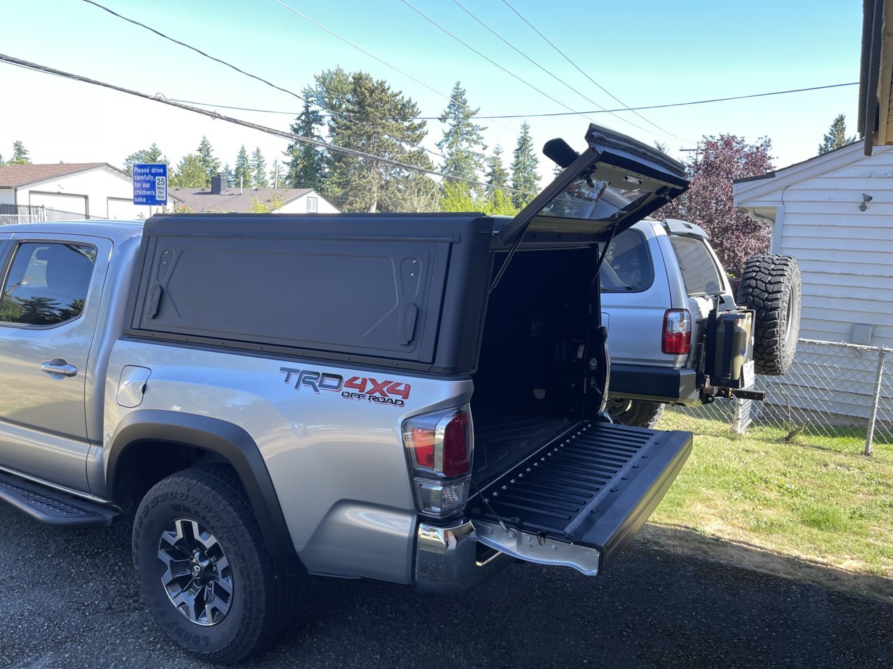

    Great looking taco.
    It may not matter much to you due to your vehicle being lifted, but your Contour, like mine, shipped with the wrong struts in the back. This only lets the rear hatch up a little more than level. If you look at their website, or other photos of vehicle's on here, you will see what I am talking about. I had my Contour on before I threw the lift on and I could see me smashing my head on the rear hatch at the shortened open height. Now that it's lifted, it may not matter much. But they shipped a bunch out with the shorter struts in the rear. I let MULE know and showed them Alu-Cab's own pics to illustrate what I was talking about. They drop shipped me the new struts. They are easy to swap out.

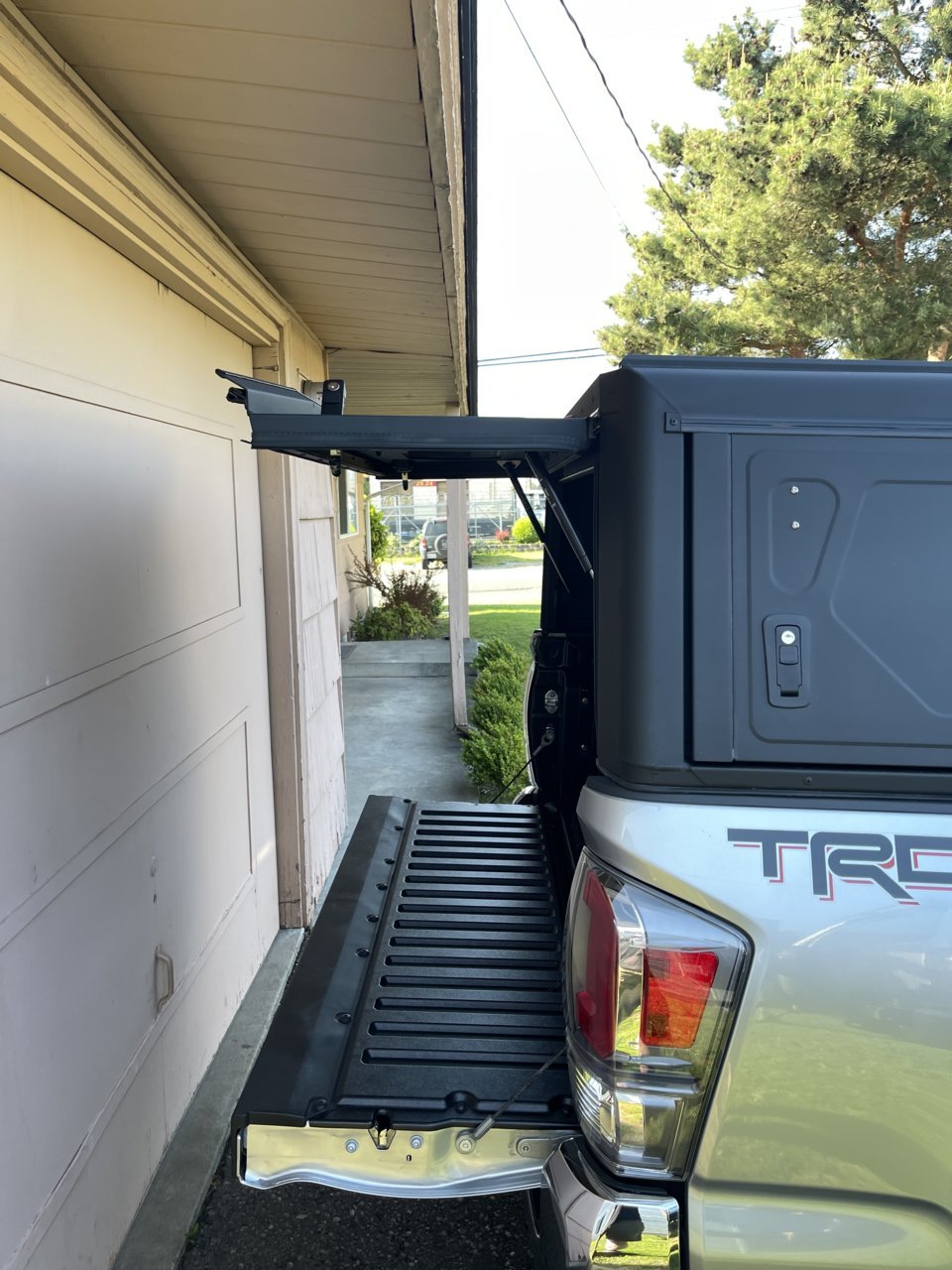

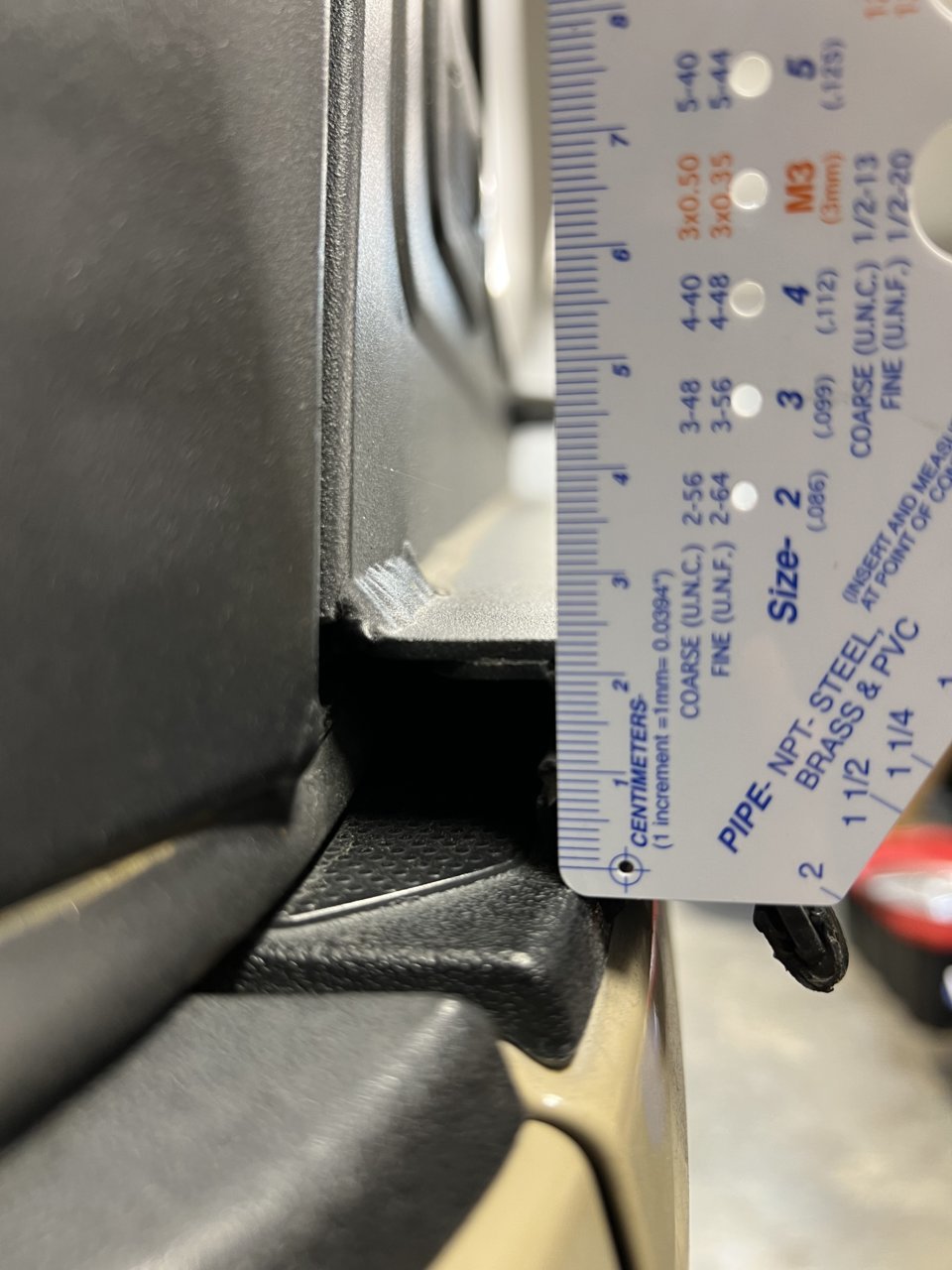

    Does anyone with a contour canopy have a picture of their rear hatch and how high off of the tailgate it is? Or measurements? The instructions say 5mm which seams incredibly close to me. That would be less then 1/4”.

    I'm not sure if this helps you, but here is at least something to work with. It's definitely more than 5mm. The weather strip still makes solid contact though.

    That’s pretty much exactly how mine ended up. Thank you!
