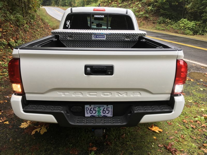

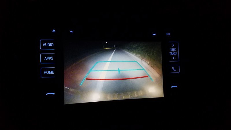

    Finally got around to swapping out the reverse lights. For 21 bucks Im impressed. Half the price of vleds. IMG_0257.jpgIMG_0178.jpg IMG_0259.jpg
