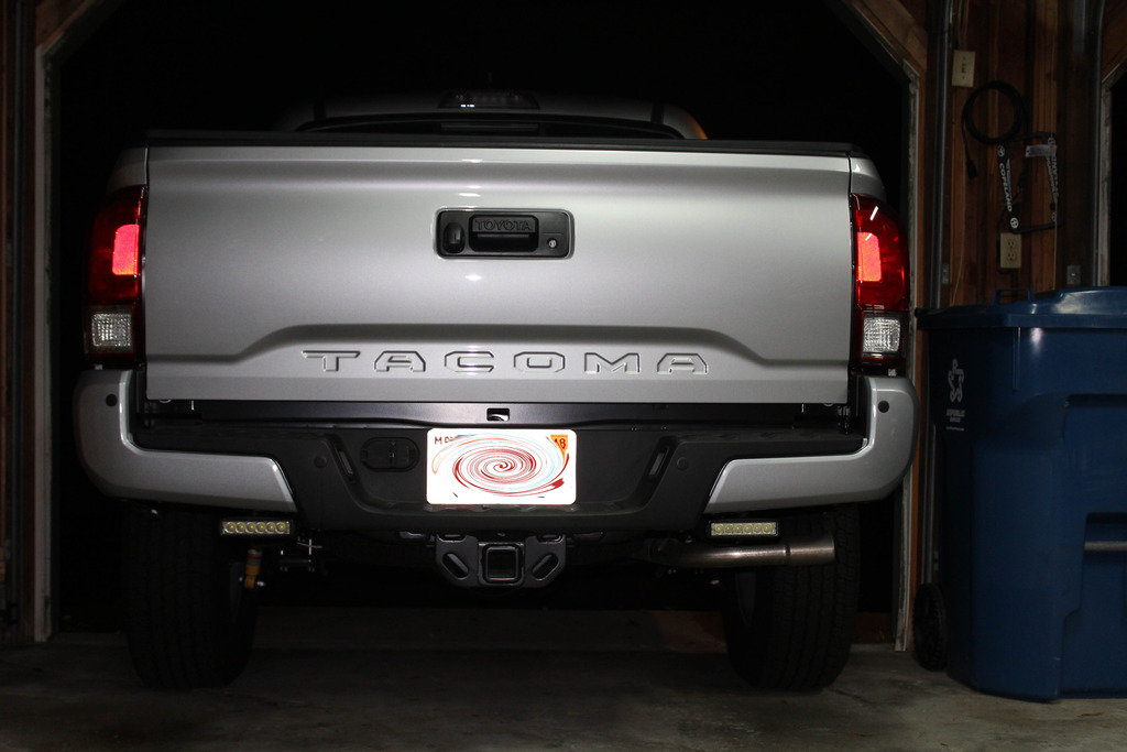

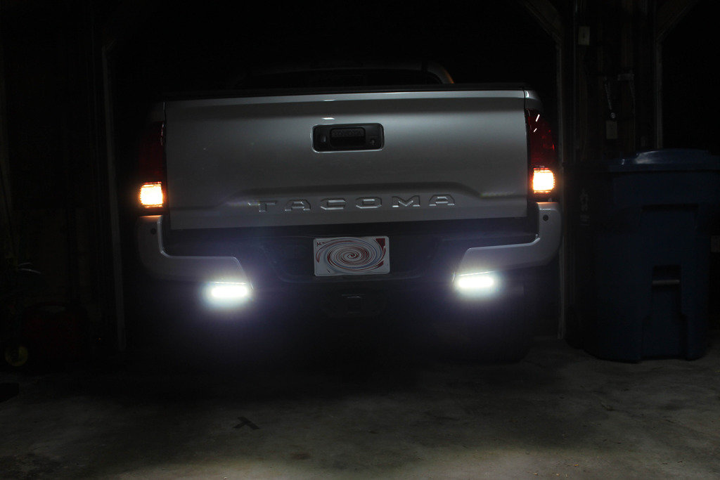

    These are a set of cheapies from Amazon.
    I mounted them using existing bolts from the bumper and tapped into my trailer harness via Posi-Tap connectors for a signal and grounded using a nut/bolt/washer on an existing hole in the bumper. They are nice and bright, but do not interfere with the camera.
    The only downfall is that the winter has definitely let water into them, so the chrome reflector looks a little worse for wear on the passenger side. They do still work properly, however. I can also remove these without any issues with the truck. All my connections were done using quality connectors and self-sealing tape. I could remove the connectors, seal up the needle points on the wire for the trailer harness and be good to go.
