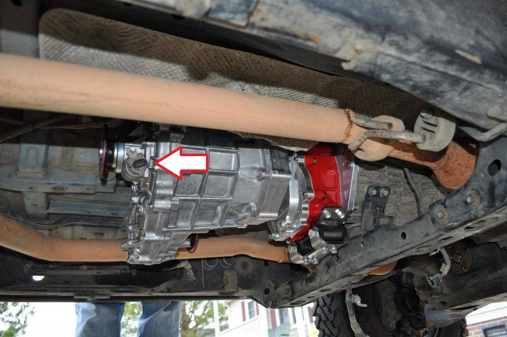

    If you have an auto, no swapping of the speedometer gear is necessary. None of the autos ever used that output. Here's a simple check, go walk under your truck and see if you have a plug where the arrow is or if there is a blank off plate. speedo output.jpg

    You got it! Here's mine:
    I just don't know about that ugly ass actuator on the back. Can't wait to get rid of it!

    @DesertRatliff, I have a 2014 manual and the case I got was from a 5th gen 4runner, not sure of the year or model, sorry. Looks like you have no speedo plug so any 5th gen 4runner case should be good, because SMKYTXN said none of them have the worm gear which you dont need.

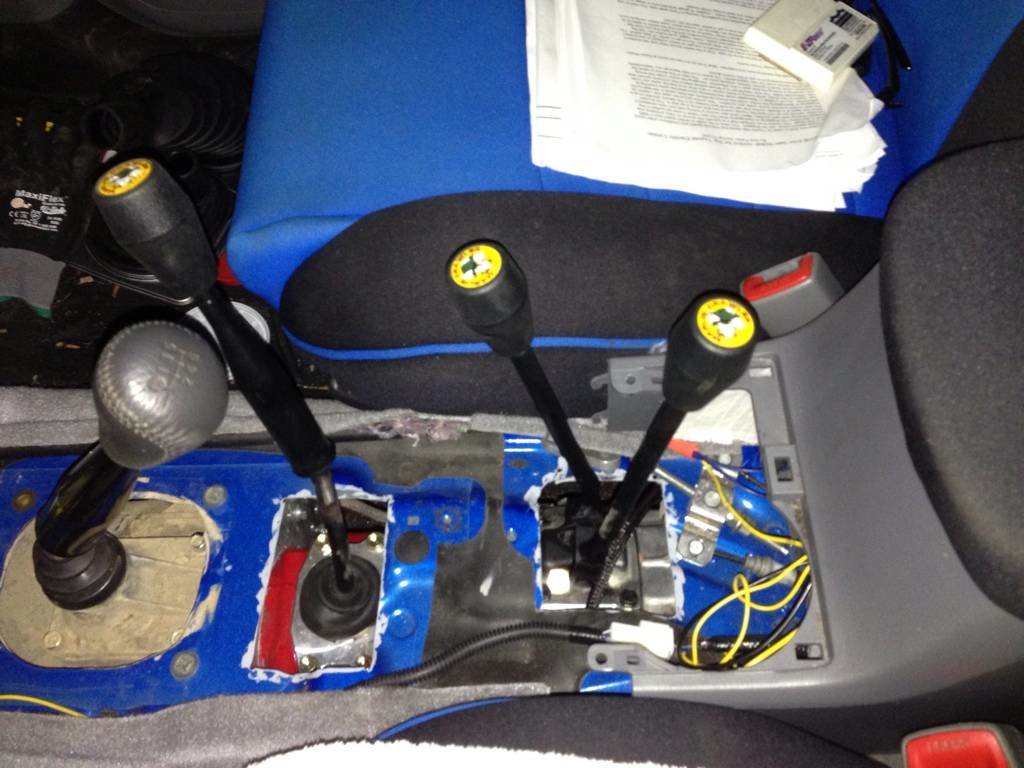

    VVVVV This. I have one of the original marlin crawlboxes and also marlin twin sticks on the FJ case. Back when things were made with care and quality not quantity, the shifters haven't leaked a drop. I used the OEM toyota paper gaskets on top and they've been leak free for nearly 6 years.

    Im glad that you have had good success. Will just have hopes that they can make a good case adapter again someday and I can actually manage to get my hands on one. I aspire to have my center console look like that.
