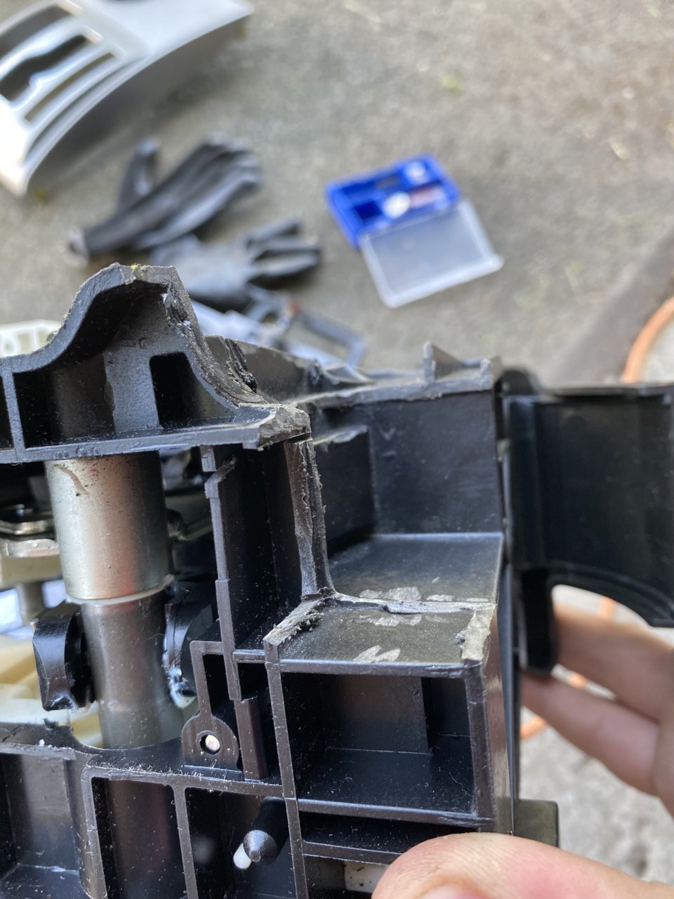

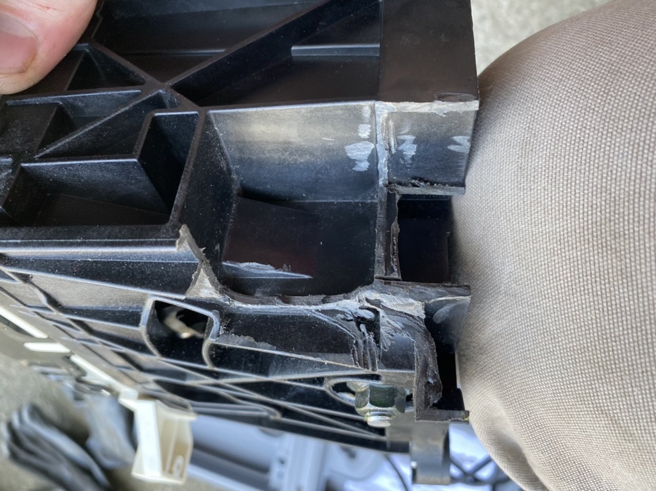

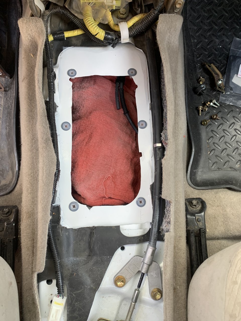

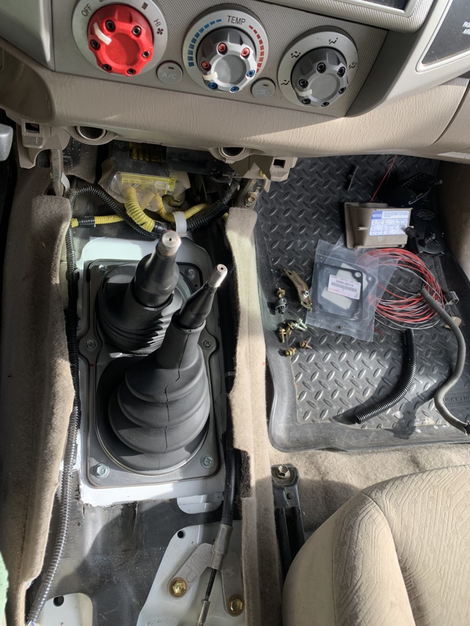

    Going to dump a few photos of what I cut out of my shifter to get it to fit. I had took guesses off others photos so figured I’ll contribute something and hopefully help someone out. BB7C0AA2-8EEA-4F09-B07D-1FE12EEC74FF.jpg361D731C-7244-4BAF-A7A6-95FD051BFA7F.jpg 040848E4-C3AF-4546-945D-CDC3B1E71713.jpg

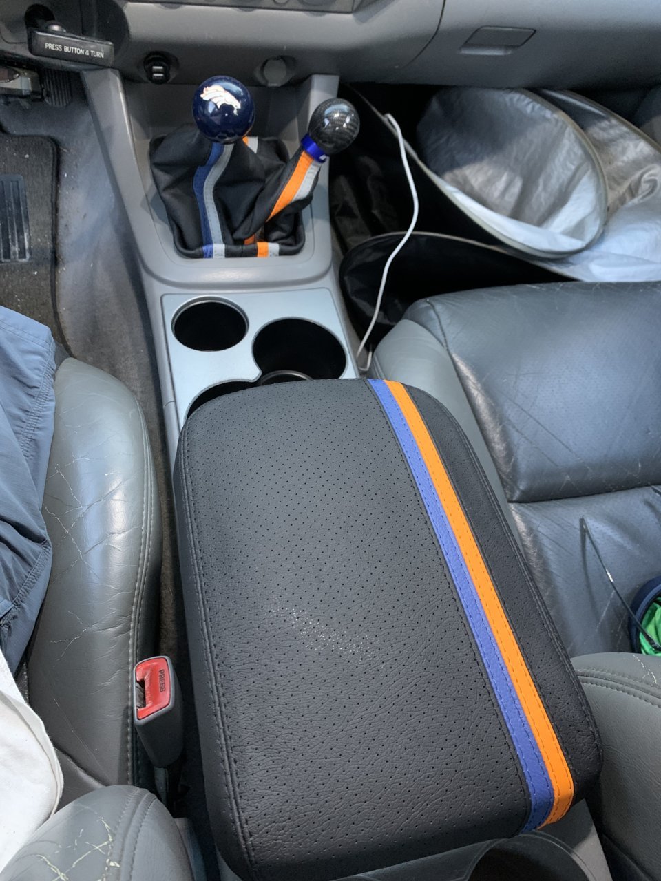

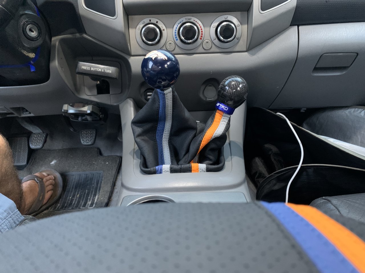

    Did you end up getting the shifter boot from Redline?
    dborrer[QUOTED] likes this.

    just need to get a leather boot and she’ll be done.

    Looks good, leather boot is over rated. I've been rocking Crown Royal brand shift boots for 10+ years and they have barely faded from that beautiful blurple color.

    Thank you. True but I am going after a particular look.

    I hear ya, so was I. The cheap ass DIY look LOL. One day maybe I'll pony up for a real shift boot.

    Yes, that is a Redline shift boot and center console cover. Turned out excellent, just took quite a while to get it. The Russian invasion had just started then and this is coming out of Poland where it is hand made.... so that could have caused some delay.
