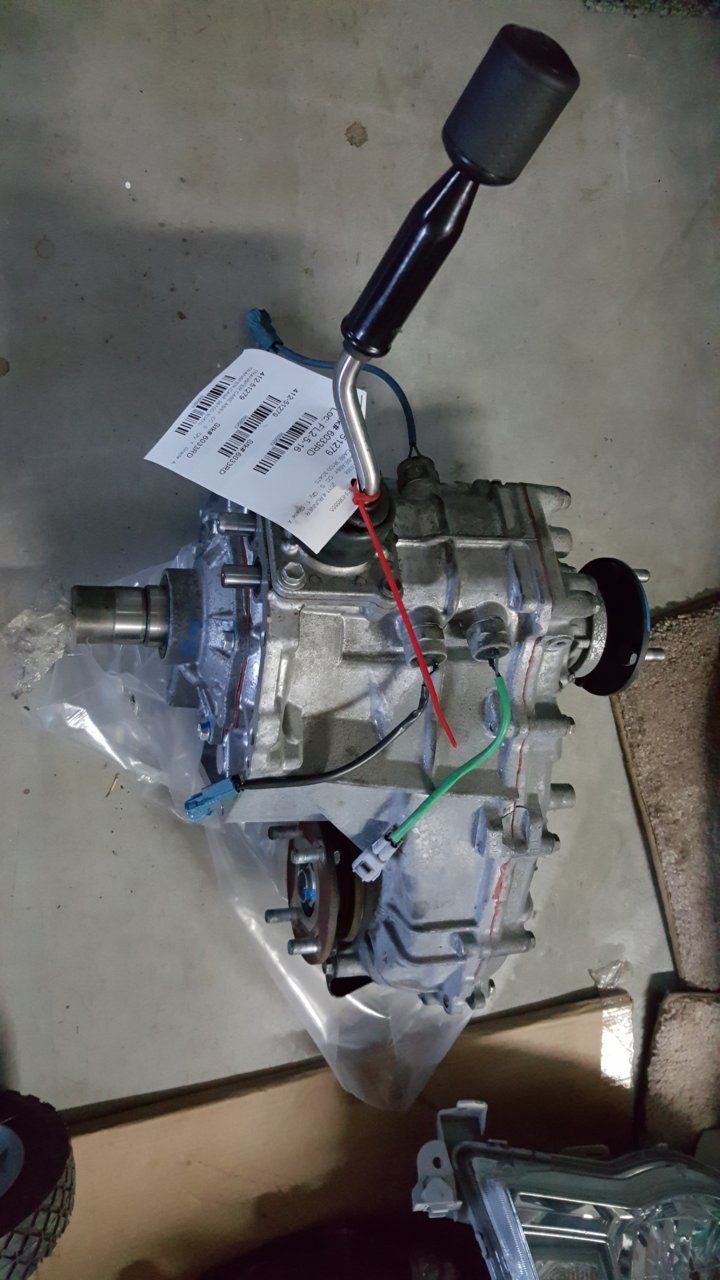

    That's kind of the easiest part, I'm not trying to be a dick but if you need you help finding the instructions this might be a bit much. I get that there's a lot of posts here but read through, you'll find a wealth of knowledge from some smart people that will prevent any missteps you may make. There are links to some build threads that have well documented how tos/installs.

    I do recall reading very precise write ups by RST a few years back before they deleted everything. They were very thorough with pictures and step by step instruction. Unfortunately I did not archive any of it. Wont be an issue for me anyway but I agree its more trouble than its worth.
