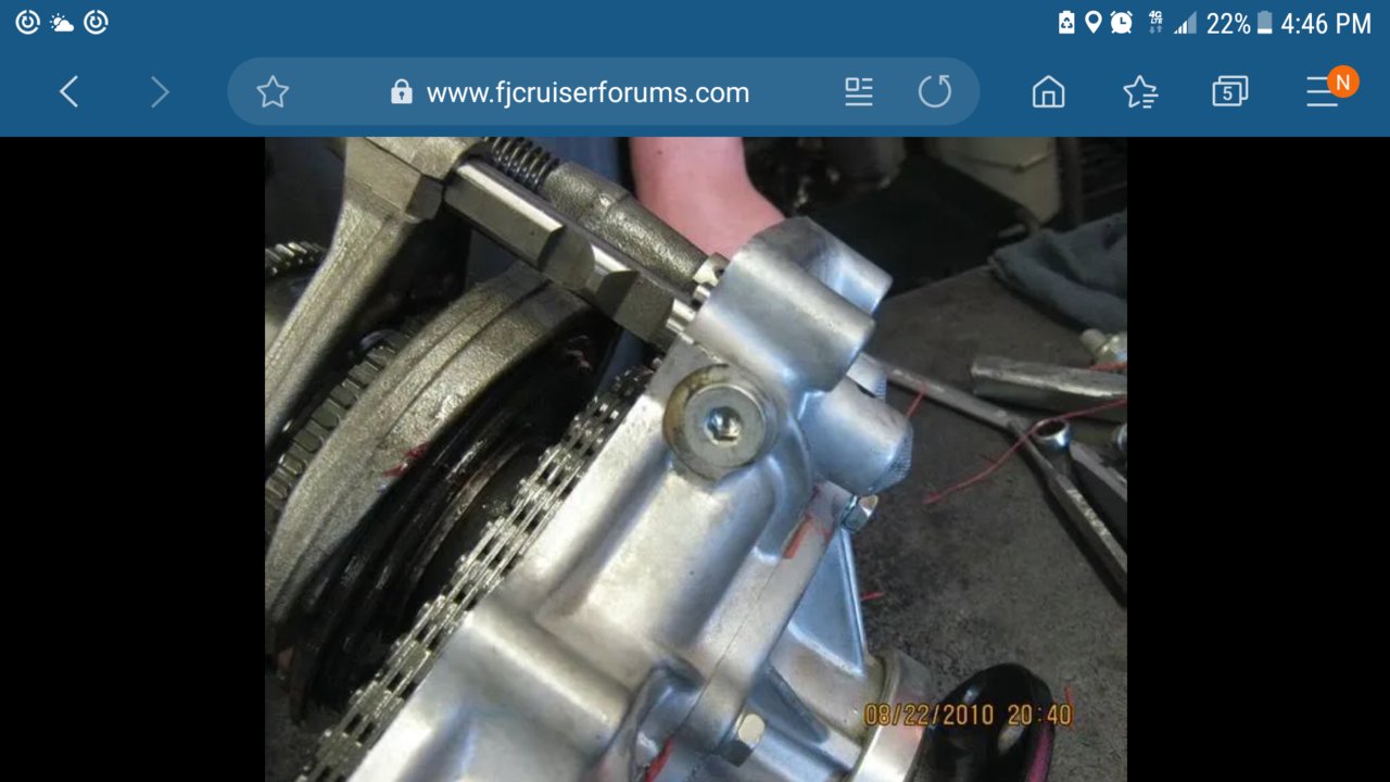

    I know... everyone has a different level of experience and know how.. I've been around the block, back in 2013 or so when tubbing your firewall back and doing a body mount relocation was the thing i did some reaserch a bunch of guys on here helped me out and gave me advise.. i ended up doing it on my truck and i had tons of guy pm'd me and asked for help and i was happy to help other.. thats the whole point!
    My thing was with the fj case. Where the keys come fromScreenshot_20200119-164836.jpg

    I found the write up on the fj forum a few days ago.. im skeptical about oppening the case and if the keys fall out having a hard time! I see it probably goes on the end of the shift rods... i think from pics

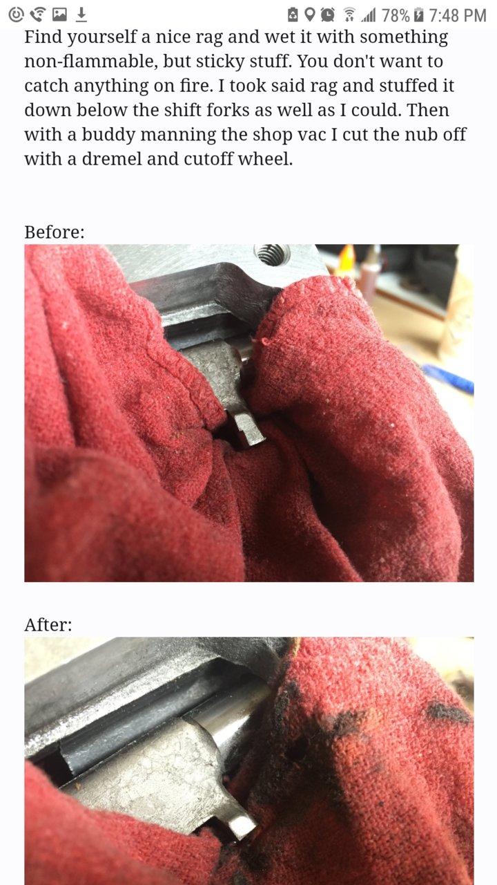

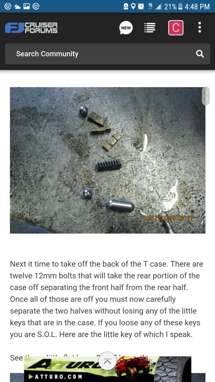

    You left the case in 2wd and oppened it all the way?.. no keys fell out? I seen a post on maybe t4r... i think and the guy cut the nub off from the top of the case covering the inside with a rag and then took the case apart partially just enough to pull the pill. Not sure how that works as far as keeping the case free or shavingsScreenshot_20200114-194802.jpg Screenshot_20200114-194820.jpg
    Its a nice shortcut.. but I'm too paranoid I would probably like to take the whole thing apart

    i wouldn’t go that route, that case exploded shortly thereafter.
    Edit: the keys fell out doing this way so that’s why it blew up lol
    https://www.tacomaworld.com/threads/smkytxns-build.237417/page-100#post-12649426
    TacoFMS and clupi[QUOTED] like this.

    Oh wow.. i guess its the reason you can't believe or follow everything you read
    Is that where the keys sit? On the back of the shift rods where the notches are?

    they are in the 2/4wd syncro ring
    clupi[QUOTED] likes this.

    No problem. The FSM precautions against losing these keys. Some people like to take short cuts, and haste makes waste.
    As mentioned, as long as the case is split in 2WD the keys remain captured by the synchro ring and shift fork.
