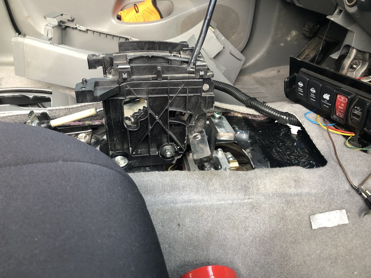

    What’s everyone doing to seal/boot around the trans tunnel hole for the shifter?
    Prerunner-4x4 swap on an automatic. Trying to see if I can find a boot that might be low profile enough
