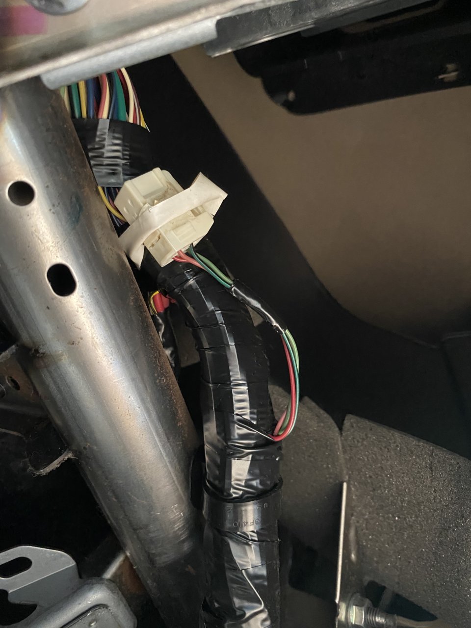

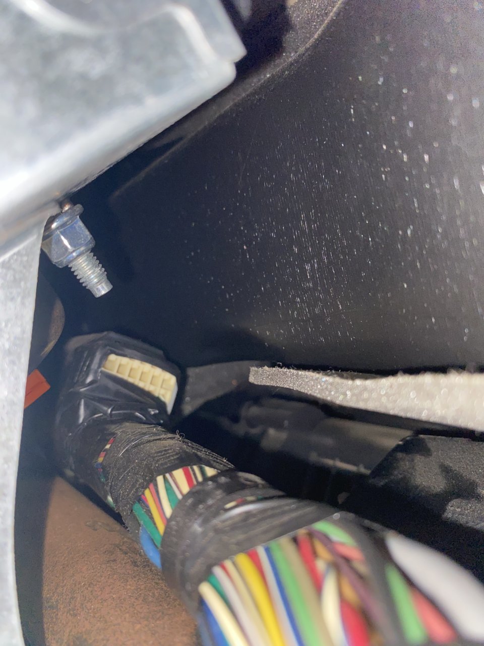

    check the pins and shape see if they match the f12 and f13 connectors.

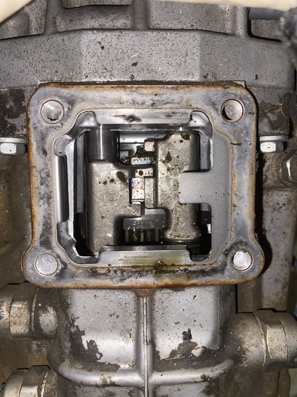

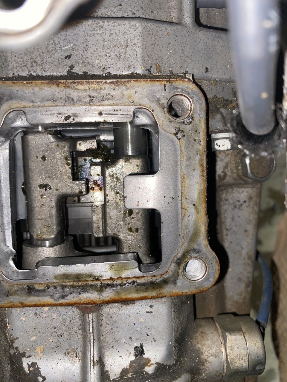

    Does anyone know the the orientation the shifter pins need to be in to correctly reinstall shifter?
    Mine look like this and its not shifting correctly after i reinstall it.
    Thanks

    There is no correct orientation. You just need to get it installed to match. Also, after I commented earlier, I had a harder time getting into 4hi and 2hi while the engine was running than not

    my shifter gets stuck in 4lo and neutral and takes a couple of reallllly hard shifts to get it into 4hi and 2wd. not sure why because it was smooth as butter before i messed with shifter. Ive tied every orientation and engagement in the shifter and it just wont engage like it did before.

    is everything installed in the truck?
    do you have a crawl box installed?

    everything is installed and no i do not have a crawl box

    i know sometimes the shift rails hit the adapter to the crawl box, and make it hard to get into gear, but since you dont have a crawl box, that shouldnt be an issue then

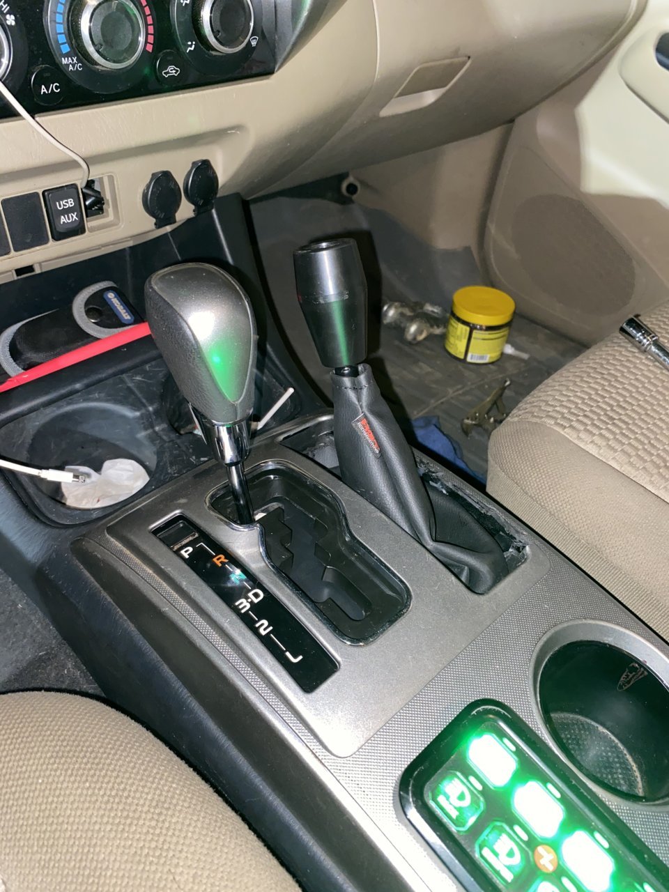

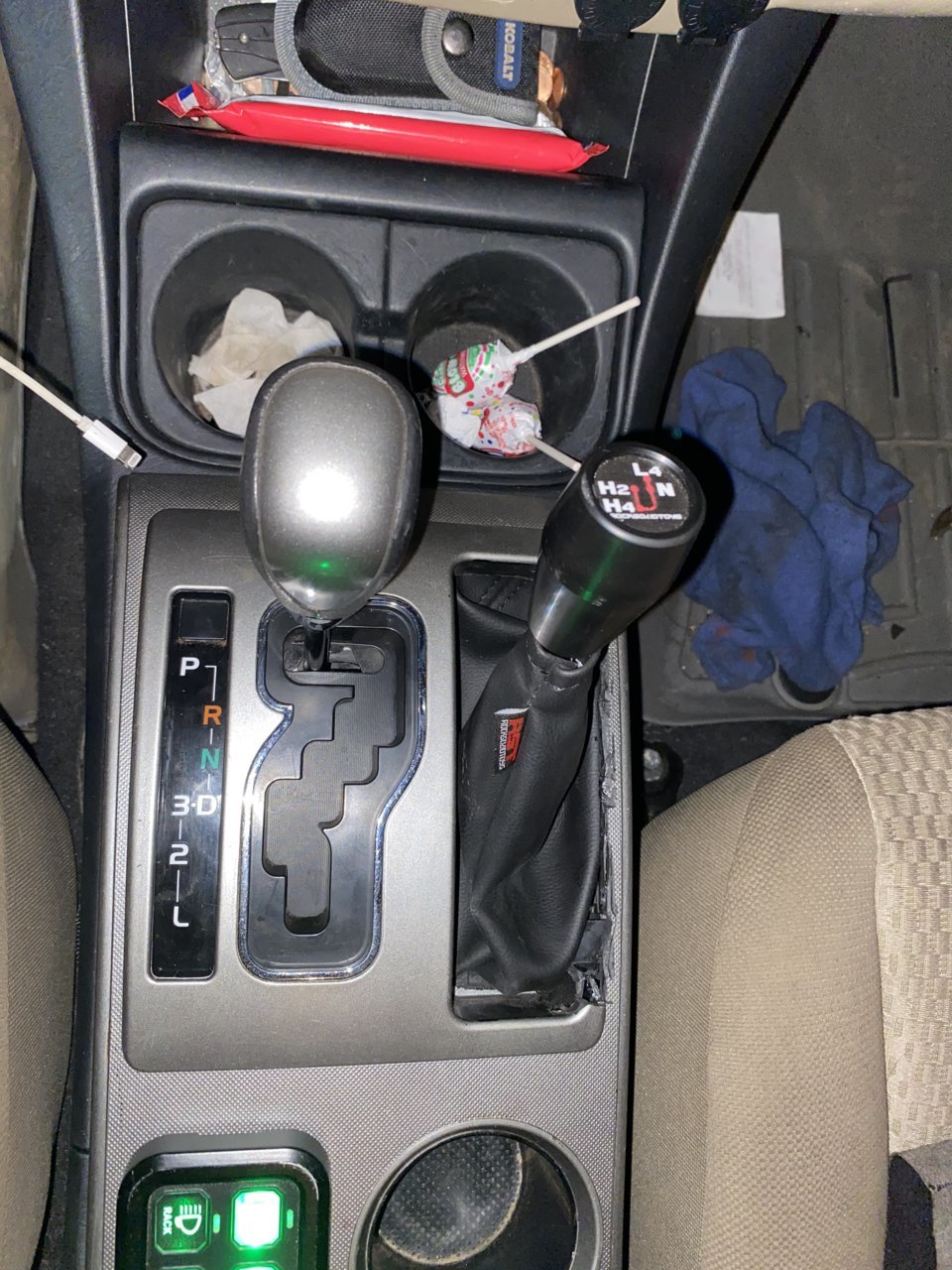

    What shift boot did you use for that?

    Rock solid toys. Knob and shift boot.

    Mine's all done I just need a boot to close up the hole

    My holes not completely closed yet but i used sound deading mat around the hole and will probably use the rest to close it up more.
