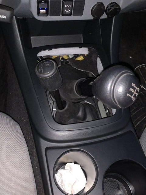

    Recall where you got that plain black shift ball for the crawlbox shifter? I am looking for some super basic black knobs like that that are small.

    Got anymore pics of how you sealed floor?

    No i don't but i used a universal boot and sealed it with butane cord against the tunnel and then used the AC duct tape on top of that.

    I used noico sound deadener and I actually stuffed an old tshirt in the console around an Amazon boot to make it quiet as possible. Dont want to hear it, its perfectly safe and it drastically cuts down on the sound and road noise. I also put noico under the truck in the transmission tunnel

    Ive got noico around the shifter now but its not sealed all the way around the hole. I was also thinking of doing the transmission tunnel. I just didn't know him to fit the boot around the hole.

    I put the boot down and used the noico as tape to seal it down. Driving with the windows up the noise is undecernable from stock.

    I used the boot from the FJ cruiser. It's a double layer boot and seems to seal pretty well without anything additional.

    I took an inner tube, cut it up, put a piece on top of the TC under the floor. Then another on top of the floor and shaped some thin aluminum to the floor and secured that with pop rivets. Over that is Gorilla tape. No leaks, no sound. Total cost about $0.05. Looks are a 2 of 10 but it's under the console so what does it really matter as long as it works. My shifter boot is attached to the console.
