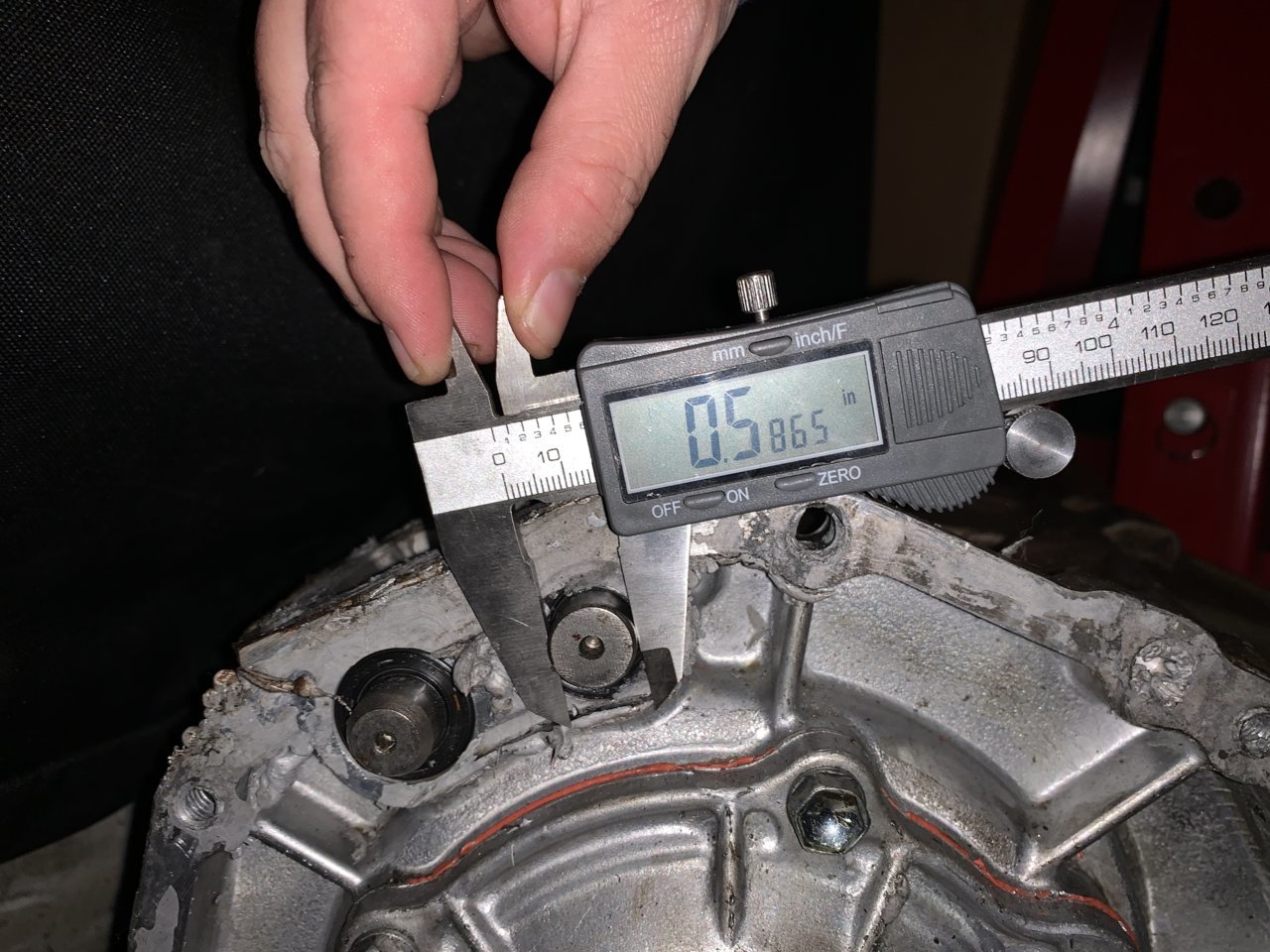

    Does anyone have an FJ tcase laying around that they can measure the diameter of the shift rods?

  7. Jan 19, 2021 at 12:32 PM
    #1367
    Littles
    Littles Stupid is as stupid does.
    May 14, 2014
    #129837
    3,432
    Bryan
    Elizabeth, CO
    3 tons of fun
    Can measure for you tonight.

    parts and stuff
    Gimme a min and I can do it now
    Littles likes this.
  10. Jan 19, 2021 at 1:25 PM
    #1370
    wrmathis
    wrmathis Dark Lord of the Sith
    Sep 10, 2008
    #9126
    9,462
    Bonaire, GA
    2006 Tacoma TRD OR 4x4
    parts and stuff
    This what u want?

    That's perfect, thank you! Building a template to help clearance the trans in the 3g. Hopefully it'll take a bit of the guesswork out. upload_2021-1-19_17-53-55.jpg

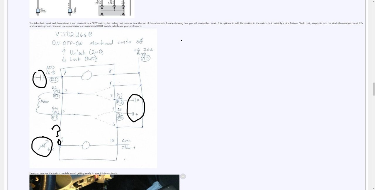

    how do i ground those wires and whats that other thing?
  18. Jan 27, 2021 at 5:38 PM
    #1378
    wrmathis
    Sep 10, 2008
    #9126
    9,462
    Bonaire, GA
    parts and stuff
    The question mark is the interior light switch/dimmer or a rheostat
  19. Jan 27, 2021 at 6:54 PM
    #1379
    6 gearT444E
    6 gearT444E Certified Electron Pusher
    Feb 3, 2018
    #243372
    7,798
    Deep South
    Herculiner Hootus
    they are already connected to ground through the stock harness, if your truck came as a prerunner you just tie other end of the switch to the chassis somewhere. That “other thing” is the variable ground for the dimmer rheostat
