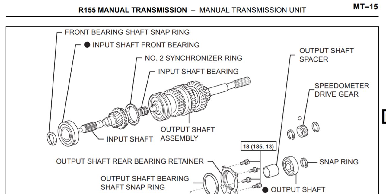

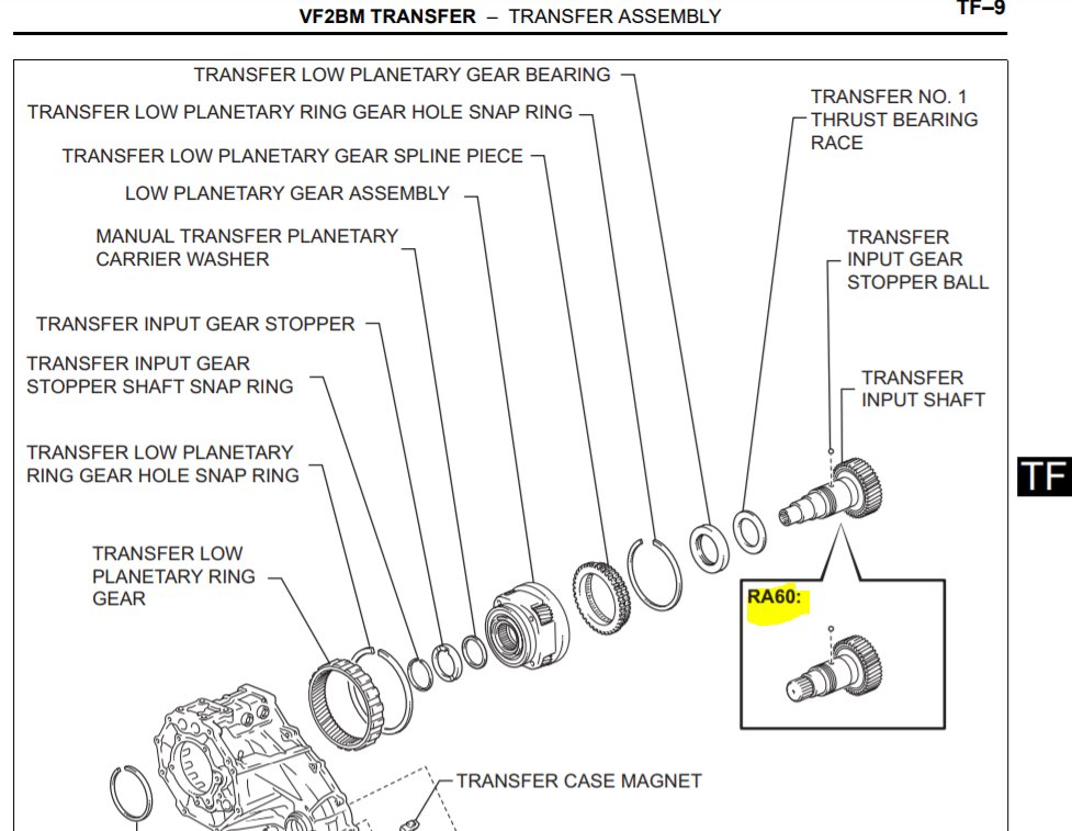

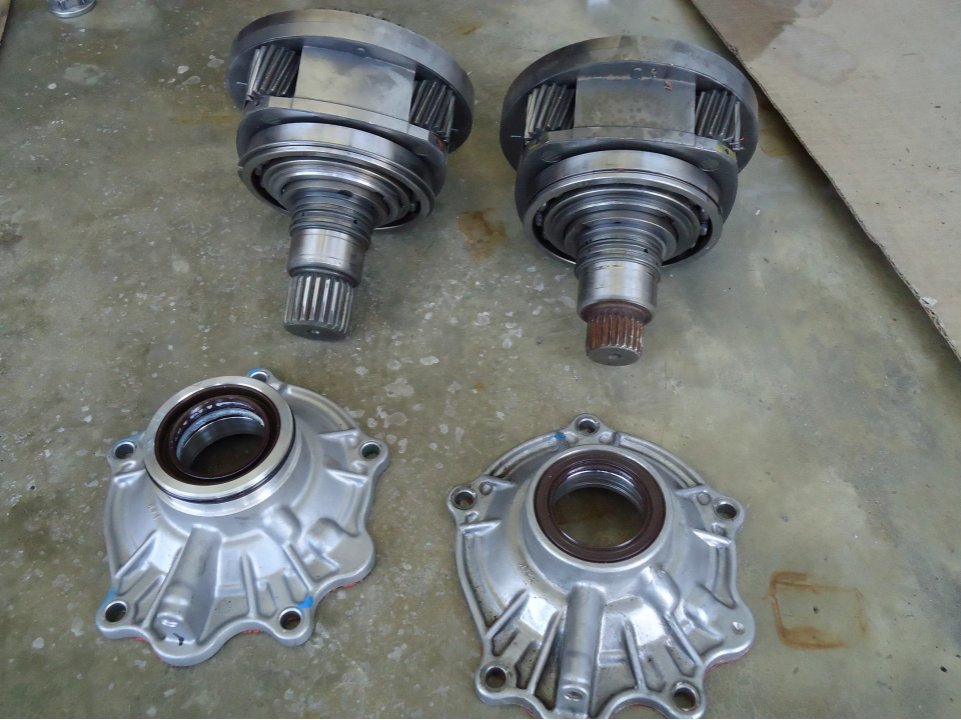

    Yes, 23 spline. Should be the one on the right in this picture

    depends. the fj cruiser had a male transmission output. thats why fj cases come with a coupler on them most of the time that has to be removed for the tacoma

    What Ryan said, stock it will come with a female-female coupler on the input shaft due to the output shaft of the FJ transmission being male. On the 6 speeds, the output shaft is a 22 spline female so no need for a coupler. You need to press that coupler off to install in our trucks.

    never had a 5 speed removed so couldn't tell you. But looking at the parts it appears has a male output. Attach is the relevant documents, should be pretty obvious once you remove your stock case
