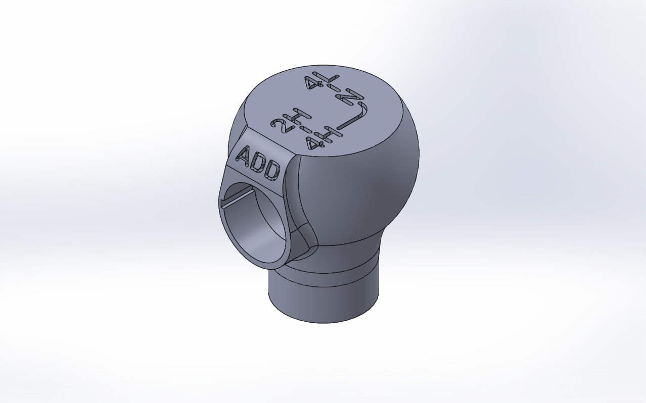

    My plan is to 3-D print my design and incorporate it into a slightly different harness than the ones most folks are using where the knob accepts a generic round switch. My challenge is finding a way to wire it the way I want to (using a relay instead of just one switch).
    If anyone is interested I can send them the STL file to print it themselves

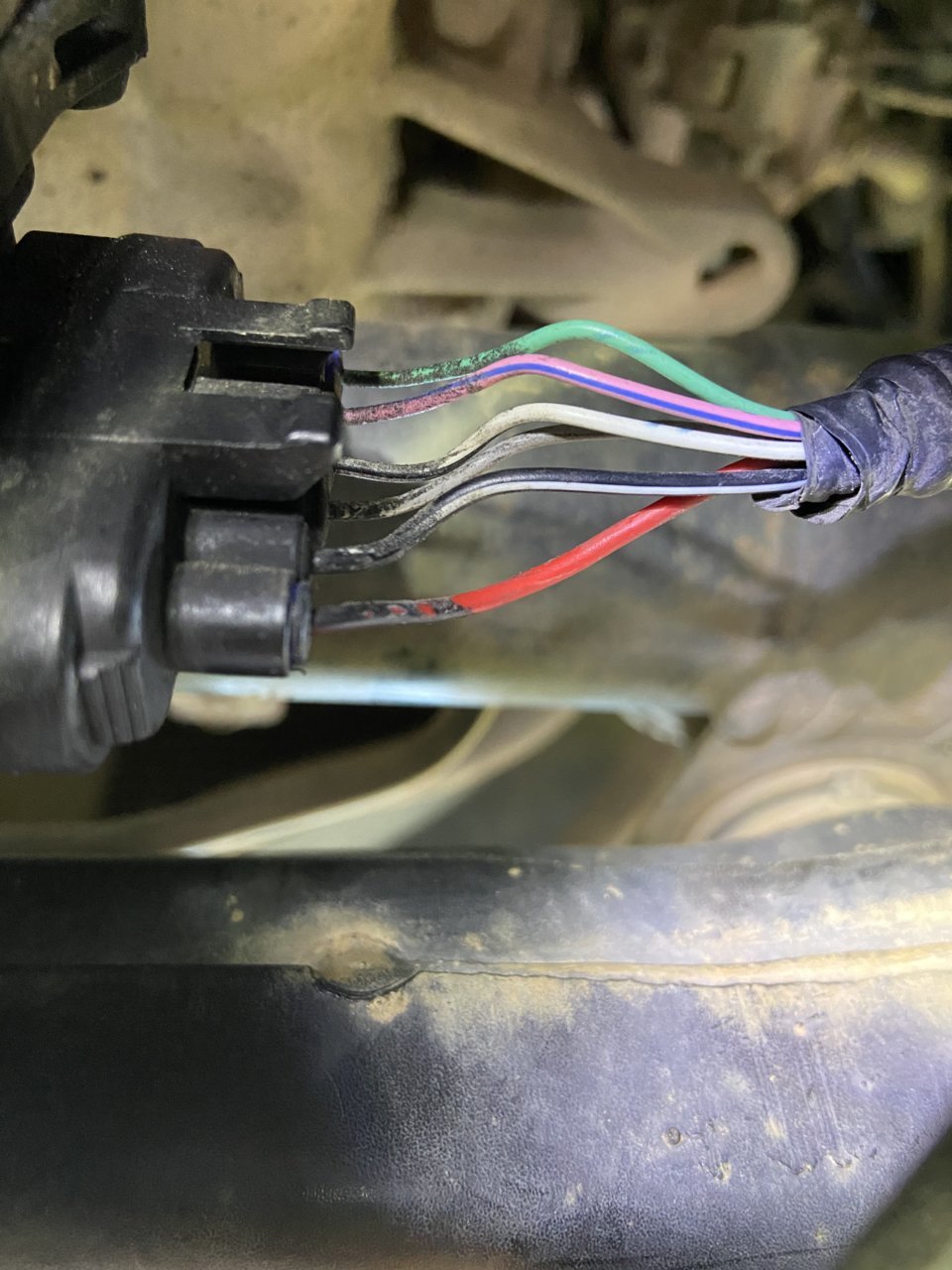

    This write up is really good but I think my switch is different. Can anyone help me figure out where I need to put my wires? I’m lost. I know 7, 8, 9, 10 will be regular 12v power and grounds. I will be splicing into my add wires. Ignore my writing it’s probably wrong

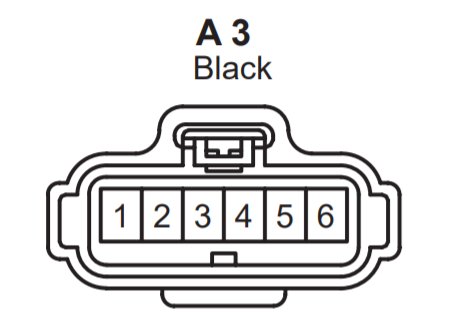

    Definitely the same, it's very simple to not even think about it and wire up as follows:
    Switch pin # - ADD side
    1 - keyed +12V
    2 - Red wire from ADD connector Pin 1
    3 - Pink/Blue wire from ADD connector Pin 5
    4 - Light Green wire from ADD connector Pin 6
    5 - Black/White wire from ADD connector Pin 2
    6- keyed +12V
    7 - Light Green/Black wire from ADD connector Pin 3
    8- keyed +12V
    9 - Illumination Negative
    10 - Illumination Positive
    This is looking "into" the ADD connector for the pin designations.

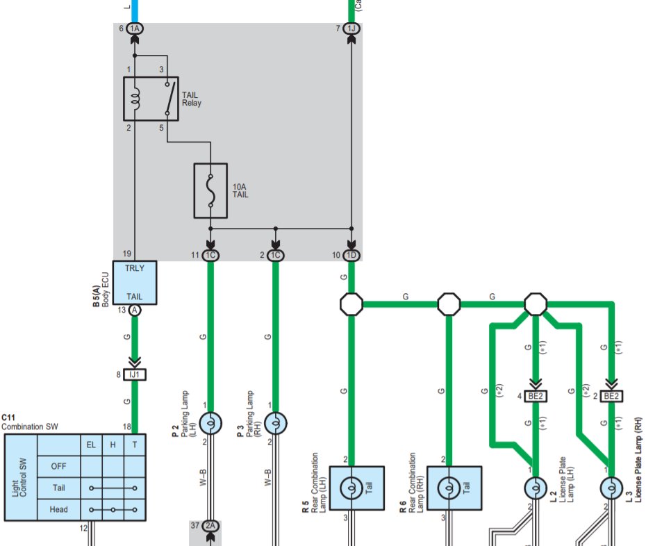

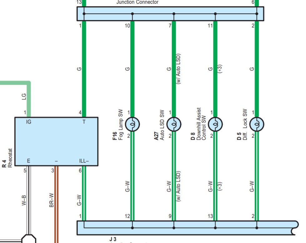

    For the illumination, you can either hook the negative up to ground and the positive to the tail circuit, you'll get LED to come on constant brightness when the headlight position is in the tail or headlight position.
    OR
    you can wire to the dimmer circuit to be able to dim the LED with the stock dimmer; in which case the "negative" circuit is any Green/White wire and the positive is the green wire, tap off the rheostat switch or any other illumination wire.
