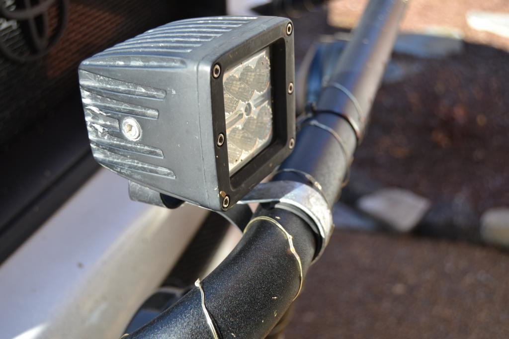

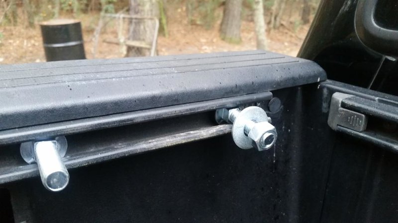

    Some fence part + a moving rubber band= tube light mounts :D

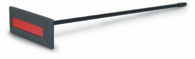

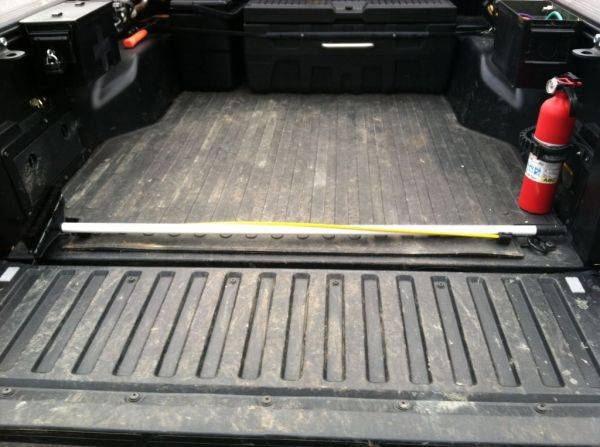

    Made a snow brush out of the leftover broken end of the same scraper I used for my cargo net and a paint roller extension pole. Took off the rubber squeegee and it has a nice sharp edge for scraping. We will see how she performs if we ever get any decent snow. :rolleyes:

    Can ya spell Tonneau
    I like it. Snow Rake!

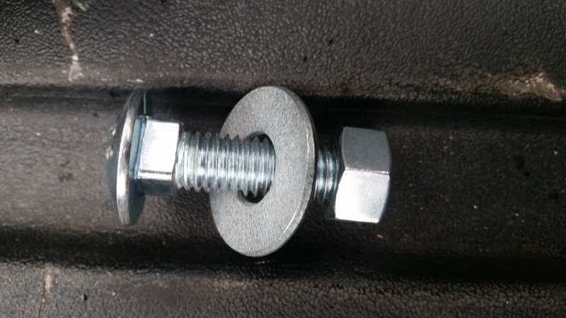

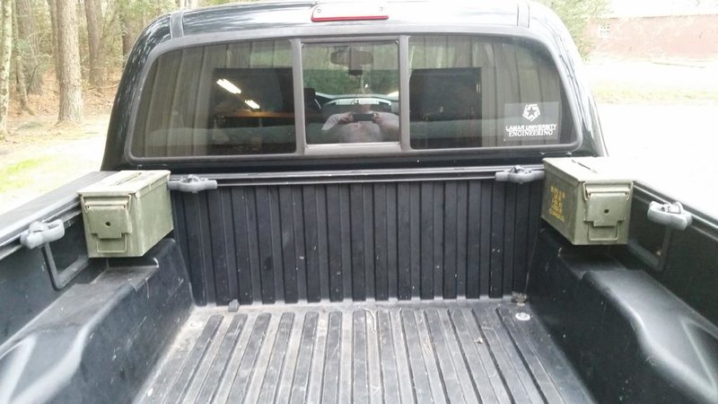

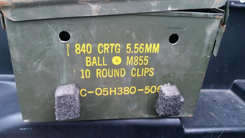

    Finally did the ammo box mod! Not as frugal as some of these but it was completely DIY and as cheap as I could do it.
    Materials:
    1/2"x2" carriage bolt (4)
    1/2" washer (4)
    1/2" hex nut (4)
    Subtotal: $6.00 from local family owned hardware store
    2 military surplus ammo cans
    Subtotal: Around $25 each from local GI surplus
    Foam spacers: Free, lying around the shop
    Total: 56$ plus a lot of gas and about an hour of my winter break.

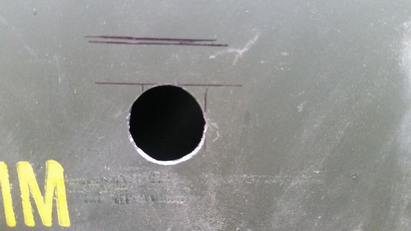

    First I cut a 1/2" hole as high as I could (right below the lid) using a 3/8" pilot bit. Had to wallow it out to make up for the size difference. Next I just mounted them up and realized any weight in the can would create too much bending moment about the bed rail, and they are weak enough already so I used a hacksaw (overkill) to cut out some foam spacers from some sort of roof accessory foam we had and glued them to the outer side of the box to support against the side of the bed. It sits a little high but that was the best I could do without grinding the lids. It can be jiggled up and down because if I pulled the carriage bolts far out enough to where their squares were snug in the channel (boxes not movable in this position), they created a non level mount that looked poorly done, so I pushed them back into the bed rail and now they are close to level at the expense of some wiggle room. They will be unmounted and patriotically painted soon :)
    I know this has been done a hundred times but I think I am first to address the bed rail stress issue. Hope this helps somebody! Next is fishing rod/flag pole holders.

    Lookin' good. I added some support to mine also. Used some plastic and stuck it on with double sided tape. You may want to think about removing the handles and that piece by the lid pull. They will be rattling like a mofo. :D

    ammo cans look great! This is next on my everlasting list of mods to do. Really like the foam idea so they are moving around too much as well. Keep up the good work!

    I would have liked to use something like that too, I might "upgrade" it later when I paint them. As for theverything handles, I was expecting to remove them because I remembers your advice from a while back. Surprisingly, they haven't rattled....yet!
