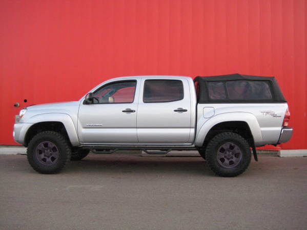

    Here's how it would look on your truck:

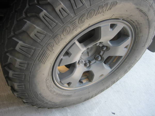

    Here are some dirty pictures after a trail run.

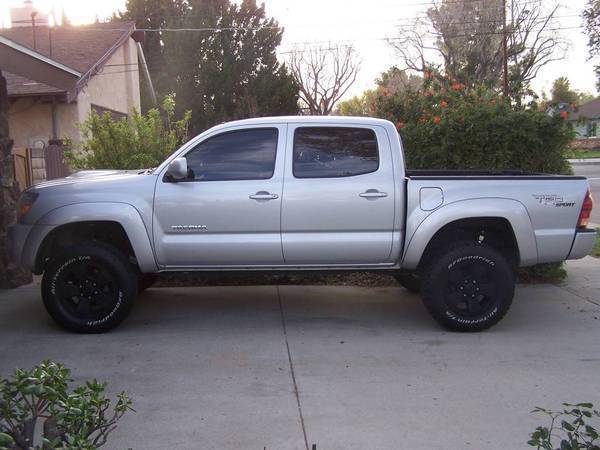

    db67fm and Evilmonkey, what kind of paint did you use exactly? Looks good charcoal instead of the full black.

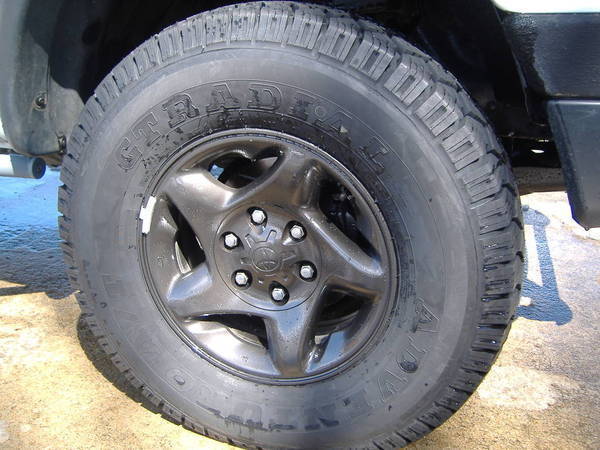

    not stock wheels but still a rattle can paint job none the less.. dont think i have any pics of em on the truck...
    rustoleum satin black paint...

    no... satin is around the middle point between flat and gloss.. you can see in that pic that there is some shiny to the wheels but not alot.... i think its the best finish as gloss is to bling and flat is kinda blah and hard to clean...

    no actually i think it is less than semigloss... you can find rustoleum and krylon in satin black pretty easily.. i think around here they sell it at wally world and lowes...

    all i did was take the wheels off, wash them real good using regular car wash but instead of using a wash mit i used steel wool to scrub them with. that way i was cleaning them and scuffing the surface at the same time. after they dried i stuck index cards around the edge to keep from painting the tire and started spraying primer.... did two coats of primer and then two coats of satin black.... i let them sit overnight after painting before i bolted them back on.
    its been acouple months so far and they are holding up perfect.. but i figured i would tear them up offroading so it will be no surprise to me when i have to touch them up.......

    2 coats of Rustoleum Sandable Primer (black), and 2 coats of Rustoleum Professional High Performance Enamel flat black.
    The pictures show the wheels very dusty.
    Here is a crappy cell phone pic from when I was painting them.
