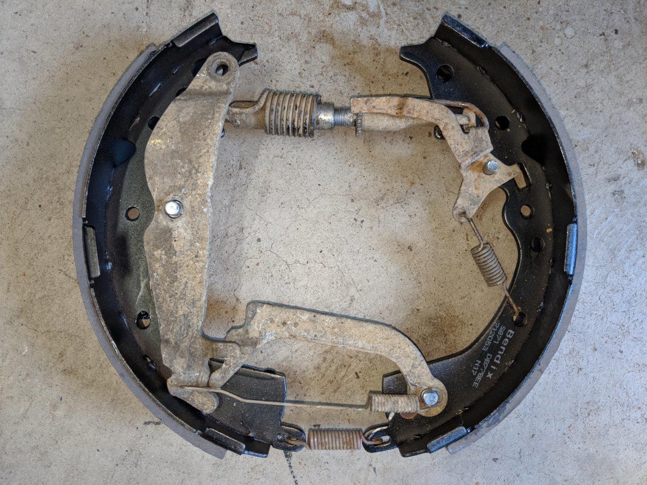

    Have you done rear brakes before? I'll post some reference pics.

    Thanks for the beta! Been several years since I did drums...I think the last time was on my 70 Bronco. Any photo and/or coaching is appreciated!

    Yea seems IF people have done them at all in the past that they're a bit rusty. Last time I did my brakes I laid out the parts on the floor specifically to post up here for reference. Hope it helps. It's always good to snap a few pics of your own before you take it apart.
