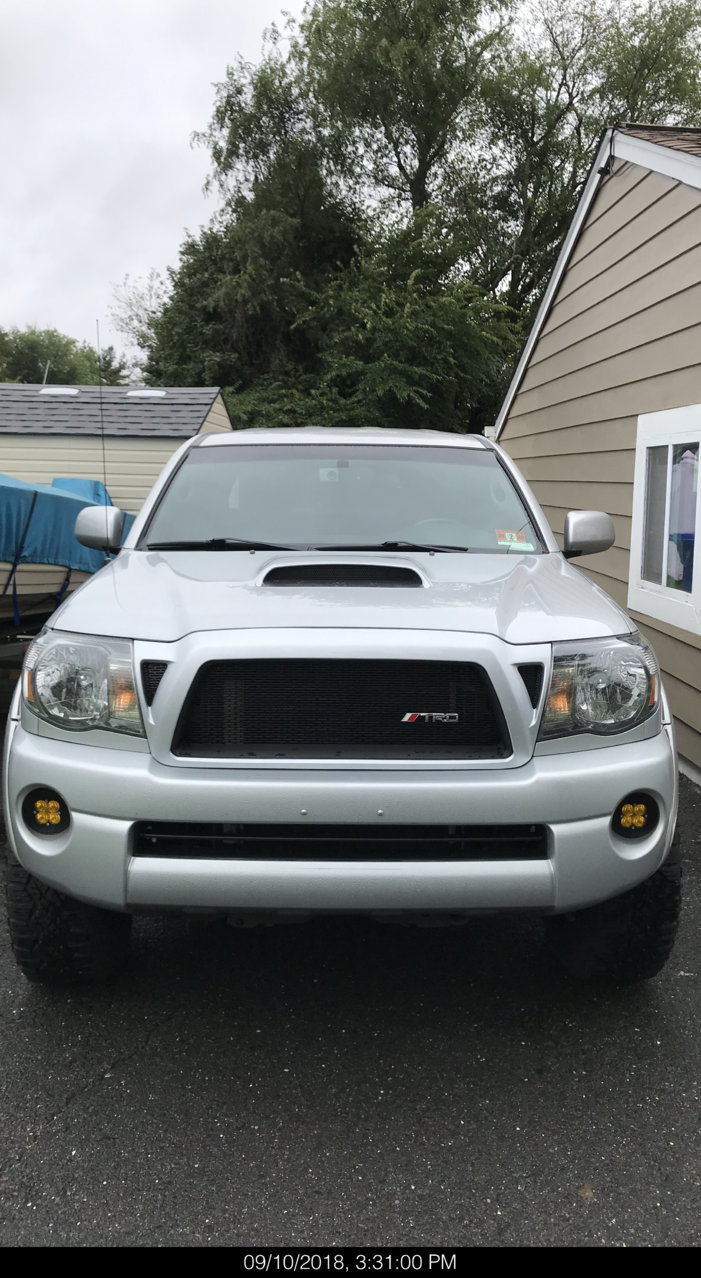

    I have the baja design wide cornering. And i can tell you that they are the best light I’ve ever used. I have them aimed down and they throw an impressive wide pattern. Yes I know they aren’t dot approved but I don’t run them all the time. Only when its dark and raining or foggy 9094C3D6-77E1-4A84-A8BC-640A7DC7B846.jpg

    So you only blind others when it is dark and rainy, thoughtful. Those lights illuminate the 3rd story of my house from 25' away while actual fogs keep the beam 2 feet off the ground with hard cut offs. No amount of aiming them down will solve the issue.
    Flood are also not an acceptable pattern for street use and will equally blind other oncoming drivers. Not being flashed is a terrible indicator of not being blinded. You should use the SAE model if running them with other traffic on the road. You can use the covers if you modify the brackets, I've done so here:
    https://www.tacomaworld.com/threads...fog-light-review.554813/page-10#post-18510065
