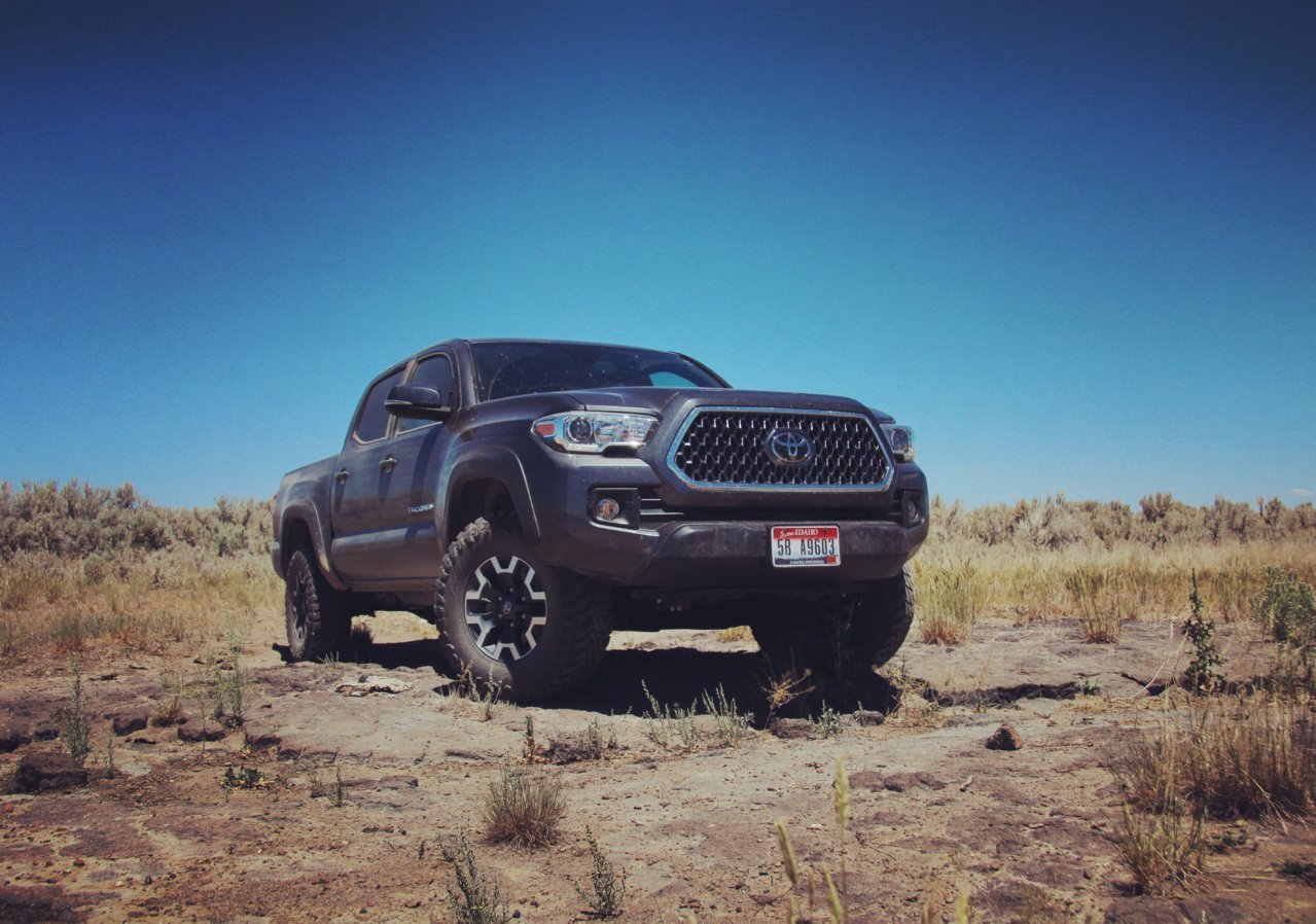

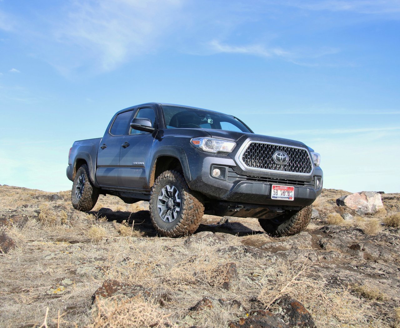

    Please forgive me, I'm sure this has been covered before I just can't find what im looking for.
    I have a 2019 dcsb TRD OR with 265/75r16 tires. I purchased a set of Bilstein 5100 shocks for the front to level it out. It appears that everyone else on planet earth that has put the 5100s on the front has also added either a block or leaf in the rear leaf pack. I'm not interested in lifting the rear of the truck at all.
    According to my measurements the front of my truck is almost 2" lower in the front. So if I put the the clip in the 5th notch the truck should sit level, right? The only problem is every picture i can find is a 2"/1" front/rear lift and it looks level. So what gives? Do I need the 5th notch or 4th notch?
    Is there anyone on the forum that has only lifted the front of their tacoma with the 5100 and what notch did you use and what have been your experiences?
    Thanks.
    Any pics of a 2" front only lifted 3rd gen would be awesome.

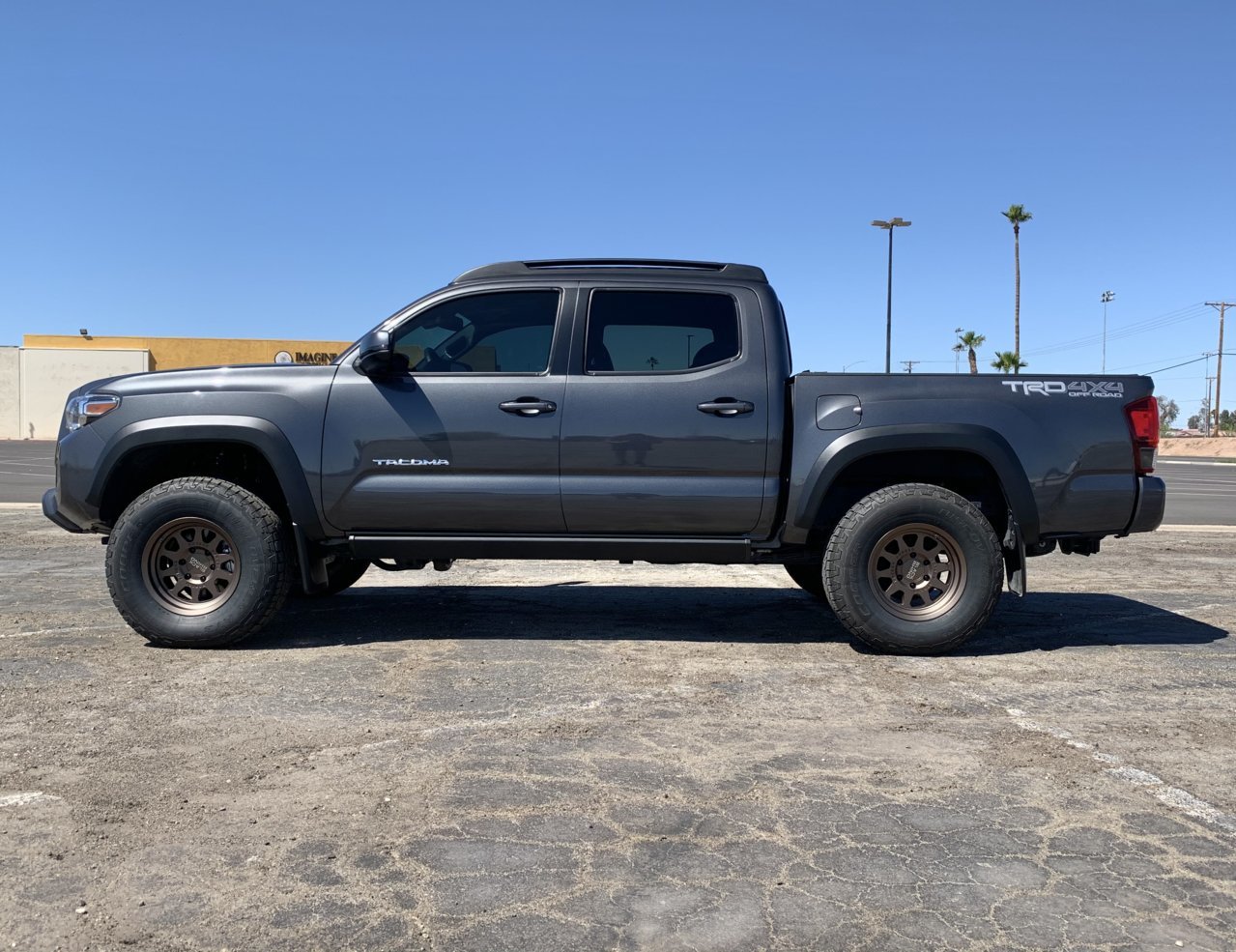

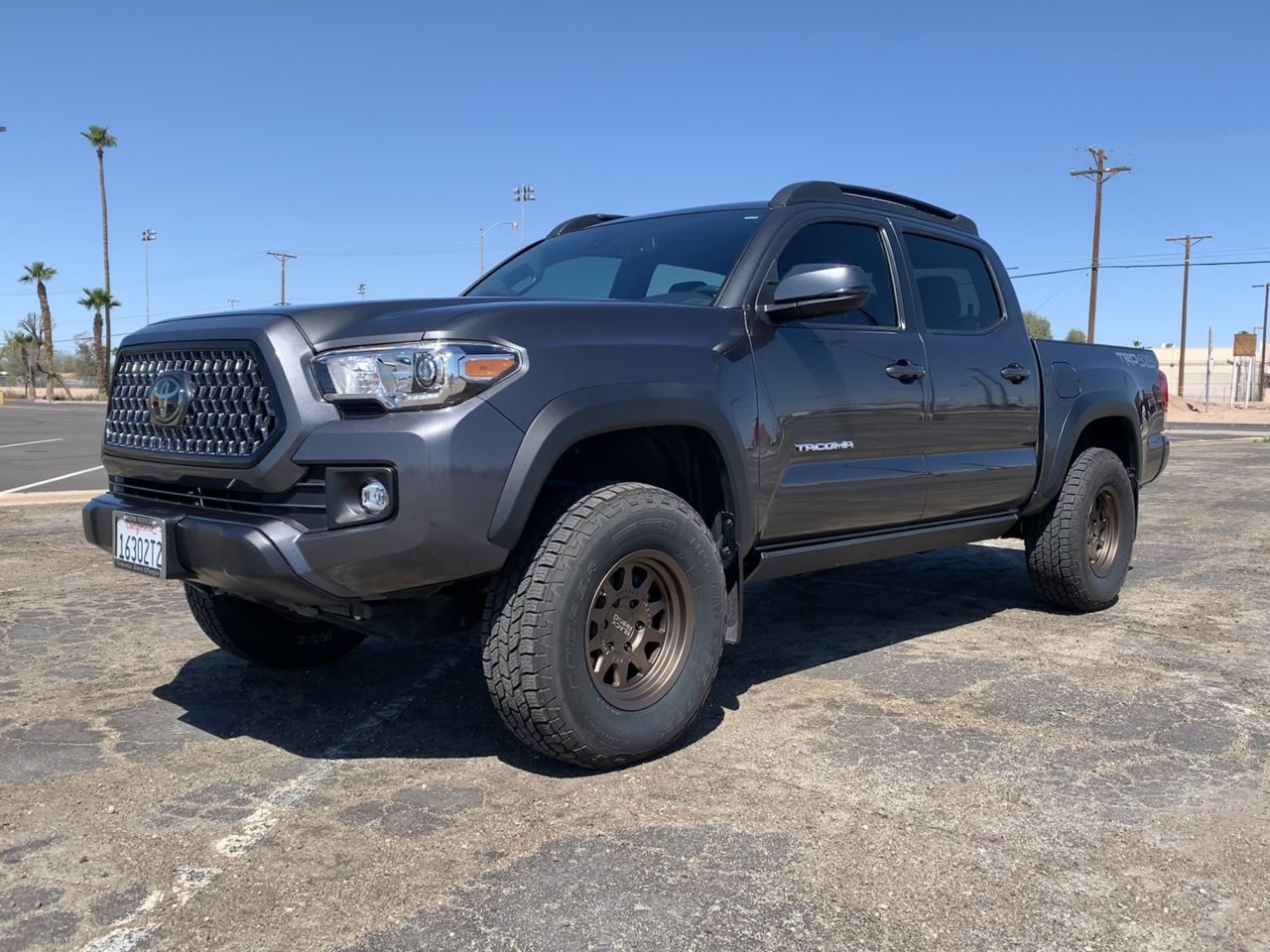

    I have a 1.5” level on mine and nothing in the rear. The front is a little over a 1/4” taller.

    .75" spacer in front.

    Just depends on the spacer thickness. I wanted to be a little higher in the front and did not want to have difficulty aligning it so I chose that size.
