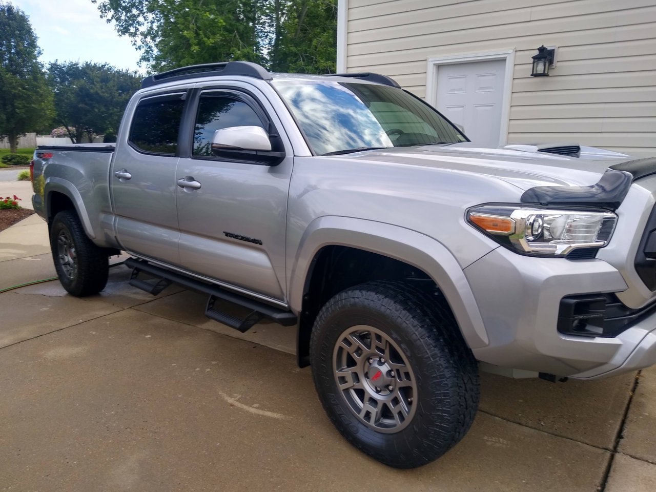

    265/70s on 510IMG_20210625_075834687_HDR.jpg 0s and a block. Ride is great, been this way since 3500 miles and sitting about 25k. No issues! IMG_20210625_075834687_HDR.jpg

    What setting are your 5100s on? And 1 inch block?

    4th perch with a 1/4 shim on the driver's side.

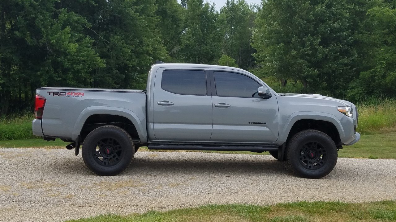

    1" spacer up front, giving, 2" of lift, 1 inch block out back, to level. kinda wishing I went with 1.5" tapered in the back, for a little more rake. it does sit level empty but, throw almost anything in the back... and the rear will be a little lower than the front. 265/70/17 toyo Open Country AT3's mated with sema wheels. Ski

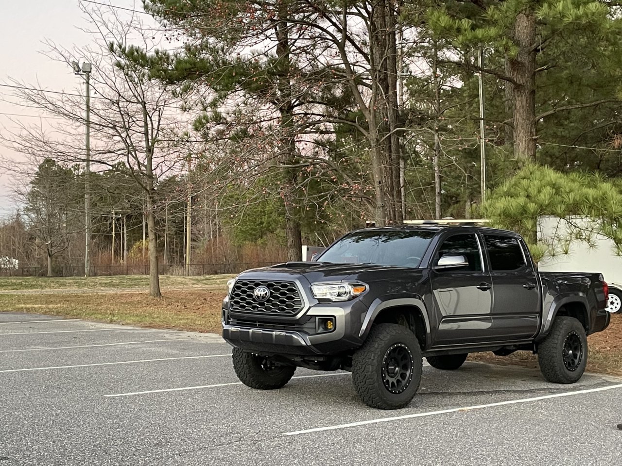

    Since my post was bumped and I love the new look…
