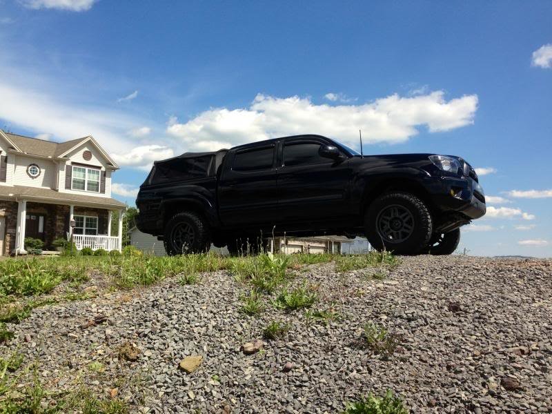

    Front is 5100s set at 1.75 with toytec 1/4 spacer on drivers side. Rear is stock 4 leaf (including helper) with 5100 shocks. It's a little nose high. Was thinking about the toytec 1 inch block for rear. This Is that a good idea? Should I do the 1.5? Will I get any vibrations?
    Here is truck
