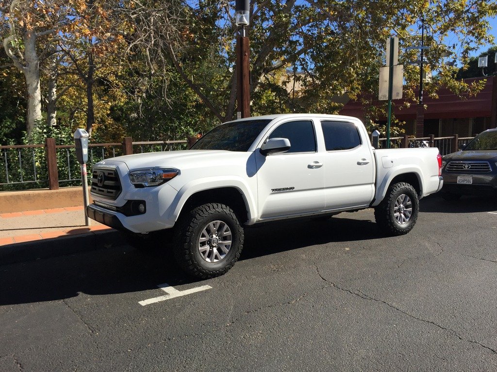

    1,309
    Upland, CA
    Here's a pic when I first had my 5100s put on set at 1.75 up front and stock in the rear. Since then I've brought them down to .85 and swapped out the wheels. 1.75 sat a little nose high for my taste. .85 is perfectly level.
