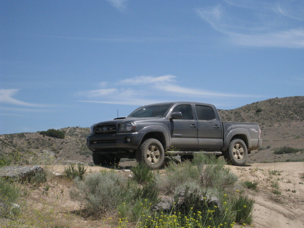

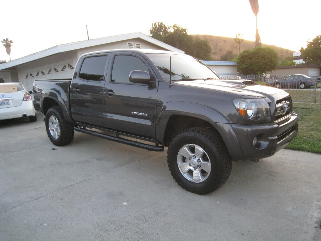

    Too many to list. See build page. Link in signature

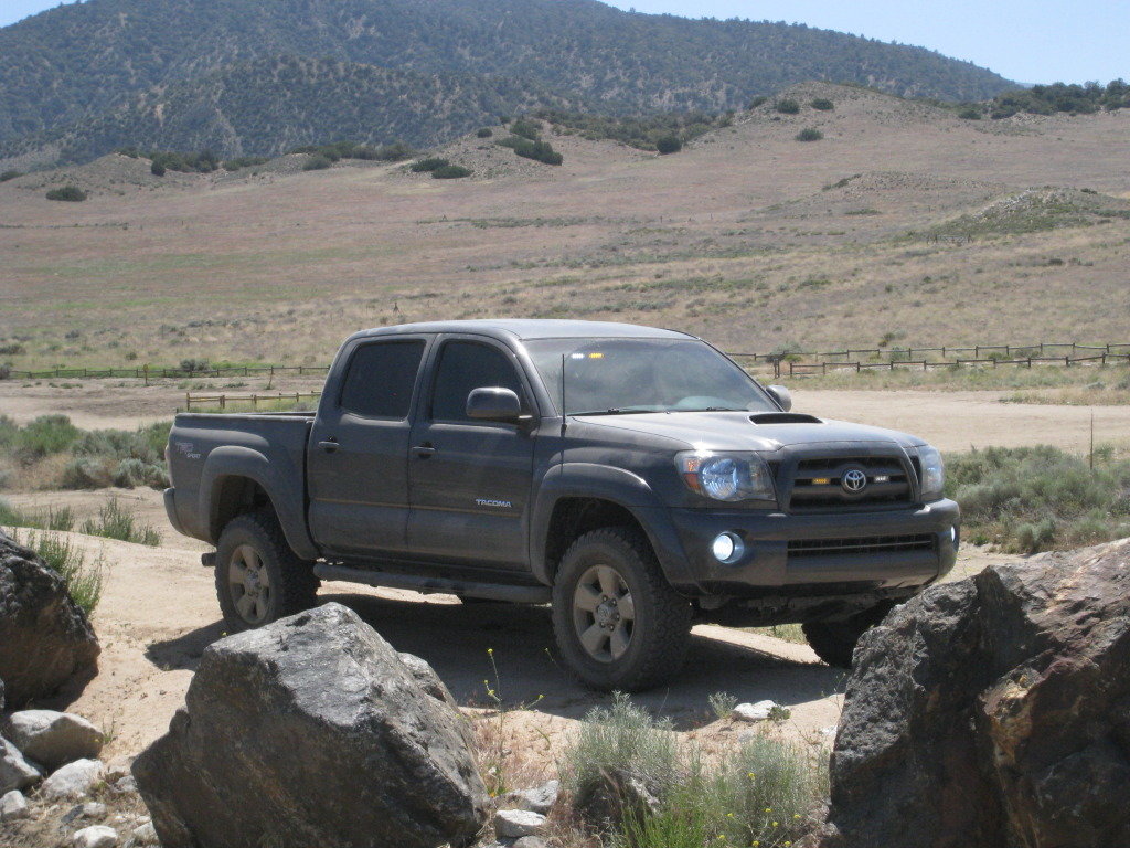

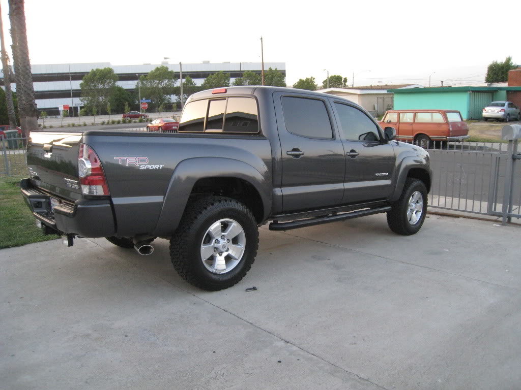

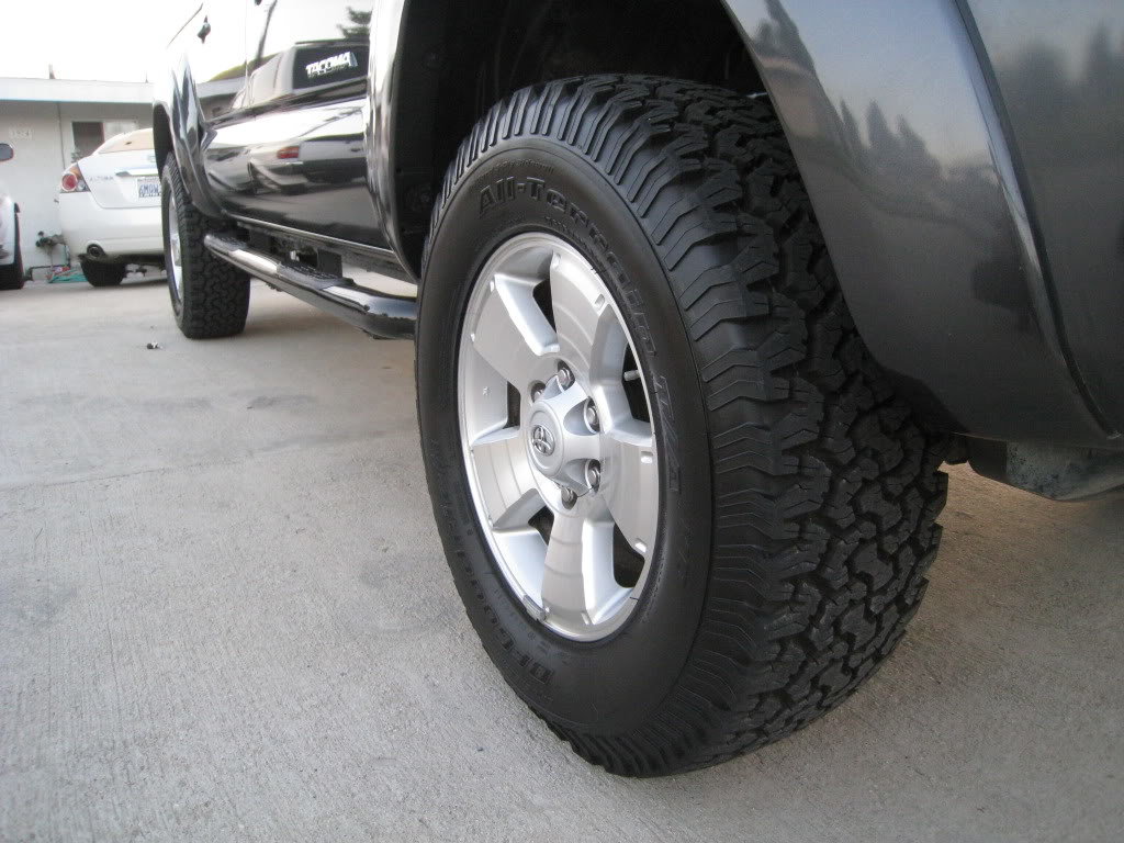

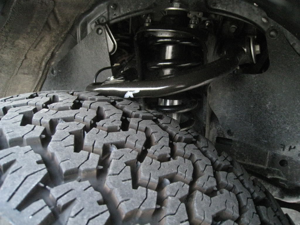

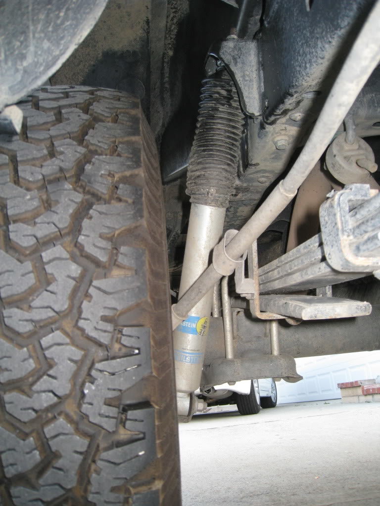

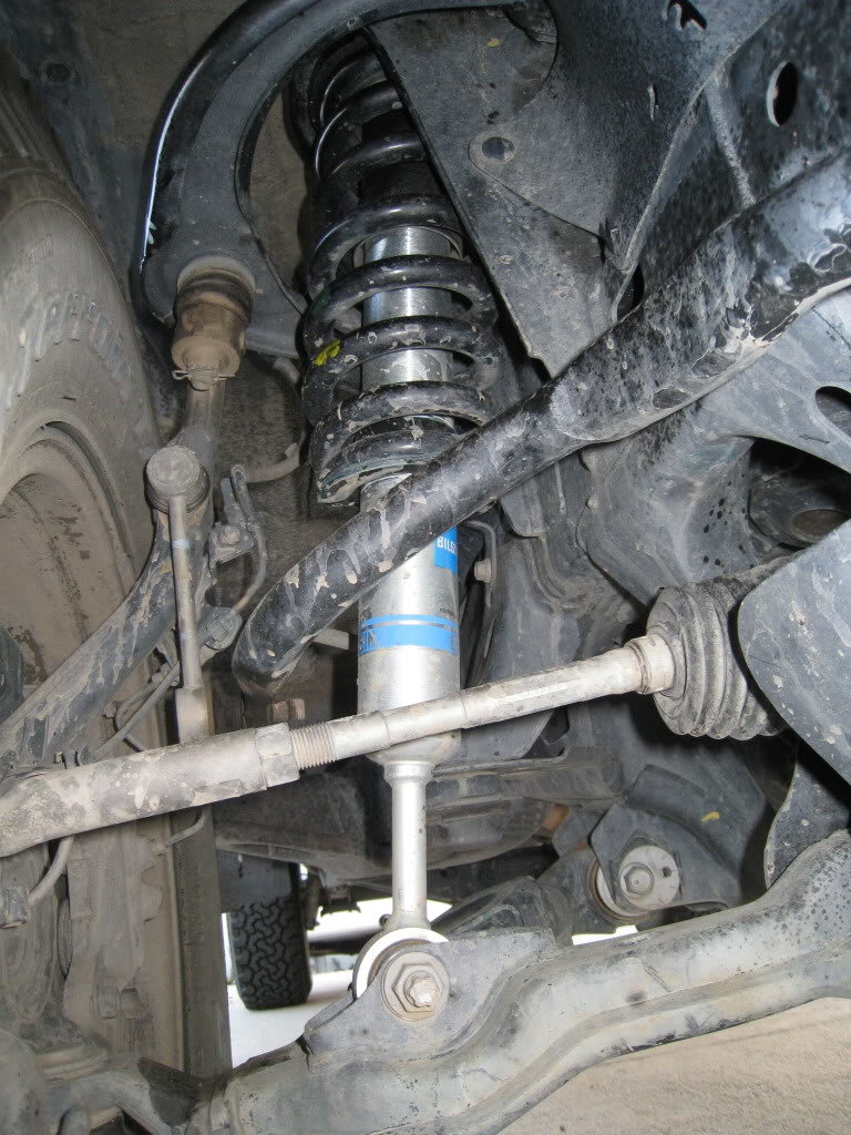

    You can find a picture matching your description somewhere in just about every thread on this site im sure. Mine is not white, and my wheels arent black, but this is mine anyways. REAR: TSB Springs in back dealer installed with standard length 5100's. FRONT: 5100's set at 1.75'' with stock coils. All other suspension is stock. TIRES: BFG TA KO 265/70/17 with no wheel spacers, very minor rub on LCA at full turn.
    These last 2 pics have some decent flexing so it doesnt look level at all, but its exactly level on flat ground.

    The 5100's are adjustable so they will lift the truck various heights depending on what setting you put them at (.0", .85", and 1.75" IIRC) and if you stick with stock coils or get aftermarket like Eibachs. Some people who want the full 3" need UCA's and some don't it is a shot in the dark really. To lift the rear some people just get the TSB AAL, AAL, or a entirely new leaf pack. It really just depends on how much you are willing to spend.
