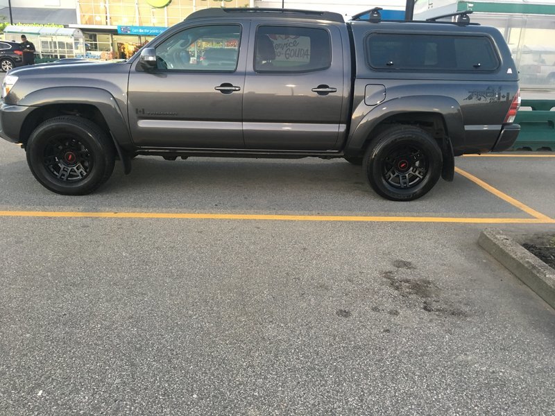

    I have a 2015 Tacoma short box with a canopy and bed mat. I often pack both mountain bikes and street bikes when it is not being used to and from wk. The truck sits near level and slightly ass low with small to medium loads. Rarely do I tow a trailer. I am looking to raise the rear back to stock height. What would you recommend???? After hours of research I am leaning towards toytec 1.5" add a leafs. I will be lifting the truck in a year to year and a half and will be replacing leafs at that time. Any and all suggestions welcomed, and any one with pics of stock trucks with this add a leaf installed would be apreciated. Wondering how much rake I will end up with! Thanks in advance
    Current measurements
    Ps rear 21 5/8
    Dsrear 21 1/4
    Ds front 20 3/4
    Ps front 21 1/2

    Well, ended up going with icon progressive add a leafs and was told by toytec that I should leave the overload in to get 1.5" lift with the weight of the canopy. I have been worried about being too ass high? So I lucked into a set of 2017 trd complete struts for cheap. Read this should give me an inch of lift with no other altercations needed in the front with a higher spring rate. Thoughts? Any one done something similar? Thanks
