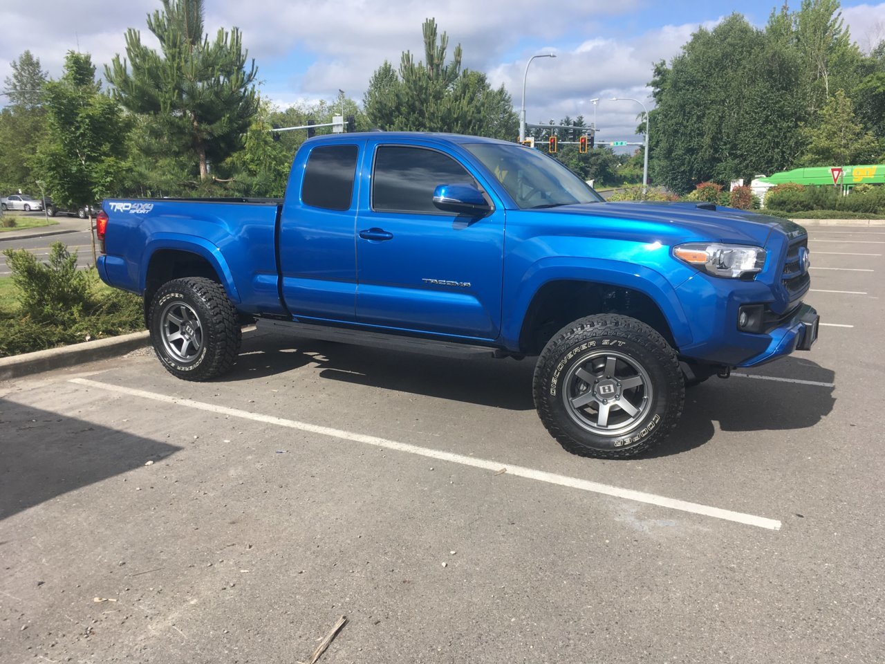

    Here are 265/70 17's with the 3/2 ReadyLift kit if you wanted a picture for reference.
