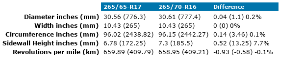

    The important part about swapping rims size is changing the side of the rubber too. You'll need a smaller sidewall aspect ratio (the second number) with the same width or a smaller width tread.
    Or you can get a bigger rim with a bigger tire...and then you might need to talk about leveling/lifting.

    To visualize Brunes statement:
    from the online tire size calculator
    Virtually the same size tire on different size rims.
