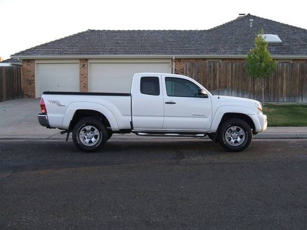

    AFE oil free drop in, Secondary removed, tint, front D-rings, Toyota bed mat, Undercover tonneau, TRD seat covers and floor mats, Pioneer speakers, Westin Platinum bars, Fumoto oil valve, short antena, Nifty Xtreme's, TSB leaf springs, Bilstein 5100's set at .85" in the front
    I just added the 5100's today. Set the front at .85". I got the TSB done 3-11-08 which only raised the rear approx. .75". Mine now measures from the ground through the center of the wheel to the bottom of the wheel well at 35.5" front and 37" rear. Slight rake look at 1.5" high in the rear which may settle some more. The 5100 set at .85" actually gave me exactly 1" of lift in the front. The ride is GREAT compared to the Toyota fleet HD Bilsteins. The ride is somewhat firmer but not harsh. I also needed another alignment after the 5100 install. I got on the loop after picking it up and really varied the speeds and didn't have any vibration or tracking issues.
