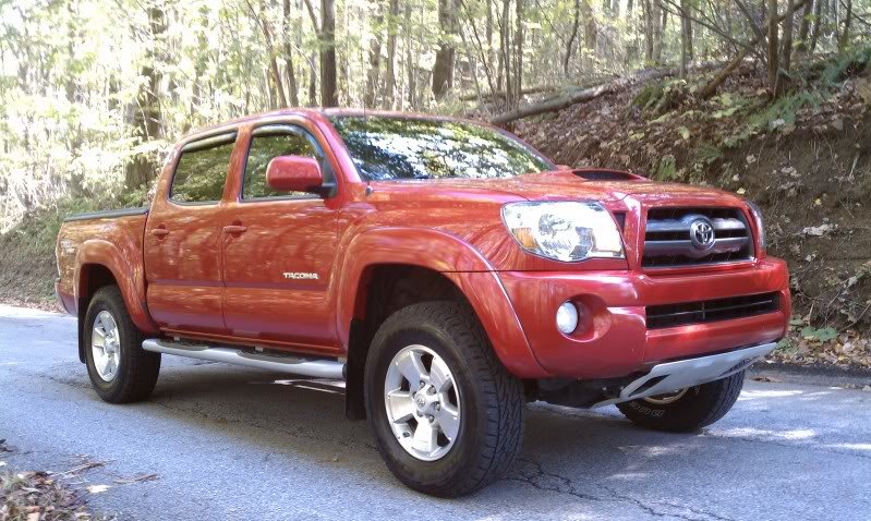

    any pics man?

  5. Mar 31, 2009 at 5:59 AM
    #25
    sbeau1960
    sbeau1960 Well-Known Member
    Mar 17, 2009
    #14832
    334
    Scott
    Indianapolis
    09 Tacoma Double Cab TRD Sport Pyrite Mica
