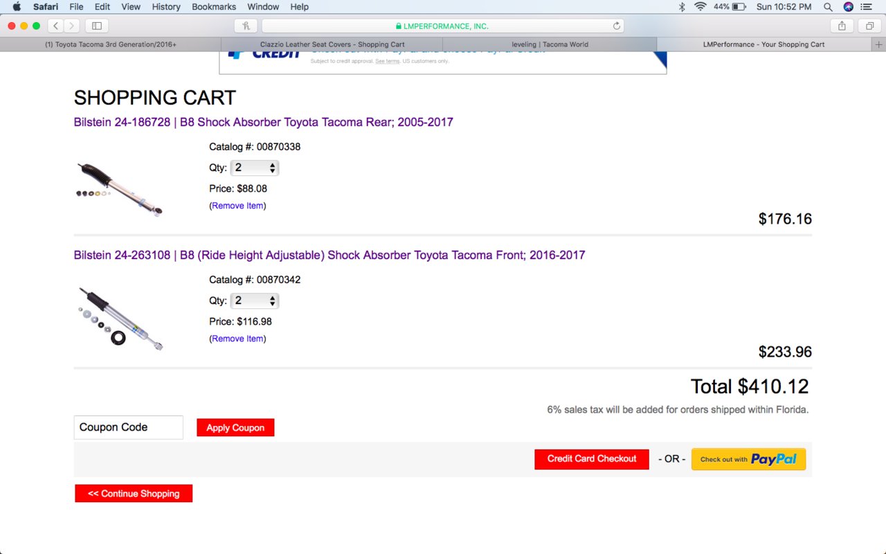

    couldn't I just swap the ome 4600 springs from my trd off road to the 5100's, and get these and forget about the aal I don't want to be higher in the rear just get it all leveled out.

  7. May 20, 2018 at 8:09 PM
    CaptainBart45
    CaptainBart45 Well-Known Member
    Sep 22, 2017
    #230761
    4,031
    Bart
    2017 Tacoma Sport 4x4
    Work in progress...
    Yep, you can go that route for sure. You will have to install the front shocks in the coils or have them installed. You will also have to get an alignment after the install. I was saying, the 3 leaf add a leaf, for the rear, is $160.00ish and the front springs are $175.oo ish. You are doing some work to install or paying for it. My total was $909.09 and the alignment was 80 bucks in the town I am lucky enough to live in. So, do your research and all. I am telling you about the option I went with.
