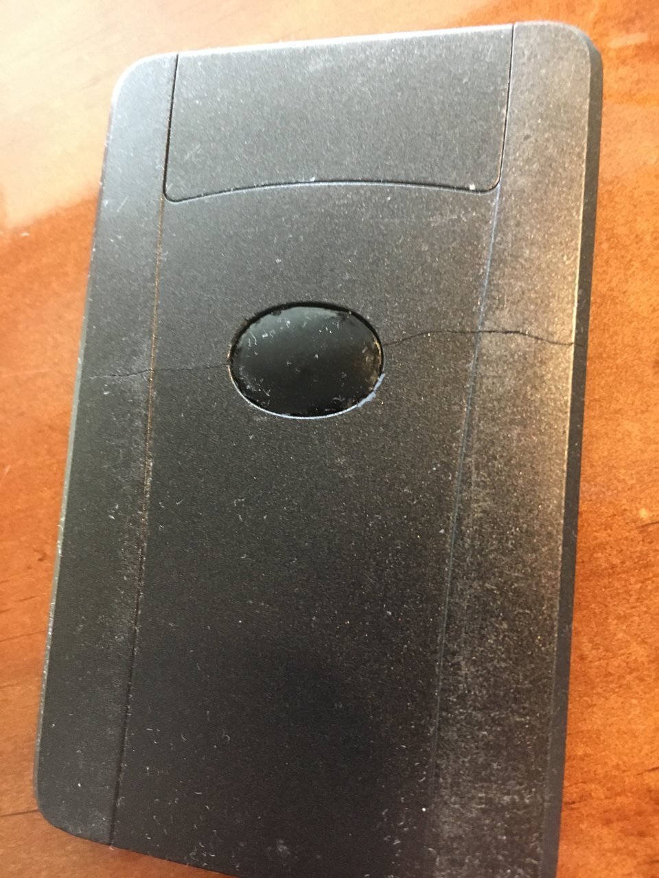

    So I had to replace my credit card key. I was able to break my old one.
    DumDum me left my phone and wallet in my pockets as we boatded up our windows for Hurricane Irma. I must have put the hammer drill against my thigh for leverage and broke the key and my iPhone screen.
    I wrapped tape around the key lengthwise to hold it together and it worked for about a month, but then only worked sometimes.
    My brand new key came with a low battery though, it may be worth buying a battery when you buy the key. These must sit on the shelf for a while.IMG_3812.jpg
