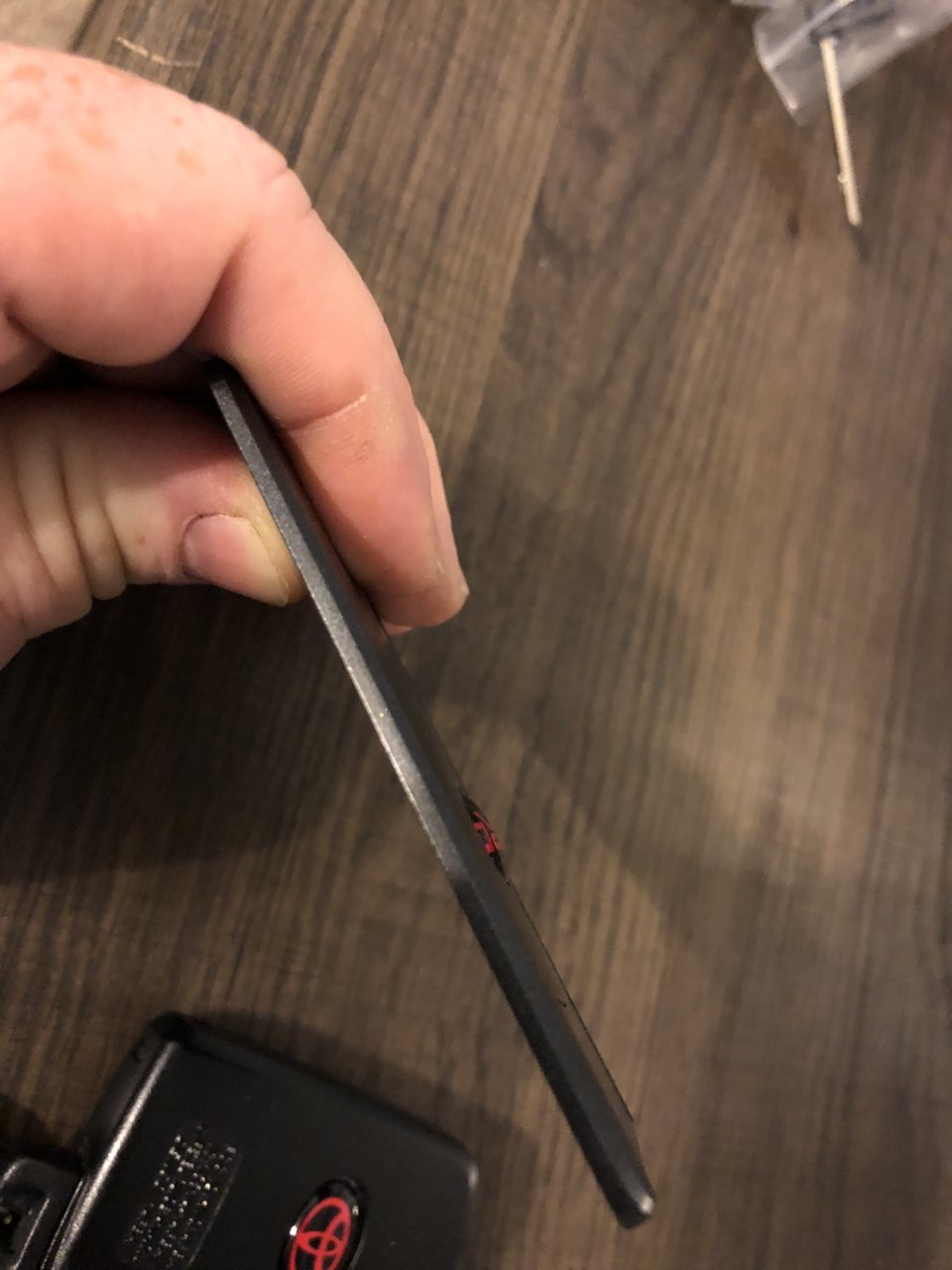

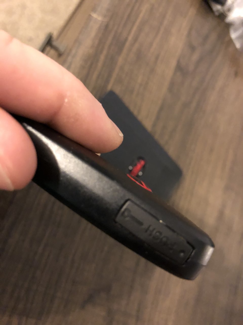

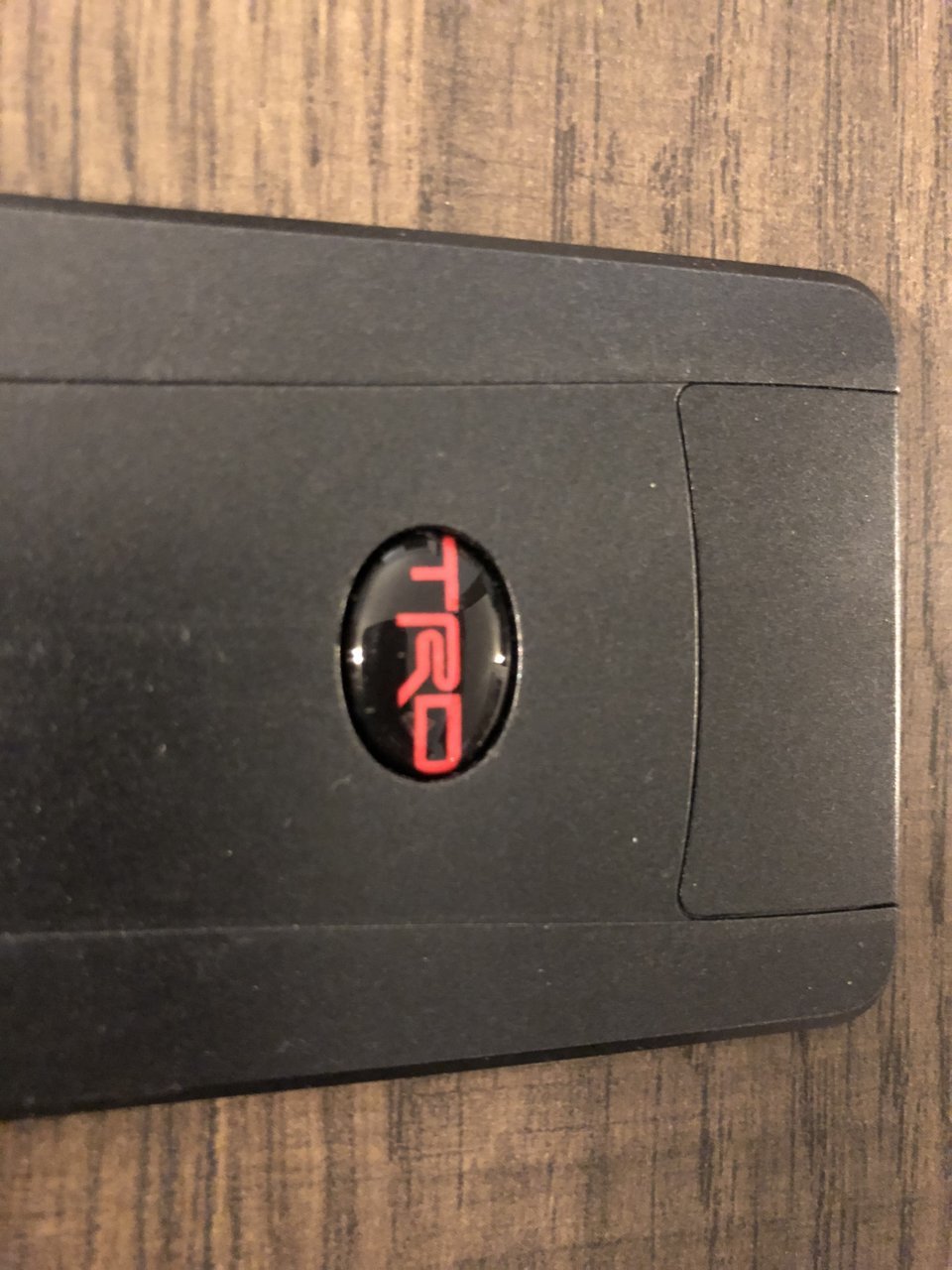

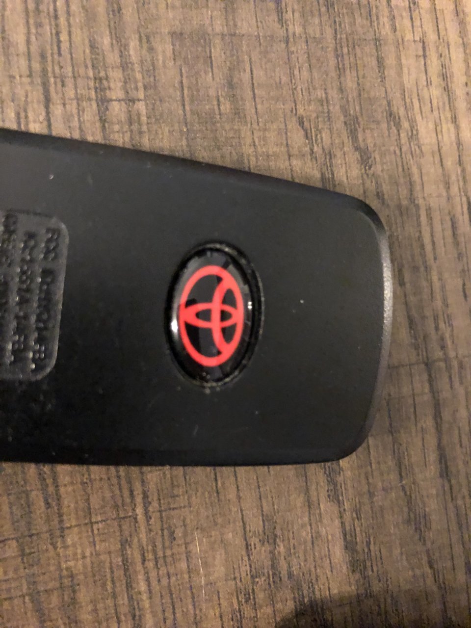

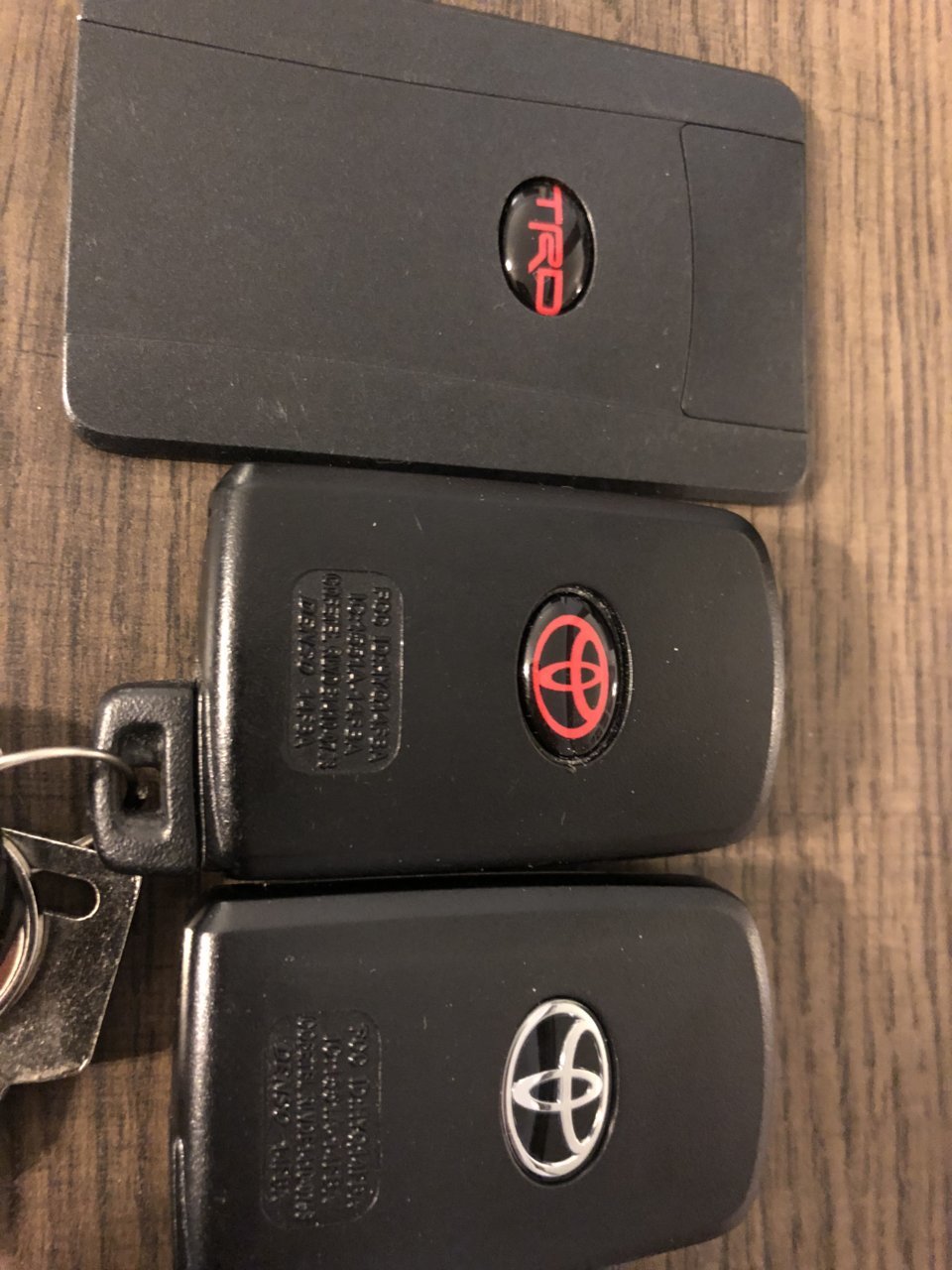

    I got mine from CBoy after seeing these. Happy to find out it is an actual domed sticker that replaced the original domed emblem, not some thin vinyl that you put over the original domed emblem.
    For anyone interested he @CBoy808 sells these for $6 shipped. He said he only has red but has the factory T logo and TRD logo.

    Got my key card working and key blank cut. Thanks to @Victory for all his hard work and great instructions that made it possible.
    Love the finishing touch by @CBoy808.
