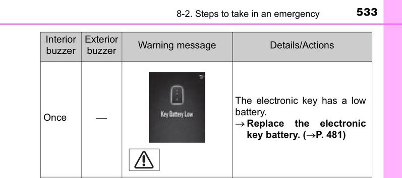

    What's the battery life of the card?
  14. Aug 16, 2016 at 8:42 AM
    #34
    Victory
    Victory [OP] Well-Known Member
    Mar 13, 2016
    #181167
    1,048
    St. Pete, FL
    2016 White Tacoma TRD Off Road
    That is a good question I hadn't thought much about. I assumed it was the same as the fob we already have.
    The battery in our fobs is a CR2032, a 3Volt battery with 220mAh capacity.
    The battery in the wallet card is a CR2412 with just a 100mAh capacity.
    It seems like the card battery wouldn't last as long, but the card does not have buttons(which have to work from much farther away) or an LED like the fob has, so may not need as much power.
    Lexus says the se thing for battery life for its Fobs and Cards; 1-2 year battery life. Our Tacoma owners manual also says 1-2 year battery life for the fob.
    If you are worried about the battery, you should plan on ordering the emergency key that fits in the card, and have some peace of mind knowing you can get in your truck with a dead battery, and the truck will start if you push the start button using the card or fob even with a dead battery.
    Also our trucks (and the Lexus) will warn us on our multifunction screen when our battery is getting low, before the battery dies, and you then know it is time to replace. I am not worried about it, I do have the emergency key in order though, but figure if I have to replace the battery a little more often it is still worth it for me.
