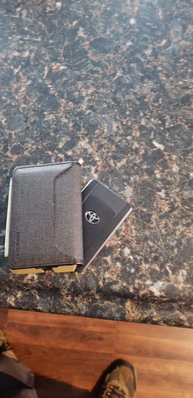

    Got it working reusing the token did work which was nice.
    I think where I screwed up before was in tech stream after a smart key reset I didnt use the smart key registration (classic).
    Classic has an option that says after blah blah or "smart key reset" worked perfectly.20190222_173034.jpg
