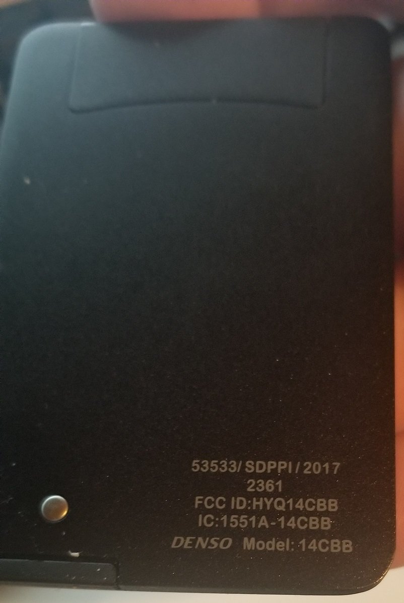

    Every link i click on that says part number 89904-53511 bring up a page for 89904-53512. I ordered one that said 89904-53511 and ended up receiving the newer 89904-53512 and decided to give it a try and can confirm that it does work on my 2017 Toyota Tacoma.

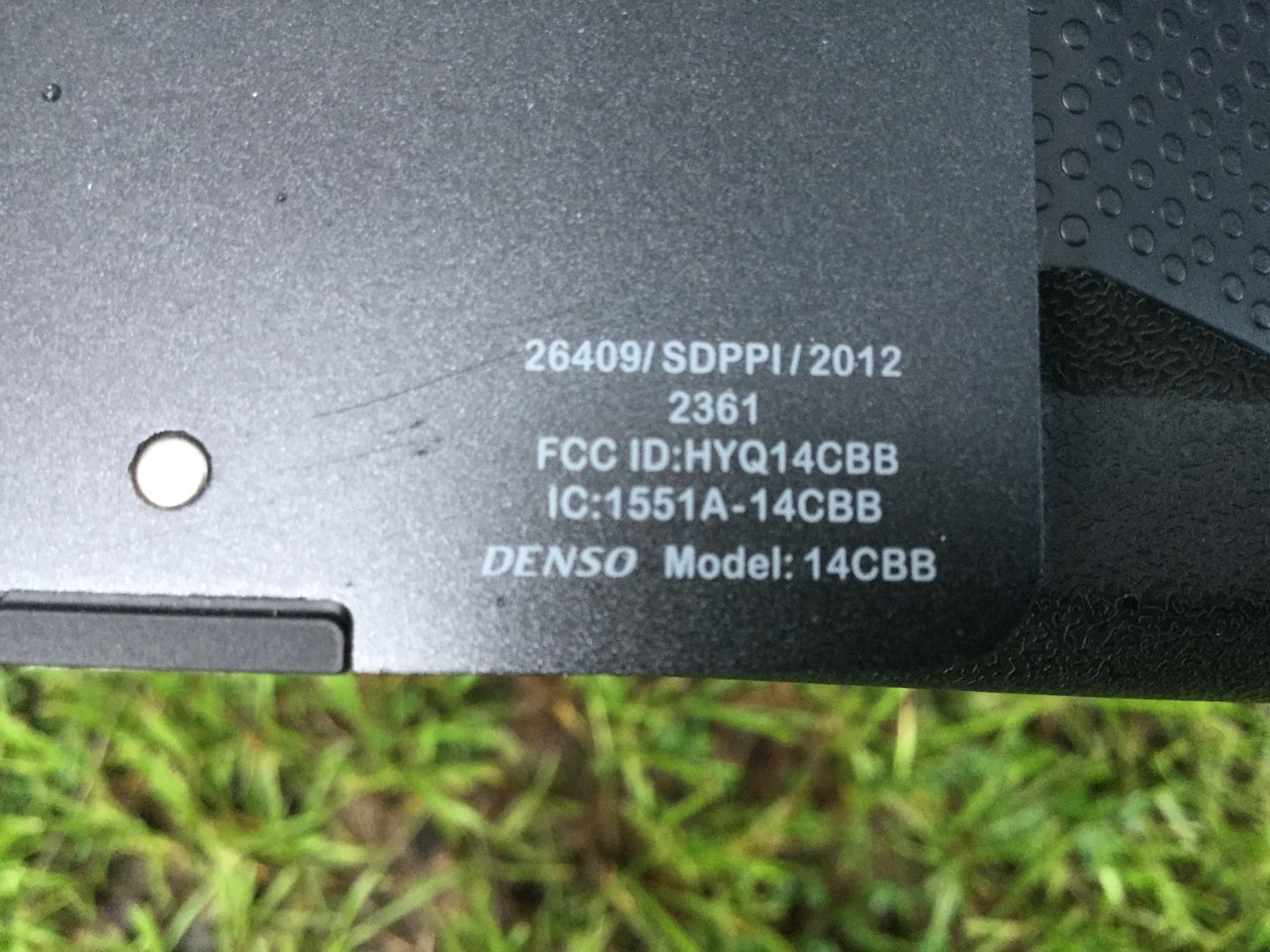

    You want to find a key fob that say's
    26409/ SDPPI / 2012
    2361
    FFC ID: HYQ14CBB
    IC: 1551A-14CBB
    DENSO Model: 14CBB
    Here a link below form eBay.
    https://www.ebay.com/itm/Lexus-RC35...RT-CARD-KEY-89904-53511-HYQ14CBB/132815162994

    This one worked for my 2017 Tacoma.
    It is:
    53533/SDPPI/2017
    2361
    FCC ID: HYQ14CBB
    IC: 1551A14CBB
    Denso Model: 14CBB
    most of it is the same but not quite and it works! this was part number 89904-53512. Also if you are ordering from a dealership parts website you are not going to see any of those numbers only the part number.

    It should work according to your picture you attached. Try to program it with Techstream.

    I already did and it DOES work I was just posting to let other people know!

    I bit the bullet and bought a used keycard on eBay to replace the one I stepped on. For what it's worth, I bought the same model that Mr_Alpha did on a the last page (53533/SDPPI/2017). Worked like a charm on my 2018.
