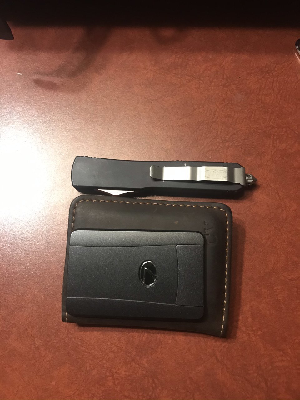

    #577
    ClassyTacos
    ClassyTacos National Treasure 3, Times a ticking Nickolas
    Sep 26, 2019
    #306325
    1,912
    Papalote
    Florida
    2017 TRD Sport 4x4
    Stockish
    Someone new joined the Fobuless crew. Fobless for a week and I love it. 264C39DF-4F23-41DF-ADAA-B27641FE9178.jpg
    cemented likes this.
  18. Nov 2, 2019 at 11:49 AM
    #578
    erok81
    erok81 Well-Known Member
    Aug 15, 2016
    #194699
    5,708
    Imposter
    I have that same knife. :cool:
    Oh and welcome to the club!
