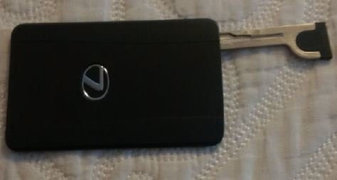

    I do have the emergency key in order, it fits into the card key, just like the emergency key in the current fob, so I will be able to get into the truck. I think this card is actually less susceptible to damage than our fobs because it will always be protected in our wallet, and not thrown around or dropped or otherwise moved and carried the way keys are, and it is made of metal and feels sturdier and harder to damage than my original fob.

    The Lexus emergency key slides into/ out of the inside of the Wallet Card Key through the bottom edge:image.jpg
