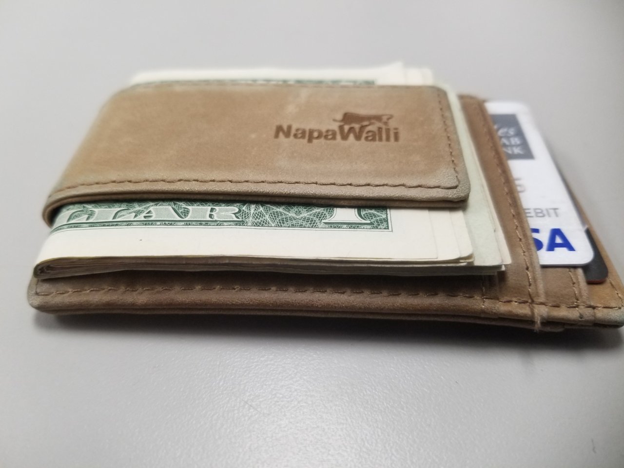

    When I first setup this smart key on my 2018 3rd gen Tacoma, I had no problems. Just walk up to the truck, grab the handle and voila, the doors unlock. Not so true in the last few days. I now have to take the smart key out and put it next to the door handle to get it to unlock the doors.
    I have put 4 different batteries into it. The original CR2412, a 2 pack of Panasonic CR2412 that I got from Amazon and a CR2016 that someone here said works also. I continue to have the same problem. I cannot unlock the truck with the fob in my wallet, in my pocket.
    Does anyone have any ideas as to what is going on? Victory (OP)?
    Edit: I may have figured it out myself. Since I am attempting to go keyless, I got one of these wallets to really minimize what I carry in my back pocket. I first just put the smart key in my pocket and the doors locked/unlocked as they should. Then I put the smart key in my old wallet and, again, the doors locked/unlocked as they should. I guess I'll have to go back to my old wallet. When I bought the minimal wallet, it never mentioned it had any RFID as others did so I figured it didn't. Maybe it does. Well, at least it's working now.20191119_060512.jpg
