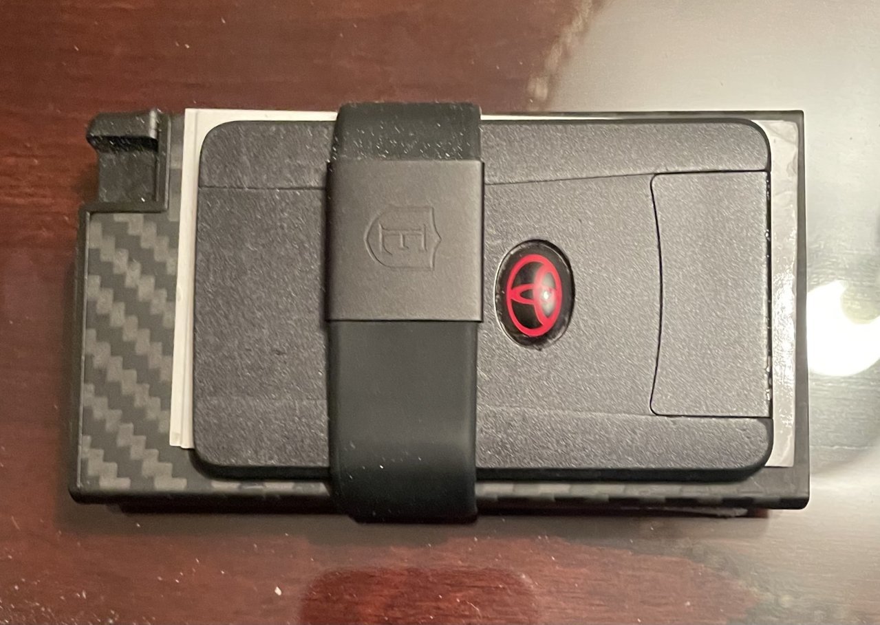

    maybe weird q but anyone have trouble keeping one in a back pocket wallet?
    I keep a slim wallet in my back pocket and sit on that but it never has more than a few cards/a little cash in it
  14. Jan 14, 2022 at 3:22 AM
    #674
    EagleUSMCRet
    EagleUSMCRet Well-Known Member
    Dec 6, 2015
    #171597
    585
    Gettysburg, PA
    2017 MGM 4x4 Tacoma DC Limited
    ESR Magnetic Mount MAGSafe charger for iPhone; AVS Vent Visors; Replaced Entune system with Kenwood Excelon Head unit, The Taco Garage DMM for Qi charger, Owl Dash Cam and Motorola GMRS; LED interior light upgrades, ARE Z Cap w/ Yakima Rack, Front Bed Rail, Bed Rug, Tuffy Bed Lock Box, Add a leaf, Pop and Lock, Blendmount and mirror tap for radar detector, AVS Hoodflector, Redline Hood Gas Spring mod. A/C drain mod, X2 Power Premium 27M battery, Debadged the tailgate, Compustar remote start, USB charger for the rear seats, Husky Mats, Lexus Credit Card Transponder Fob, MAG Light mount, twin Hella Sharptone horns, Bedslide, Gasshole, Meso Fuze cover, TRD Gas cap cover, Passenger side locking door handle, Mr. Produxn license place mount, Total Chaos Bed Stiffeners, Valley Runner Tune....help me I can't stop!!!
    This is what I do… Ekster Slim Wallet… I have two business cards between the CC FOB and the wallet. I carry it in my right front pocket… it carries 5 cards (2 CC’s, Drivers License, Mil ID, Laminated Medicare Card). I have a few bills in a money clip in a back pocket that I rarely use. With the pandemic, I’m almost cashless in my purchases. Hope this helps. C51E25C5-FA4D-4508-A148-A357E117E6B1.jpg

    My experience (on 2017)
    I keep my lexus key in the center of a slim wallet.
    If the wallet is in my back pocket, it can sometimes have a LITTLE trouble getting signal to unlock the door, and it might take another half second or require you to turn your body slightly to get the door unlocked. Not every time, but maybe 1 in 10, or 1 in 5. Not really an issue, but not utterly seamless.
    If the wallet is in my front pocket, I see no significant change from the full size normal key.
    (Never any issue with starting the truck, regardless of wallet or location on body.)
