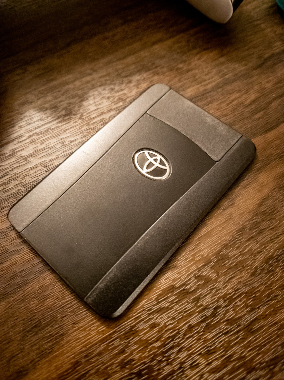

    I pried out the Lexus symbol and replaced with a same sized Toyota emblem from @cboy808… worked fine.

    This is the one I used for mine.
