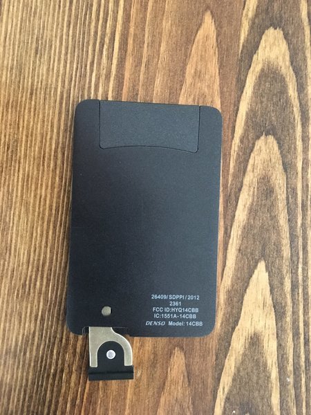

    Got my emergency key yesterday. As you can see it slides into the bottom of the cardimage.jpg
