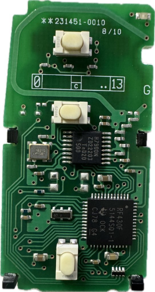

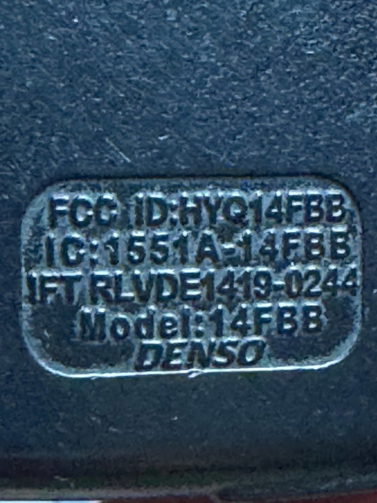

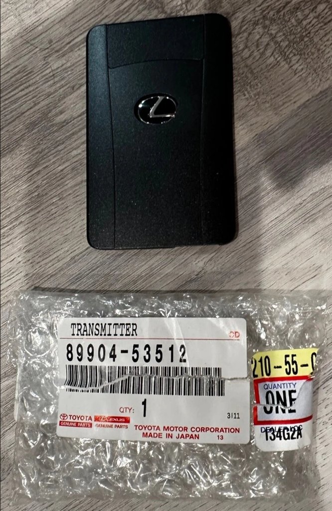

    Was unable to replicate on my 2021 TRD.
    My original key model is HYQ14FBB
    I used a brand new Lexus HYQ14CBB Card (89904-53512) with fresh battery.
    Techstream V18.00
    I attempted to program as several different Lexus models as well, but could never get the car to recognize the new key during programming.
    Just wanted to throw it out there to possibly same someone some time and money.
