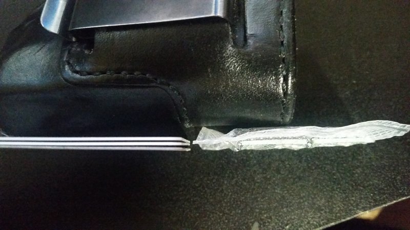

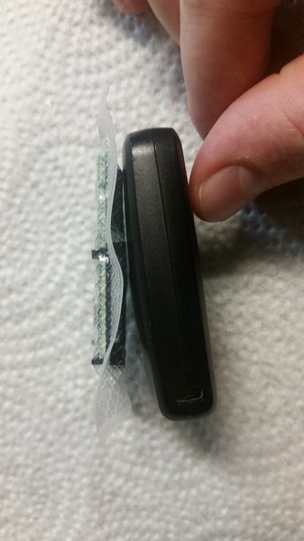

    Awesome job by the way. I was inspired by what you had accomplished but I am kinda a cheap ass...so i saved myself $250 and ended up opening my fob to see how big the internal components were. Had an awesome idea to use my food vacuum sealer and waterproof just the internal chip.
    Wasn't without a little error though. The little buttons compressed when sealed and was causing some issues so I used some tweezers and ripped them off, helped shrinken my form factor a little too. After all said and done not quite as nice as the lexus key but still easily slides into my wallet all while saving me some $$$.
    Still a little thicker than 3 credit cards but not by much. Anyways, thought I'd share cause I know there are other cheap asses out there too, and if y'all came up with any other ideas please post. Thanks again. :bowdown:
